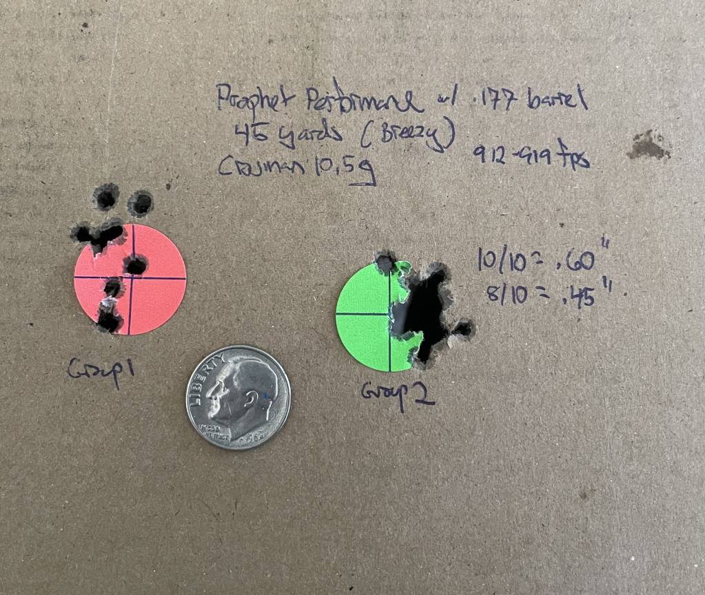

This is the 1st two groups shot with the .177 barrel. I chronoed it and surprisingly, It shoots the Crosman 10.5g at almost EXACTLY the same speed as the JSB 18.13s (of course the transfer port in the .177 barrel is smaller than the transfer port in the .22 LR barrel). The speed is 912-919 fps.
Group 1 I was still making scope adjustments during the 10 shots. Group 2 I made no scope adjustments. Holy Smokes - why bother with JSB .177 pellets?! This is exactly what I hoped for - it shoots cheap (real cheap in this case) .177 pellets very accurately at 45 yards and I don’t have to re-tune the rifle when swapping barrels - AWESOME !!
