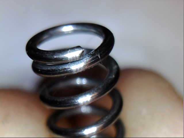

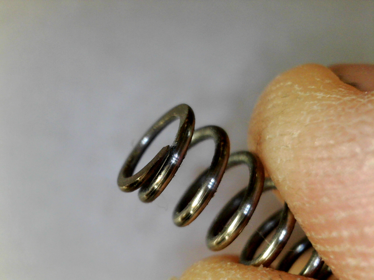

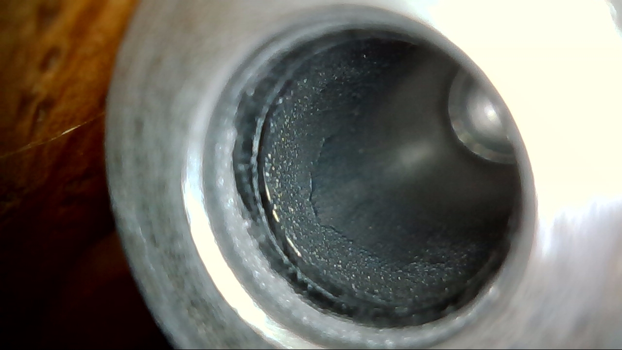

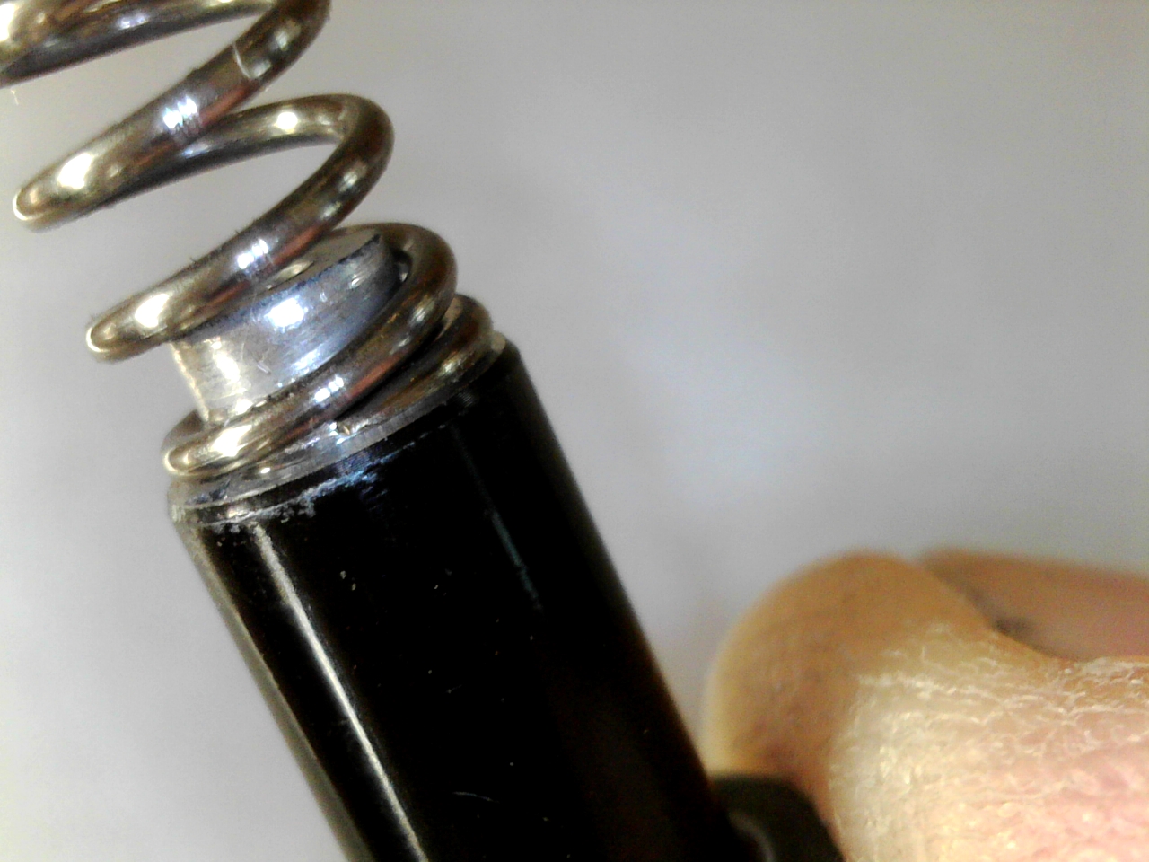

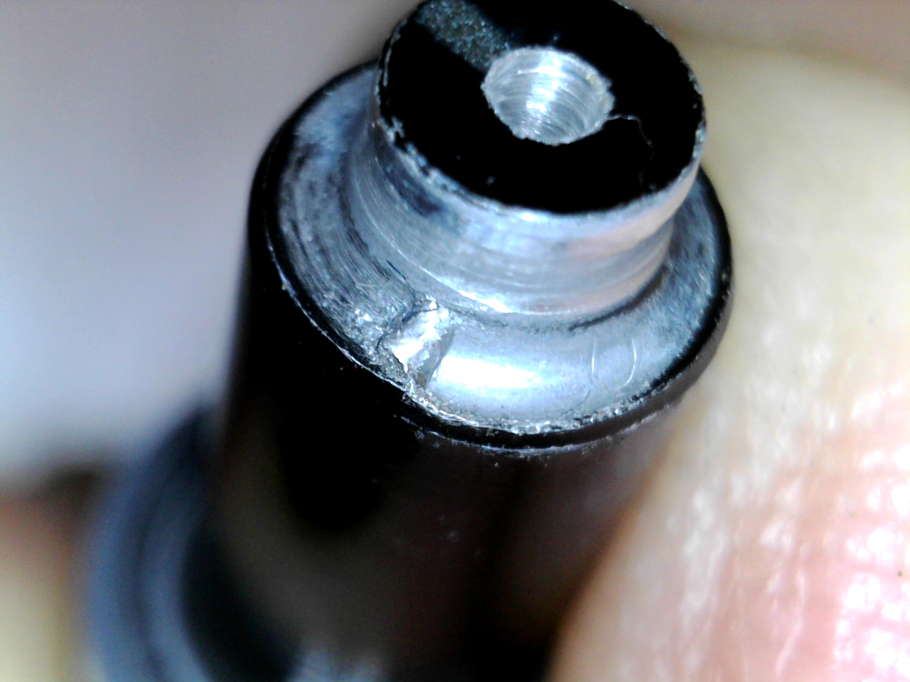

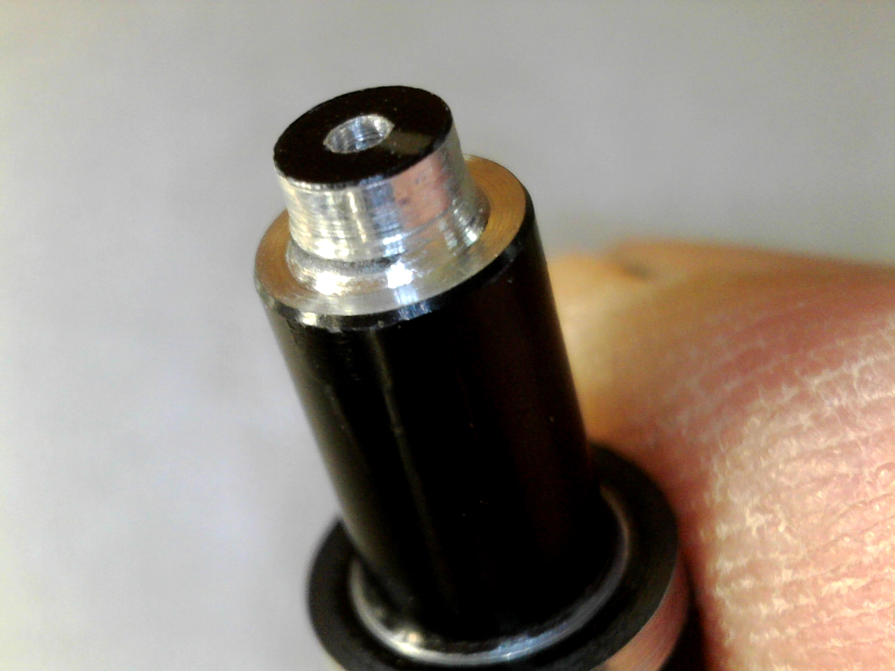

My P2 has never had good speed consistency but recently its got much worse and hit 30FPS spread yesterday. Reg did have bad creep but its now fixed and is not the problem. Set to 156 Bar. The gun has been apart many times but I have never had the valve out until yesterday. Here is what I found.
The spring inside the balance tube had worn itself a trench in the valve end and the aluminum debris had got behind the O ring. Not rocket science that a sharp hardened spring end will ware away aluminum.
I have cleaned up the valve end in a lathe and ground flats on the spring ends. Its probably removed about 0.5mm from the length. Probably not critical.
Not tested yet.
I see that there are at least 2 new valve types after the one I have. I wish RTI (or manufactures in general) would keep owners up to date with issues and mods. They would get huge respect from the community.

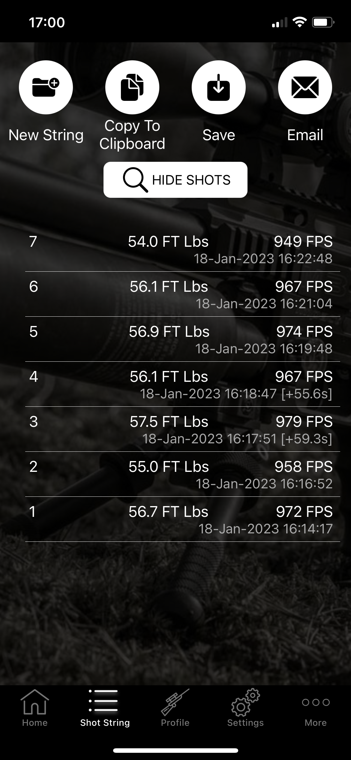

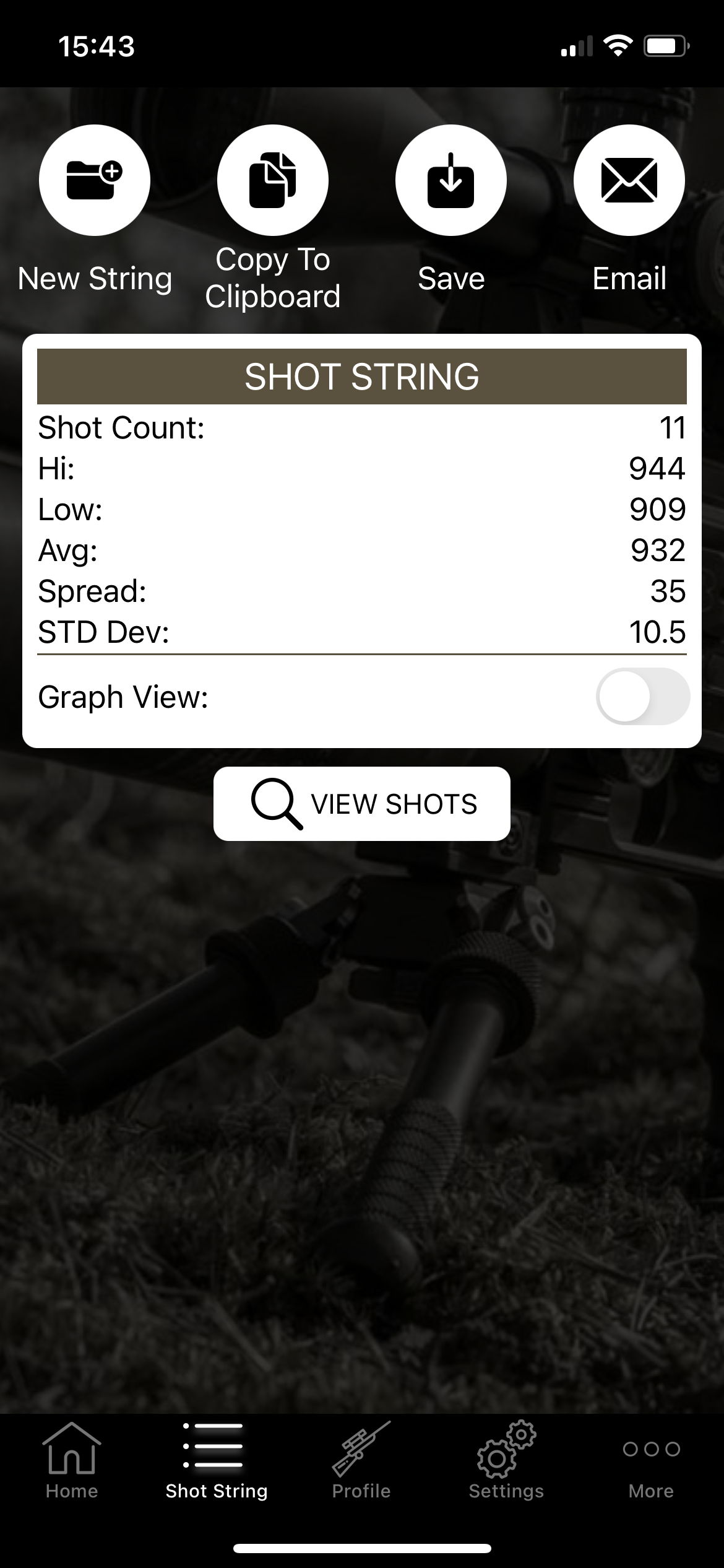

Id love to report everything is perfect after reassemble and test however its not clear as usual.........
Reg has stayed the same pressure at 156 Bar. Before fix this gave a speed with 27g (22 slugs) of 960 (but terrible spread).
After the above issues 'fixed' the initial speeds were around 1010 and very consistent, however after about 30 shots they reduced back to 960 but with better (not great) spread of about 15fps. Perhaps it was the thin silicone lube getting blown out. Dont really know.
It would be good to know if any P2 owners are getting good/acceptable speed spreads. Please comment.
I must admit to being a bit concerned that the spring tension has very little affect other than enough or not enough. Its all entirely plenum pressure dependent.
Would be happy to hear from (independant) happy P2 owners to convince me it all can work well with good consistent speeds and good groups.
I guessing the lube balanced out or there was some in the vent hole. The vent hole in the valve is how they regulate the valve dwell timing. Also, I’ve noticed that the hammer spring adjustment can make standard deviation differences with small amounts of adjustments. Now beware, There is a point where you can adjust it to low. What will happen it will be shooting great and next shoot will be obviously low like 660fps. Literally falling off a cliff. Bumping the hammer back doesn’t jump the speed back. For what ever reason you’ll have to put a half on the adjuster to get back to the 950’s.
