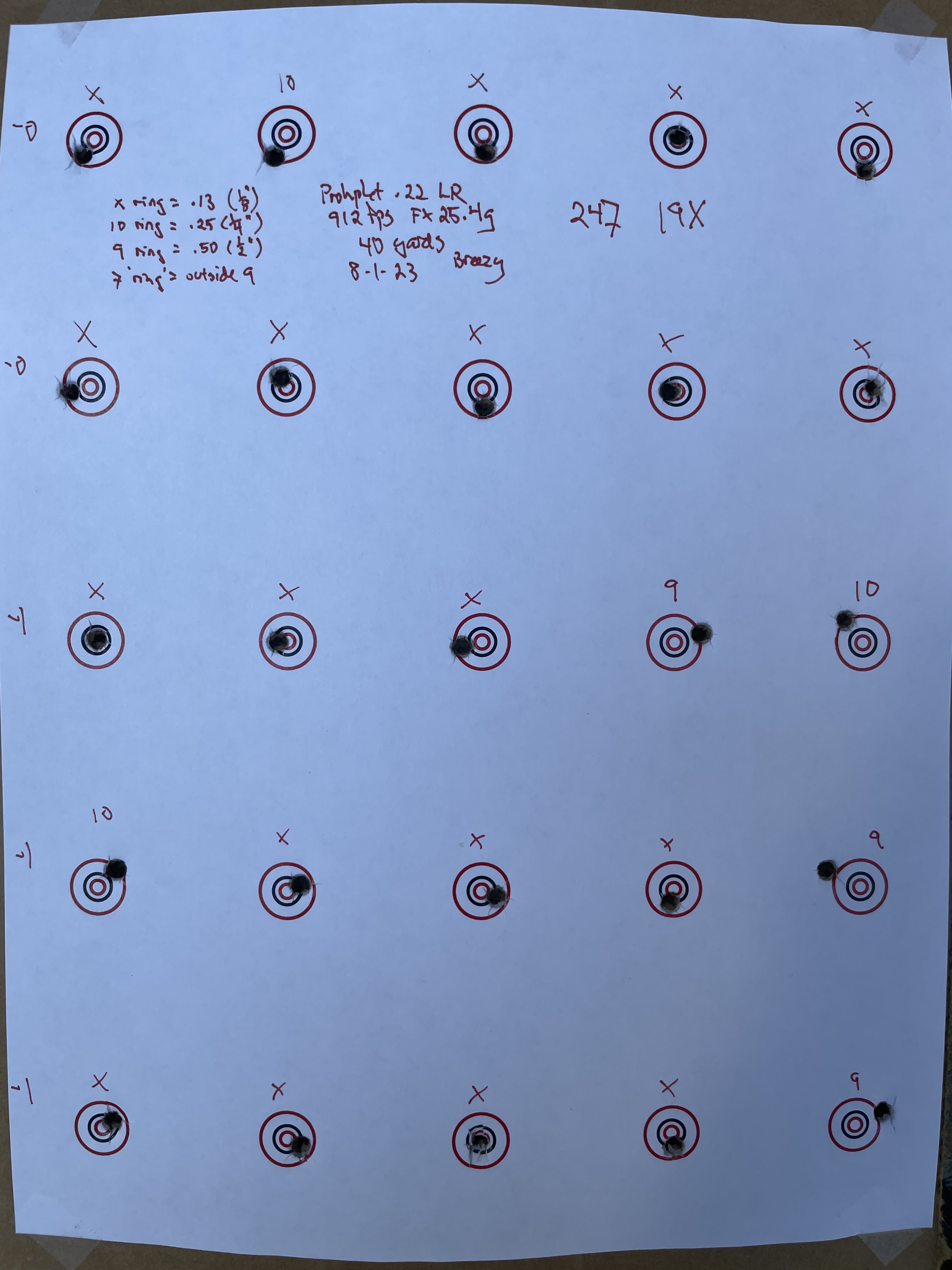

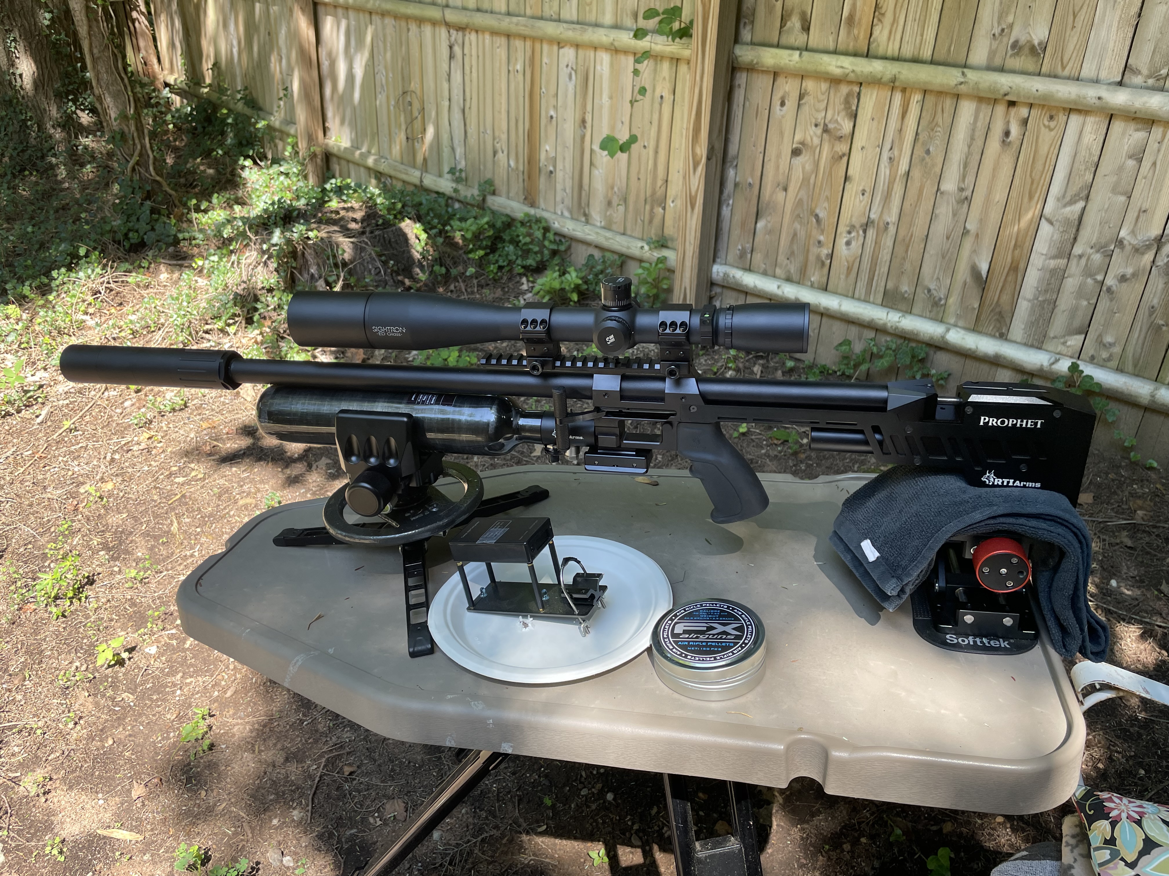

I know that you guys are interested in the performance of the .22 RPB (faster twist slug) barrel with the MRDs…
…but I thought I’d share this result I got yesterday shooting MRDs from the .22 LR (1:32 twist) barrel at 912-915 fps.
First time I tried the PP V1 at my 40 Yard Challenge target I made up - shot a new personal best 247 19X - pretty exciting.
I know the LR barrel will keep the MRDs stable at over 1,000 fps, but I’m liking the “shootability” of my 915fps tune - reg at about 120 bar (perhaps 118).
-Ed
