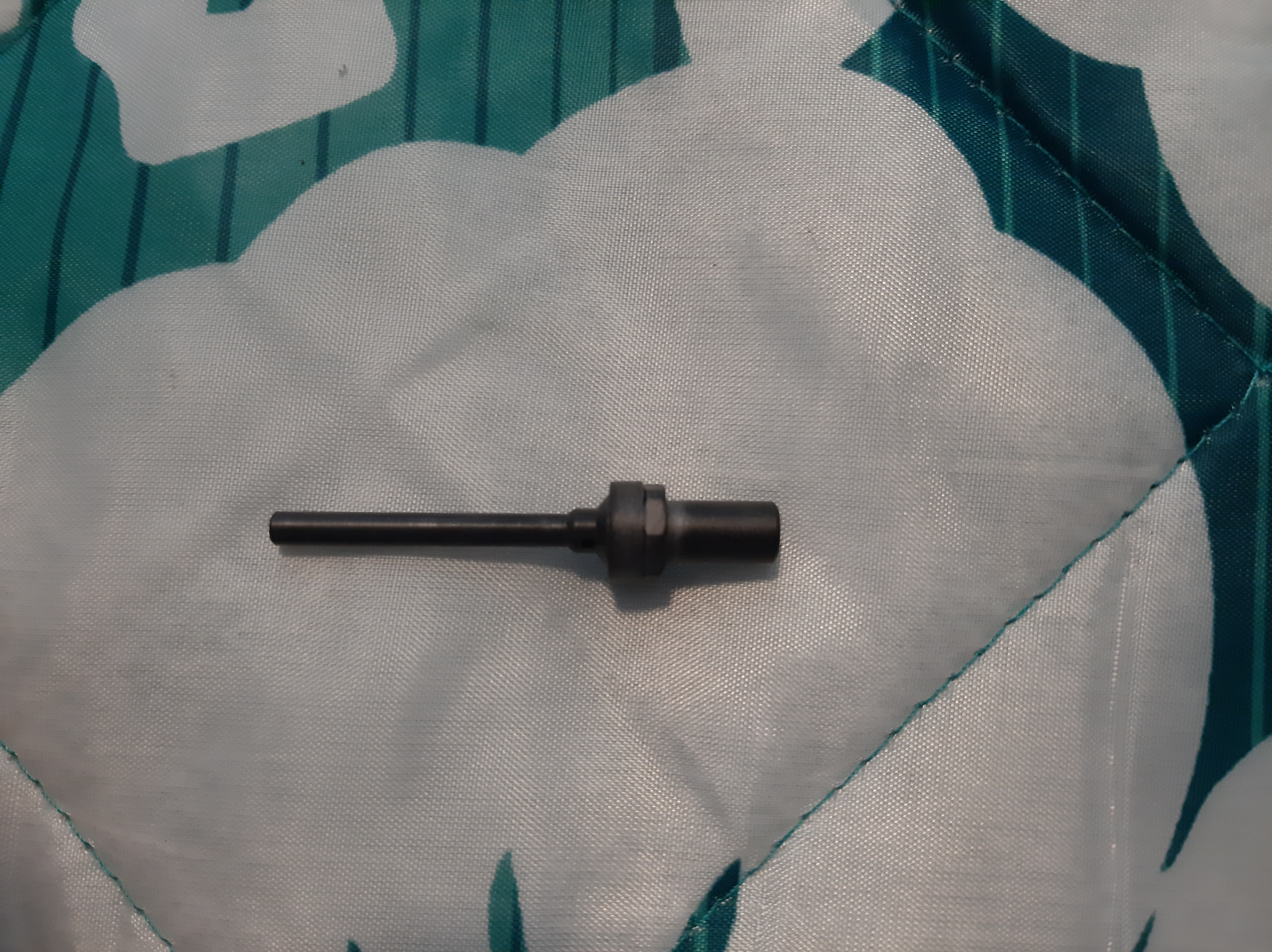

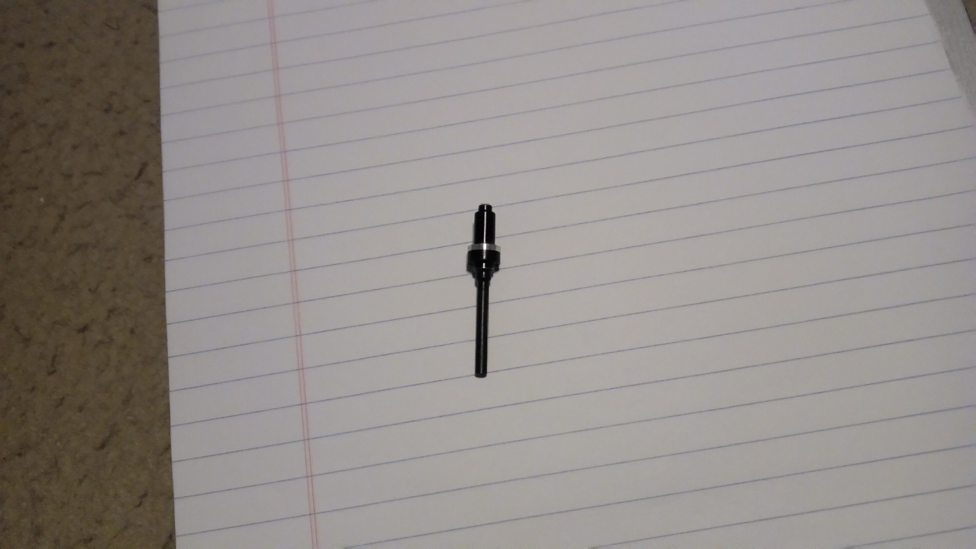

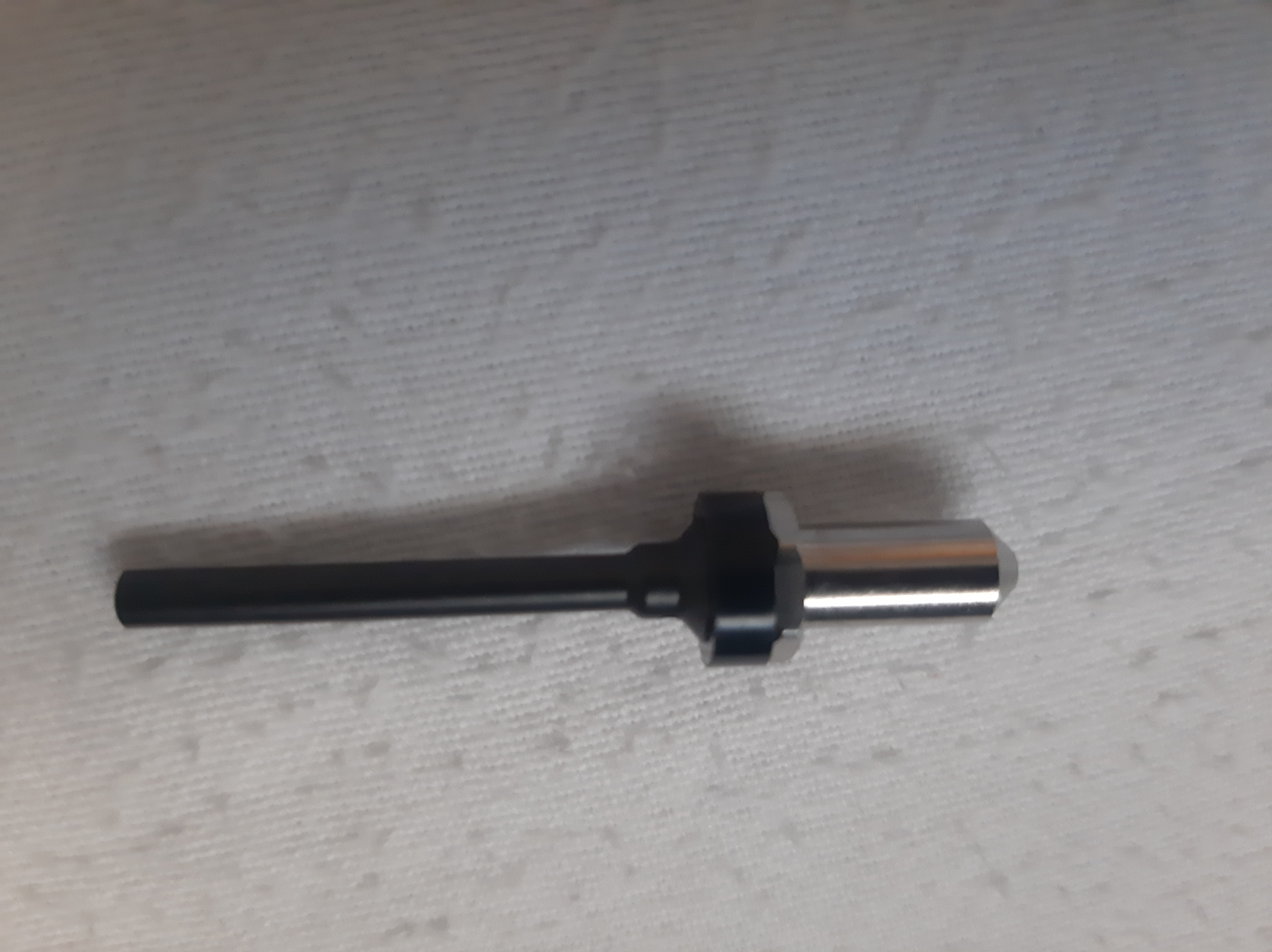

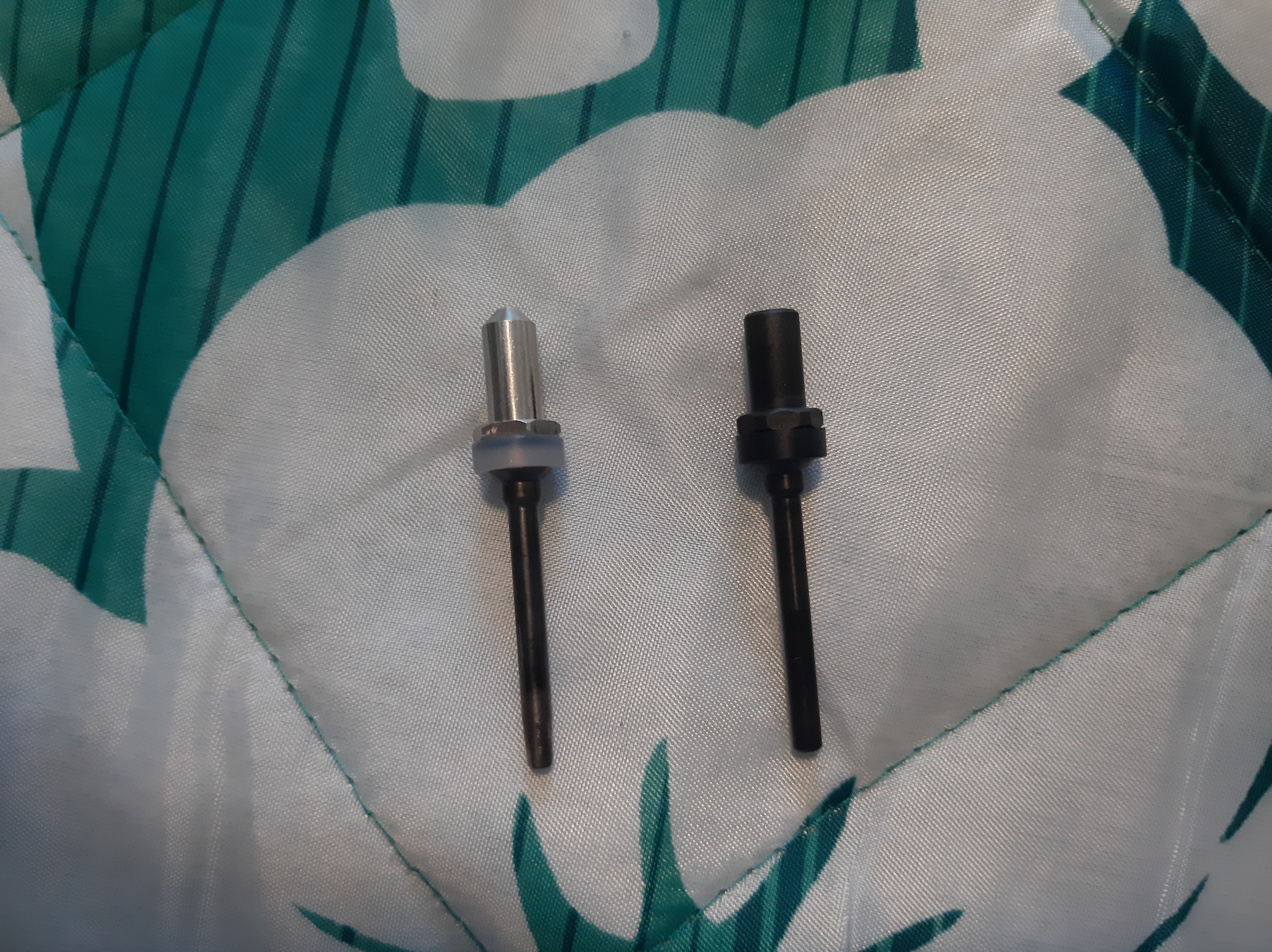

Here is the valve I just removed.
How about a photo of the one you replaced it with? That removed valve looks nothing like the valve I have in my Prophet 2 that was purchased last fall and failed this week.
I think I figured it out. Scrolled back and saw the photo of the old valve. That is what mine looks like. The O-Rings were chewed up a bit. Replaced both O-rings in the old valve, still leaks, even faster.
Your photo of the original valve looks like the one I have.

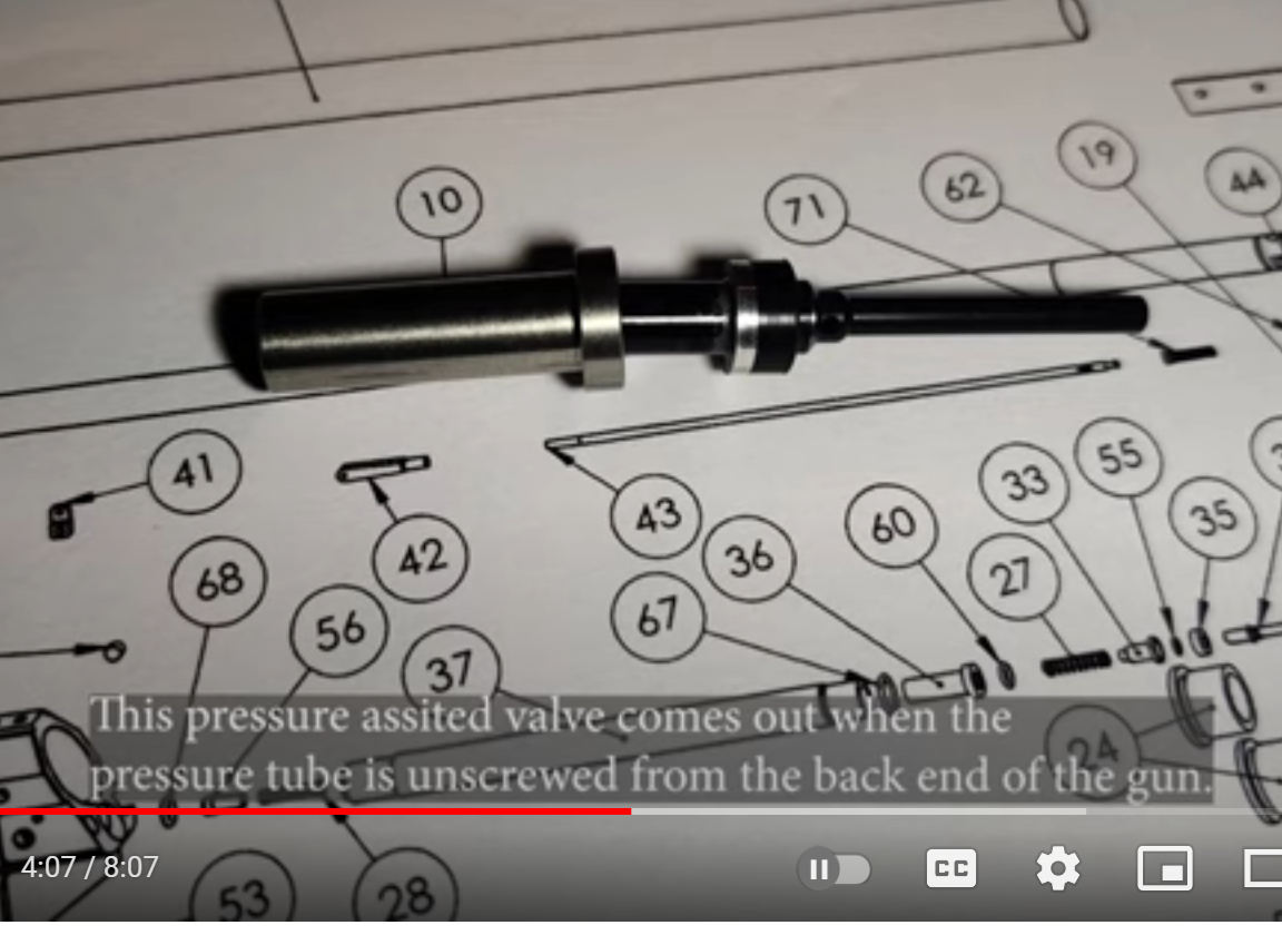

Does the latest valve use the same or a similar steel part as seen on the left in this screen capture from this YouTube video by AirgunNL? The O-Ring in mine (part on the left) was bad and very difficult to remove. I only had one each on hand that fit and would like to get more of both O-rings used in both assemblies. What is the correct size for both O-Rings?
