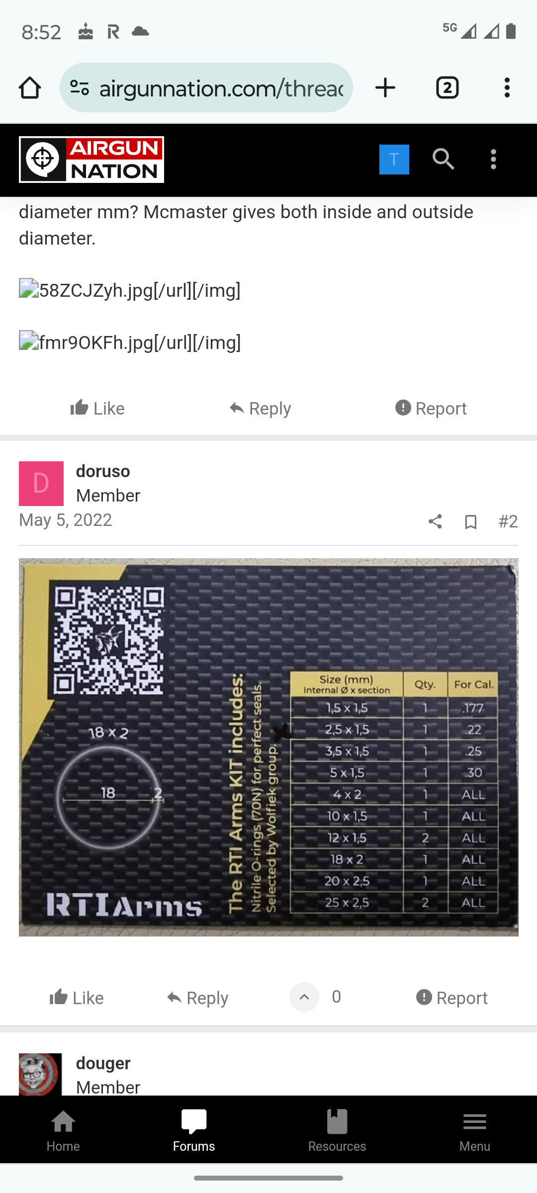

Anyone knows the probe o-ring size of RTI prophet 2 cal 6.35? Thanks in advance.
B Bimhiq Member Jun 14, 2020 190 54 Centra java, Indonesia Apr 17, 2024 Add bookmark #1 Apr 17, 2024 Add bookmark #1 Anyone knows the probe o-ring size of RTI prophet 2 cal 6.35? Thanks in advance.
D Deleted member 33063 Guest Apr 17, 2024 Add bookmark #2 Apr 17, 2024 Add bookmark #2 3,5x1,5 nbr70 but i would upgrade to nbr90 Reactions: JungleShooter and manabeknives Upvote 0
