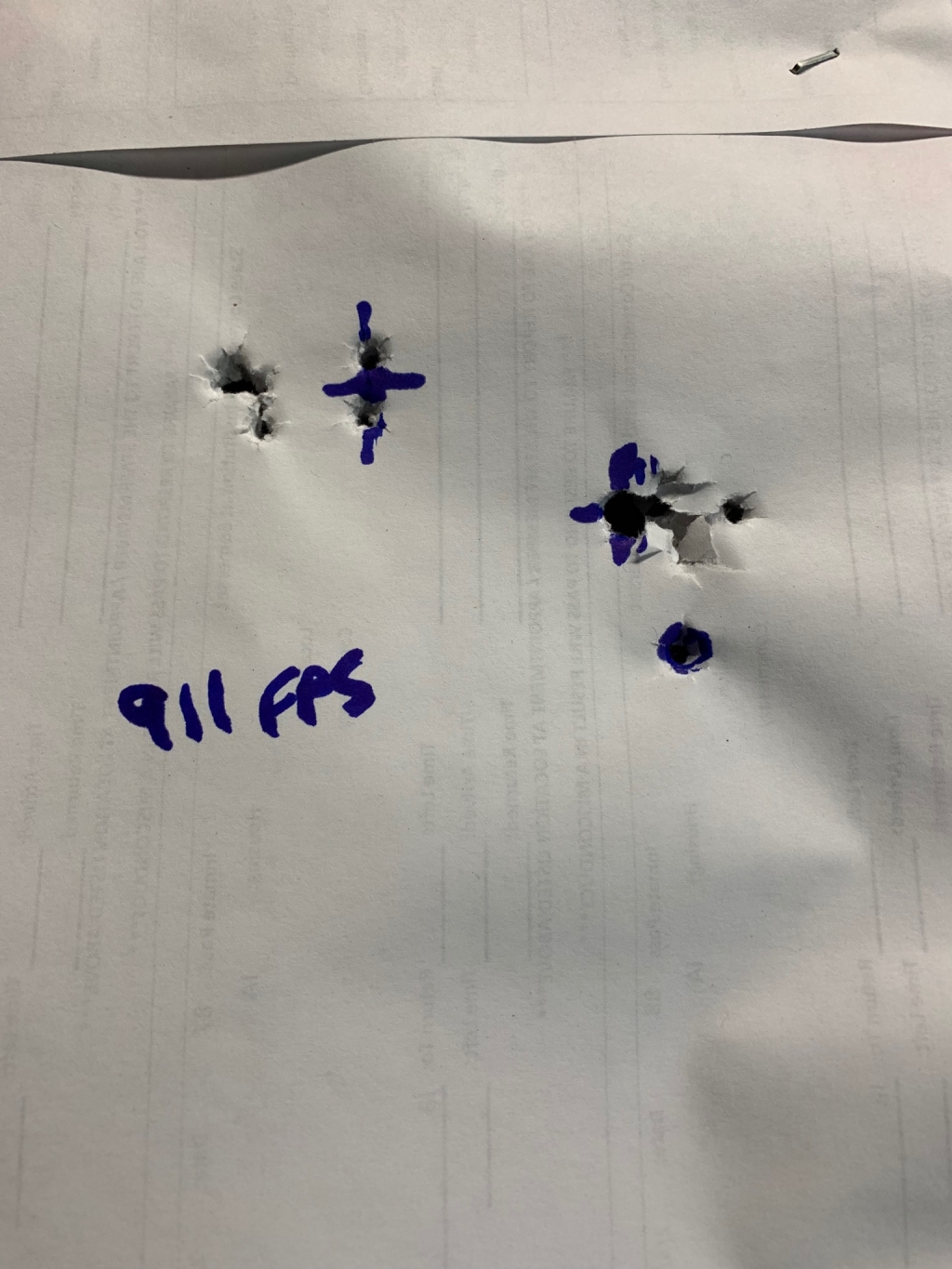

I was shooting tonight at 50 and 100yrds. I wasn’t completely thrilled with the guns groups. They were never one ragged hole at 35 and 50 so at 100 it would put some in and then wonder around. I switched back to 33gr pellets and things were just a little more consistent. Shot some 20gr pellets and it was bad. Decided to back the gun down from around 940fps to 911fps. Big big difference. The gun was too hot. The blue crosses were my aiming points. I was aiming between the 2 holes on the left and for the prominent hole on the right. I forgot my orange stickies when I walked out to 100 but had a sharpie. They are both 5 shot groups. The one on the left was above 150b. I clicked my scope a little too far for the group on the right and was dangerously close to dropping off the reg. The moral of this story is if your gun isn’t shooting as good as you think it should, back it down. I don’t have an adjustable spring so I just spaced the butt plate 2.85mm.
Vetmx, That is impressive! I have a sneaking suspicion that I may have to tune mine down also as Gregor was getting around 35 fpe out of the .22, which would put most of the lighter pellets shooting pretty hot. I ordered a tin of 15.89 jsb hades and a tin of jsb 18.13's with the gun, so we shall see what happens. I also ordered the marauder gen 2 baffles. I may have to seek your advice on turning the gun down if I run into the same issues you had. But definitely nice shooting! It is quite assuring.
The reg does creep after the gun sits but not real bad. I went over the gun scrutinizing everything. I pushed pellets through the barrel to see if I had a leade or crown issue. The only thing that’s left is pellets. I opened a new tin for this gun so maybe it’s a bad tin. I ordered more but when I get a chance I am going to weigh and check the ones left in that tin. I will say when I pushed pellets down the barrel, this gun has a fairly long tight choke. The pellets showed definitive rifling on the head and skirt.
I had no time for airguns over the last week. I did get new pellets and sorted some. They had the same spread in weight as the batch I was shooting. I am going to have a go with the gun next week and try to get it dialed in. Hopefully you get yours soon. I also had to build a baffle out of Delrin on my lathe. The first Marauder baffle had the cone blown off when I took the gun apart. I had 2 shots that I experienced blowback around the pellet probe. Its happened about 5 times since I owned the gun and its loud and right by your ear. When that happens, the pellet never even hits the target. Not sure if that or just the muzzle blast and cheap plastic caused the baffle damage. The Delrin one I made is stout and shouldn't fail if it was just air causing it. I took the side plate off the gun and cleaned then lubed the block that locks the pellet probe forward. I haven't experienced the ear blasting blowback since.
