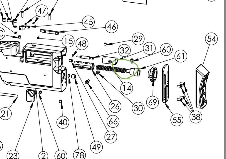

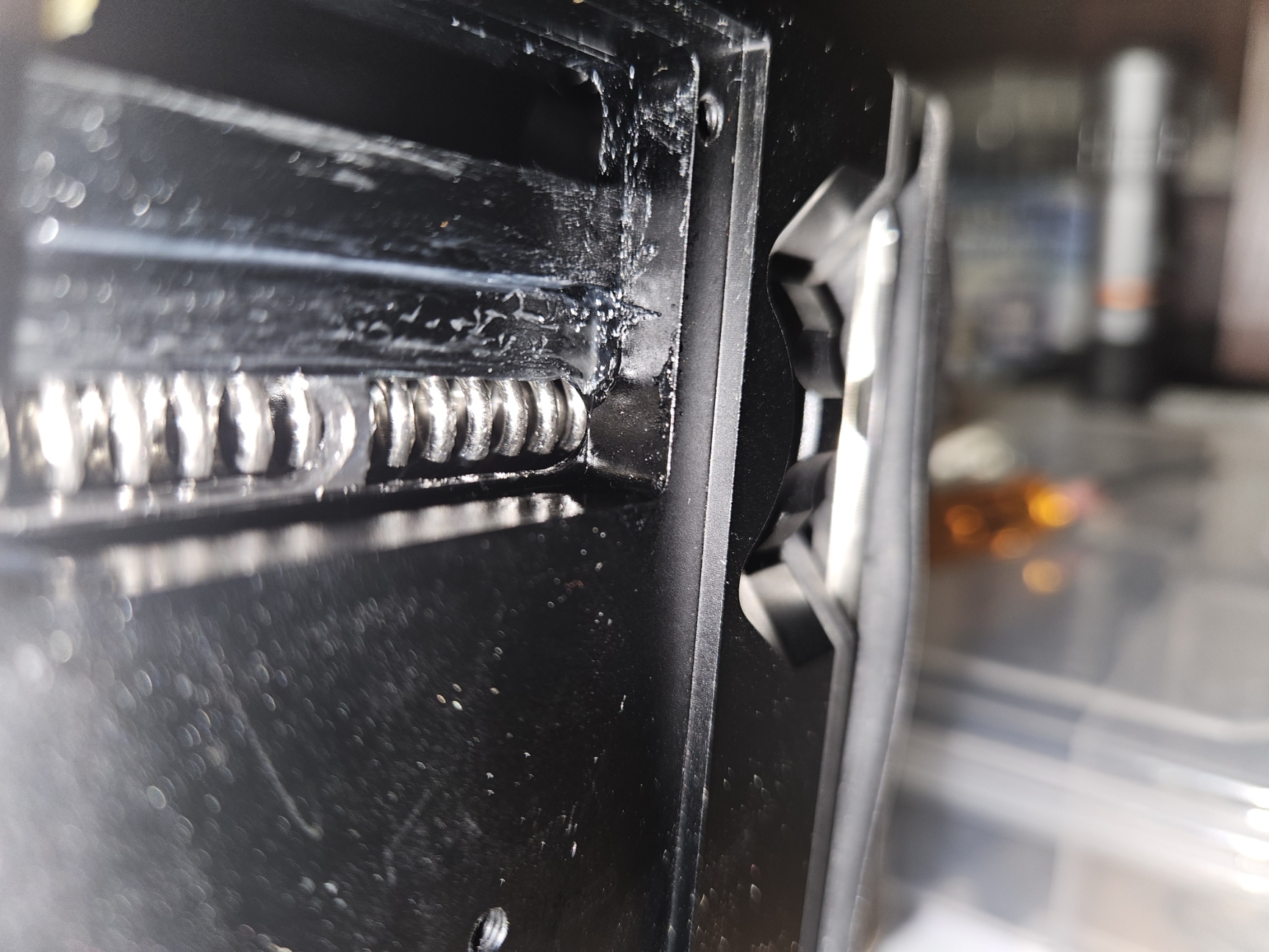

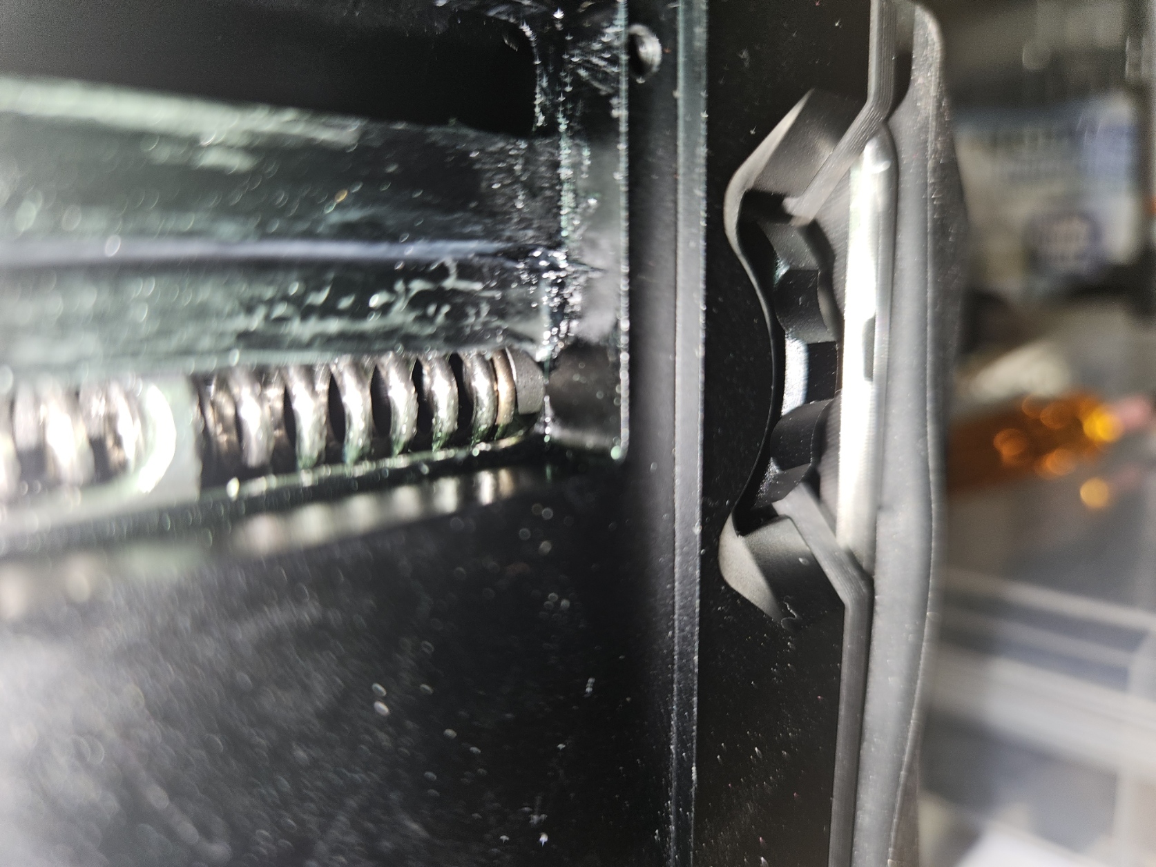

Also, if you had your reg at 180 bar and HS tension at the minimum the valve should be valve locking at the projectile flopping out the end of the barrel sub 500 FPS. Check and see if the spring is setting down on the pin on the tensioner (part #61 in the above pic). You can see it if you take the cheek piece and left cover off. I think this is the same thing Simi was talking about.
You can see in the left pic my hammer spring was sitting on that pin which caused way to much HS tension. I fixed it in the 2nd pic by grabbing the spring with needle nose pliers and popping it back onto the tensioner pin.
