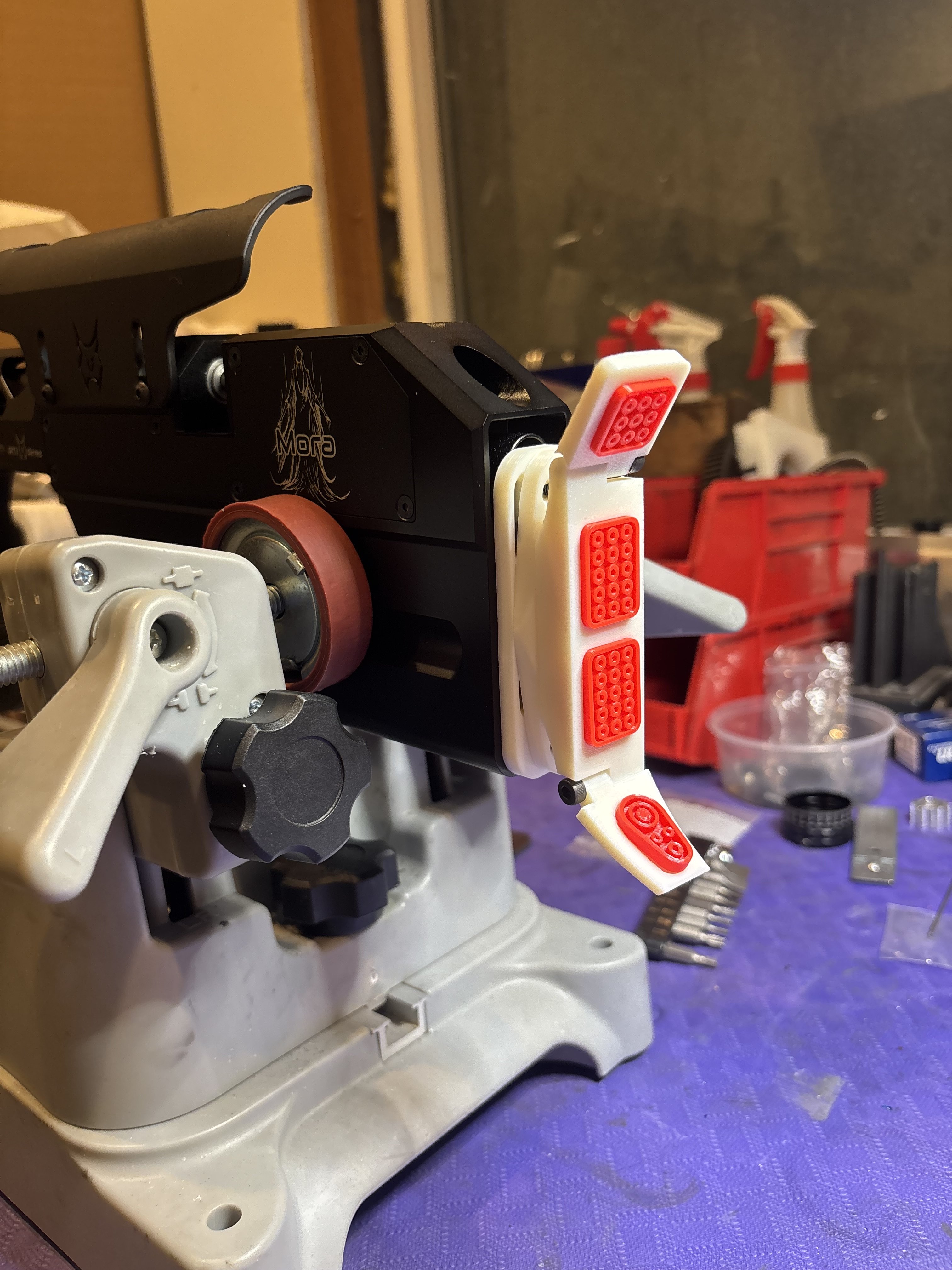

As I read this thread, I think this would address one of the key points of contention. I wonder, should I focus this project? Here’s a picture of a prototype adjustable shoulder pad for the Mora.
I’ve been working with the idea for a couple of days. I found myself needing a break from my Montster magazine projects. Taking a small break from magazine designing to work on this.
Now not to get crazy! It’s only white and red 3D printed because I use odd colors for prototypes to make identifying them quick and easy.
I've been thinking about designing something like that myself, seems pretty good from a glance. Let me know if you'd like a tester or someone to give their thoughts on it, I've got a 3d printer myself and some bolts/nuts. I'd be happy to help
