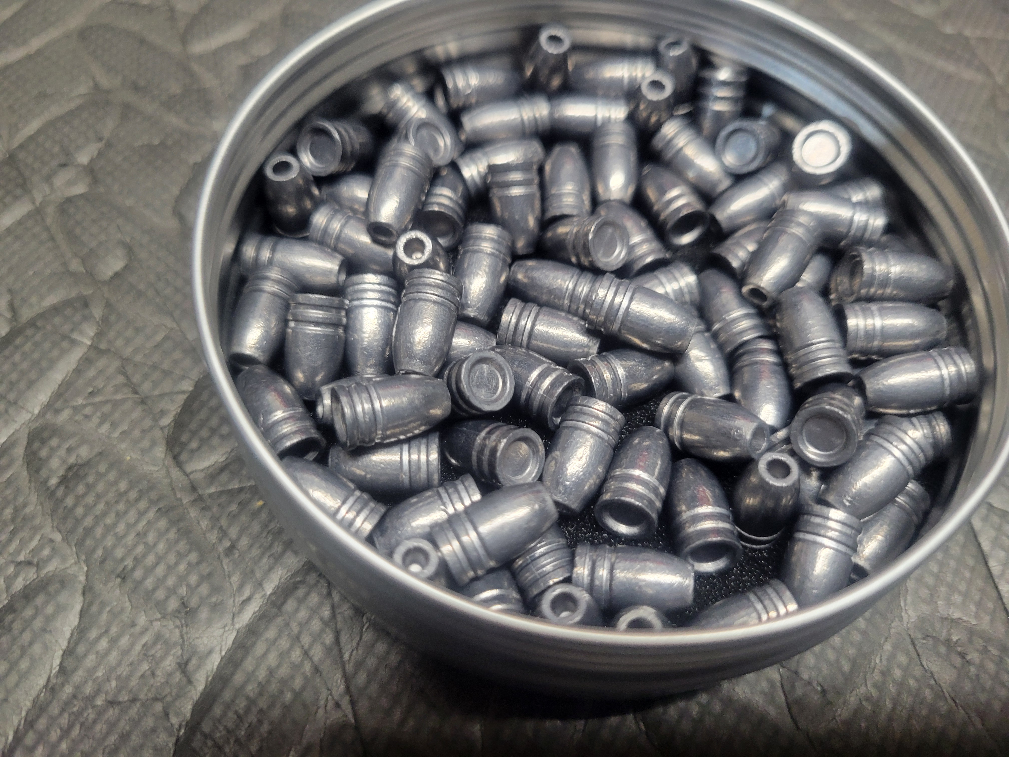

Rti mora .25 600mm @ 50 yards 5 shot groups. I ordered one tin of new aea master slugs 49.2gr to try out. I had some decent groups shooting at 925fps. With shipping they are approximately $0.14 per round. Altoros 60gr are what I have been shooting but cost $0.28 per round with shipping. The altoros are a better slug but these master slugs are a decent round at half the cost. Im definitely going to order more and try them at different speeds and dwell setting. These slugs are currently available at fox air and Utah Air
