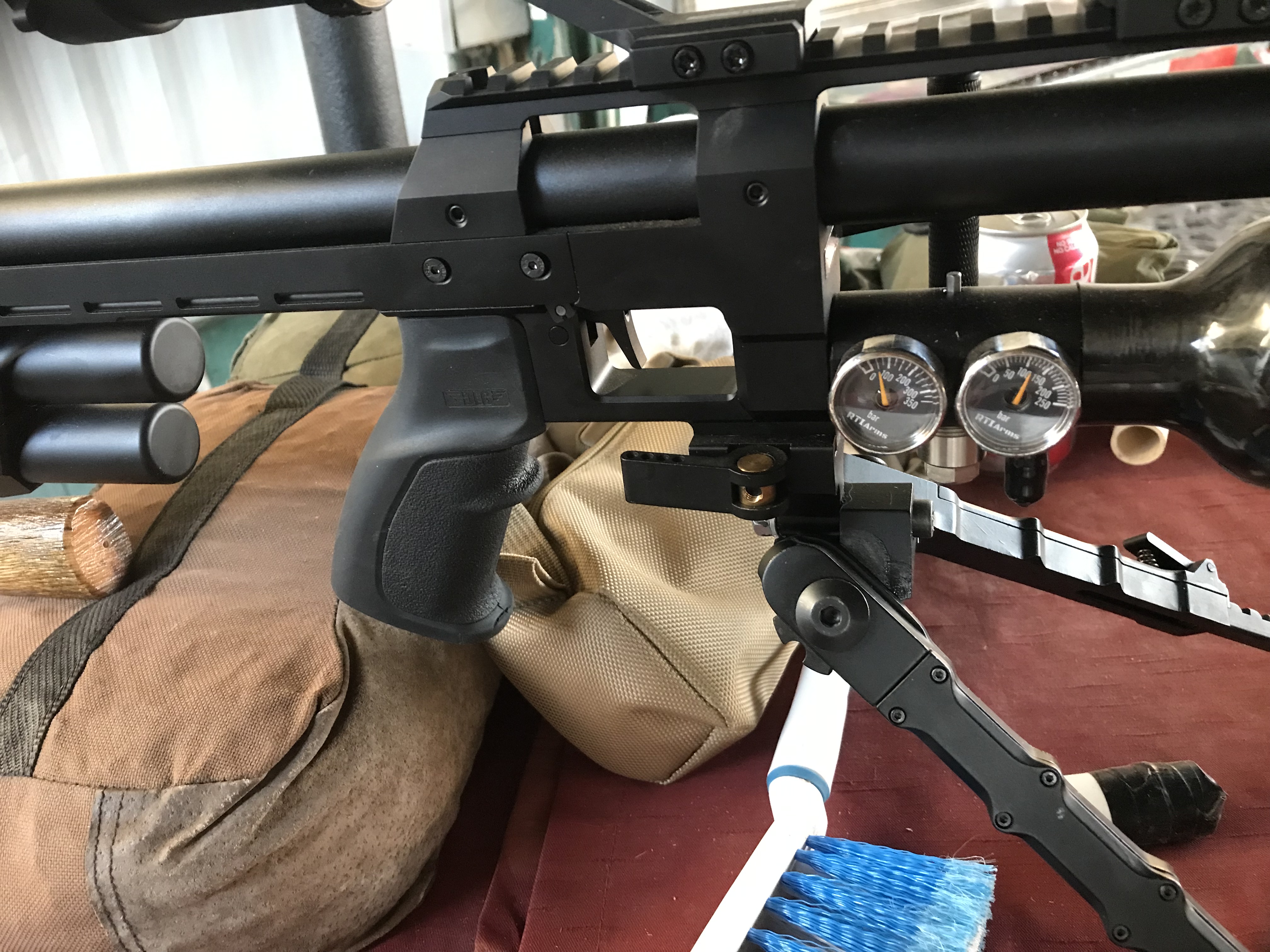

Put mt 510 LW 177 barrel on my RTI compact, It was shooting the 10.34 gr JSB pellets at around 980 FPS .
I thought I would kind of stop a lot off pass throughs on the sparrows , Turned the Regulator down from 100 to what I thought was 80 bar, about every ten shots the gun would make a funny sound and shoot the pellet about 20 yards, Looked at the reg and it was below 50 turned it up to what I think is 80 bar or close to it, The hammer spring really has no effect on the FPS I turned it out all the way and then turned it in a few turns to make the gun sound right , So long story short keeping the Reg at 80 bar and the hammer spring two turns in from flush I settled for 700 FPS with 10.34 gr pellets,, I shot a whole tin of 500 pellets it was open but it was a new tin one setting and no refills , I don't think my bottle was all the way full when I started either
