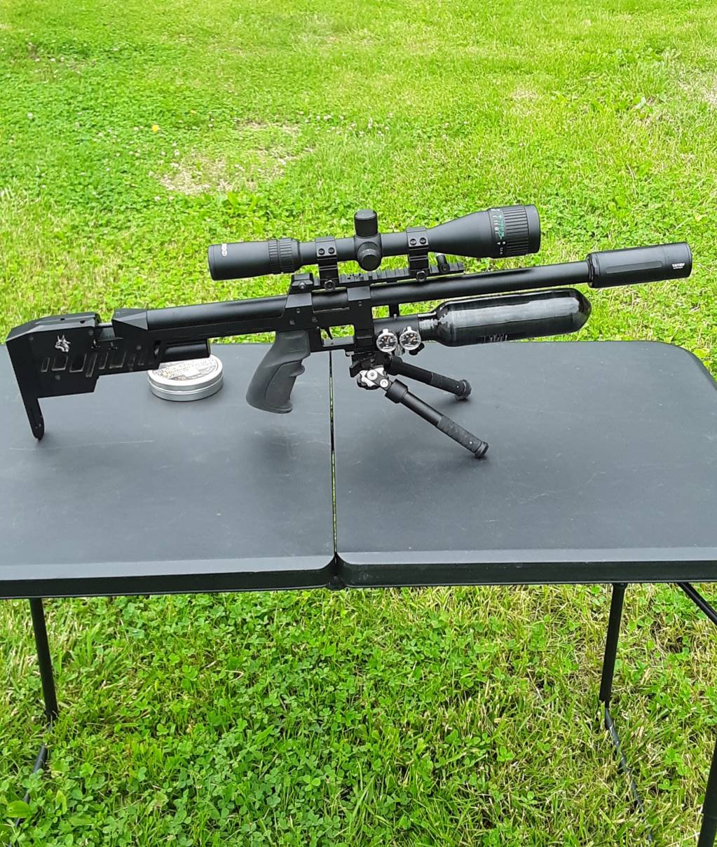

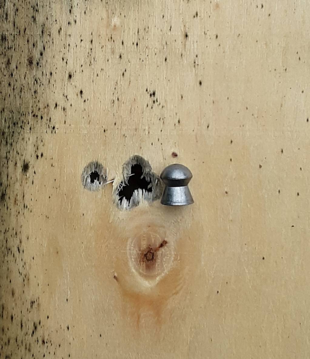

@Mr.H above pic is the RTI in 25cal. I just recieved a donny fl tatsu in the mail today and shot a 48 yard group (range finder) with it on.. I tried the marauder baffles to keep it nice and compact.. to my ear there was not much of a sound dampening... I also tried the baffles in my wifes 22 compact. Again to my ear and hers... a no go. But the donnie sure quiets them down nicely.
