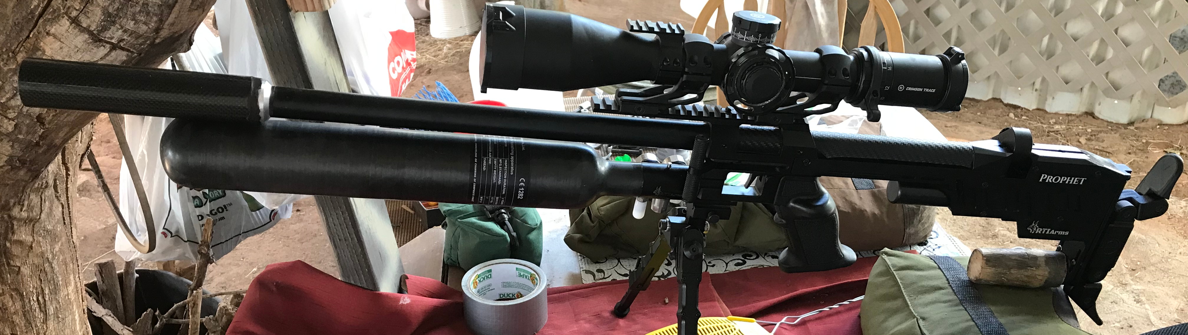

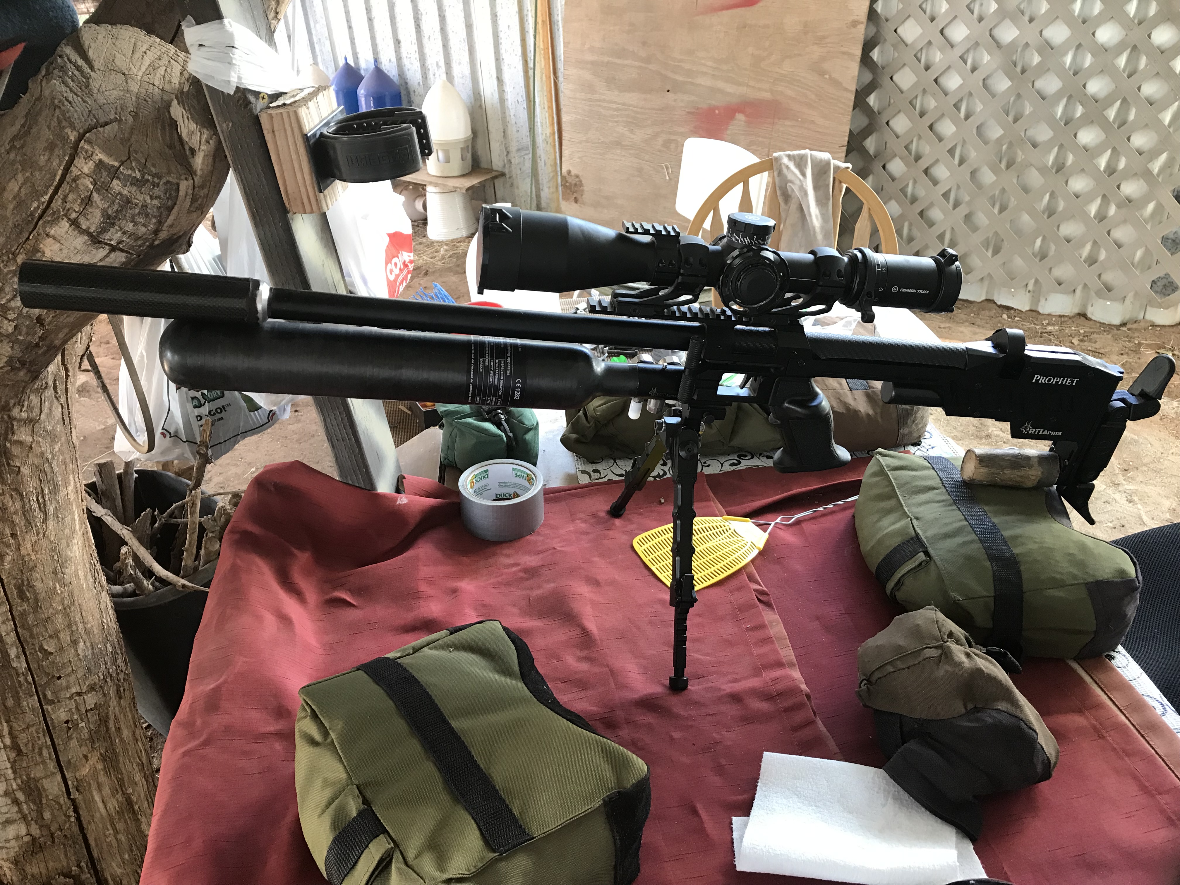

This is what the prophet looks like with a 700cc bottle

If you enlarge the picture you can see where I had to sand down the end of the moderator, Prophet feels a lot better with the extra butt plate on it. But how do you set the gun up with the butt plate on?? My bag rider is just and old ax handle I sawed off. I was going to stain it just never got around to it.

I really like the 700cc on the picture Mike, the moderator is the only issue. I think we need a looong aftermarket shroud, the adapter to extend it is not going to be enough.
