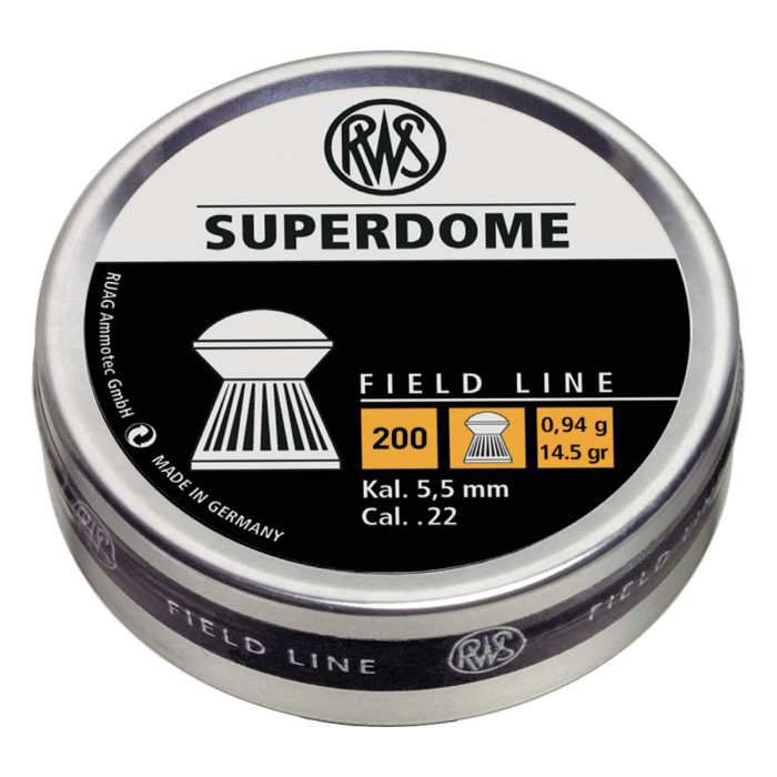

Today I bought 10 tins of RSW super dome .22 pellets at my friend's pawn shop for $40 I've never bought these kind before but couldn't pass on the deal.
Have any of you had any experience shooting these?
I shoot them,they work good in all my air rifles,fact is I use them first and then go from there because they work better than most...that said I do find the RWS Meisterkugeln even better in some of those same air rifles.....

However, the BC is far below average.... 🙄
BC's of domed pellets of similar weight:
BC 0.012 — RWS Superdome 14.50gr
BC 0.019 — H&N Field Target Trophy 14.66gr
BC 0.022 — Crosman Ultra Magnum 14.30gr
BC 0.023 — Crosman Copper Magnum 14.30gr
BC 0.025 — JSB Exact Jumbo Express 14.35gr
BC 0.026 — H&N Field Target Trophy Power 14.66gr
BC 0.030 — H&N Sniper Light 14.04gr
For example:
Shooting my PP700 in a 5mph wind out to 32y would make the JSB Express drift 1 inch.
The SuperDome would drift more than double that (2.2")!! 😟

the BC info on the .22 RWS SuperDomes is low all around.....
▪0.012: BC Test: HardAir Magazine (2017-07). With 35FPE at 30y
▪0.013: BC Test: Bob Sterne (2007). With 25FPE at 25y. Using the G1 drag model at the time.
https://www.gatewaytoairguns.org/GTA/index.php/topic,14735.0.html
▪0.013: BC Test at 11FPE out to 55y (in 5y steps): By Giles/ AirgunGearShow:
https://www.youtube.com/watch?v=cyTZGOMSMUk
▪0.016: BC List: ChairGun V 4.3.1. (2017)
▪0.016: BC List: ChronoConnect (2012)
So sad! 😟 Such a high quality manufacturer — but clearly focused on 10 meter target shooting, not long range nor hunting.
