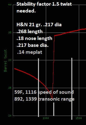

I just pulled out my calipers and measured a worthless to me H&N 21 grain slug, my uragan HATES them.. I put all the measurements in a proper stability calculator at 59 degrees F and 29.92 inches of mercury atm pressure for a stability factor of 1.5. This is what it spit out, the lines I added for .8, 1, and 1.2 mach are not perfectly placed but are very close. Twist rate kind of hard to read, it goes from 20 to 40 in steps of 5.
