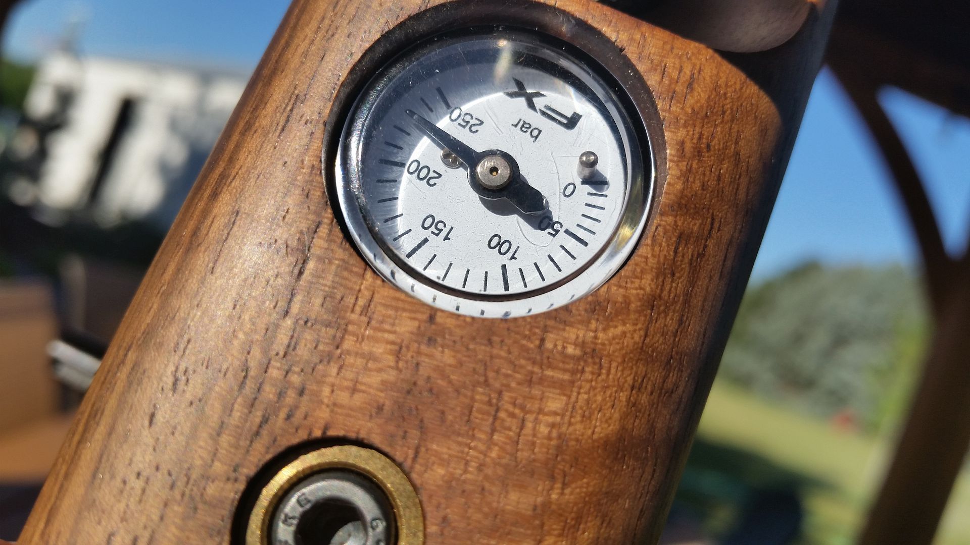

Took the Royale out today after you started the topic for a test. I am shooting 914 FPS avg. with JSB 18s at a 230 fill. I am able to get about 90 shots before falling off the regulator. I would have put up my chrono work, but the data would crash every time I would reach about 75 shots (started over three times). I would lose all my data with no memory.

Last question......... You noted the gauge on the pump and gun are the same. Hand pump right? If you used a bottle and filled too fast the bottle will heat as compressed. This would give you higher pressure until the gun's bottle cooled. Kind of a false full 230bar leaving you with lower starting pressure.
