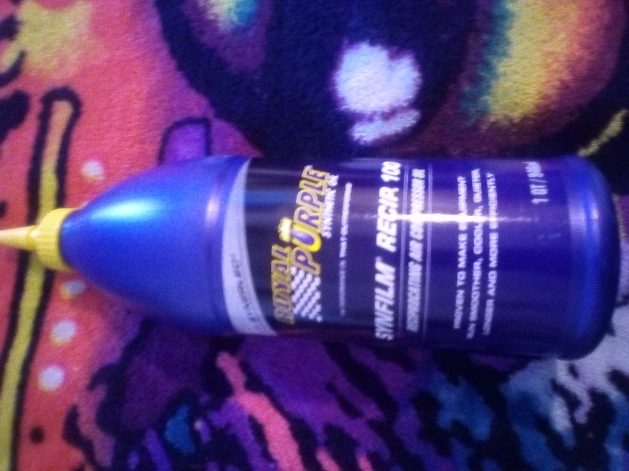

Ok. I read the instruction manual that came with my Tuxing model TXED012 Twin. It states to use the Royal Purple oil : Synfilm Recip , 100 stock # 01513.
Ok so when I did my homework I had already bought this oil before my compressor arrived then found the instruction manual suggestion to use this oil. As I was chatting with my AI I mentioned the distilled water I had purchased (Thanks guys) for my twin cylinder Compressor. So the AI made a suggestion to use Royal Purple Purple Ice. This is an additive for the distilled water , and can also be used with already existing anti freeze solutions.

I'm not concerned with freezing where I live , so this cooling system will just have a mixture of distilled water , and Purple Ice. The mixture ratio is 4 ounces per gallon , and my system uses 10 gallons of distilled water , and the Purple Ice comes in 12 oz bottles , so I will have to use 40 ounces. The extra 8 ounces will be mixed with 2 gallons of distilled water to compensate for evaporation as it occurs. I ordered the 4 12 oz bottles from Amazon.They will be here on the 24 th. The oil pic.

You can use water wetter as well found in most auto parts stores. As a side note I would not use royal purple syn film oil in your compressor. It will break down very rapidly. highly suggest Seco 500 synthetic, save yourself some headaches.
Manufacturers recommendations exist for a reason.
Synfilm 100 is ISO 100 viscosity. Recommended by many manufacturers for wear protection , and thermal stability.
Secolub 500 is typically ISO 150 viscosity meaning it is thicker , and may provide slightly better sealing in some compressors, but it might not flow as well in cold starts. The claim that syn film 100 breaks down quickly isn't really accurate. It's known for long lasting performance, oxidisation resistance , and minimal carbon buildup. Unless your manufacturer has tested , and approved Secolub 500, I'd stick with Synfilm 100 since it's specifically recommend by the Tuxing manufacturer.

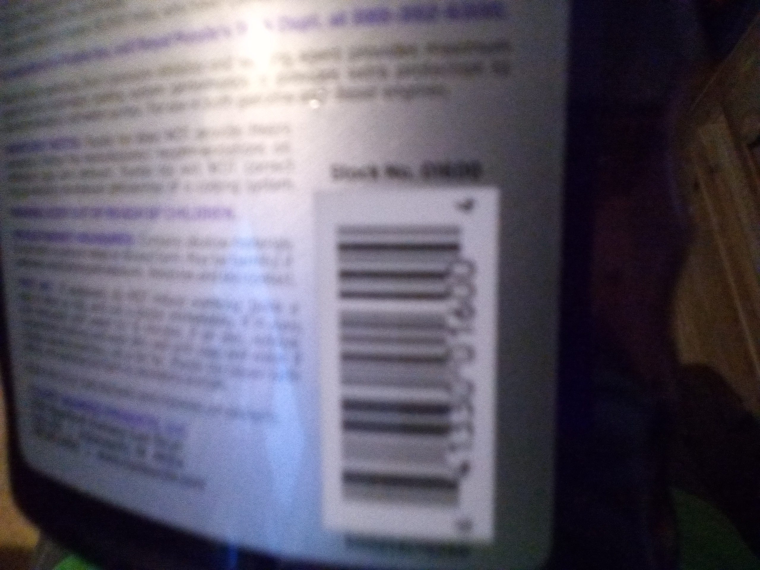

I have an older bottle of "Royal Purple oil : Synfilm Recip , 100 stock # 01513" that does not state safe for breathable air. I quit using it because other posters (about 2yras ago) were finding carbon deposits on the valves causing failure in use when this was used. The part number is the same but nowhere on the bottle is it called "purple ice".
Is there a change in spec on this product? The part number on my bottle is the same.
