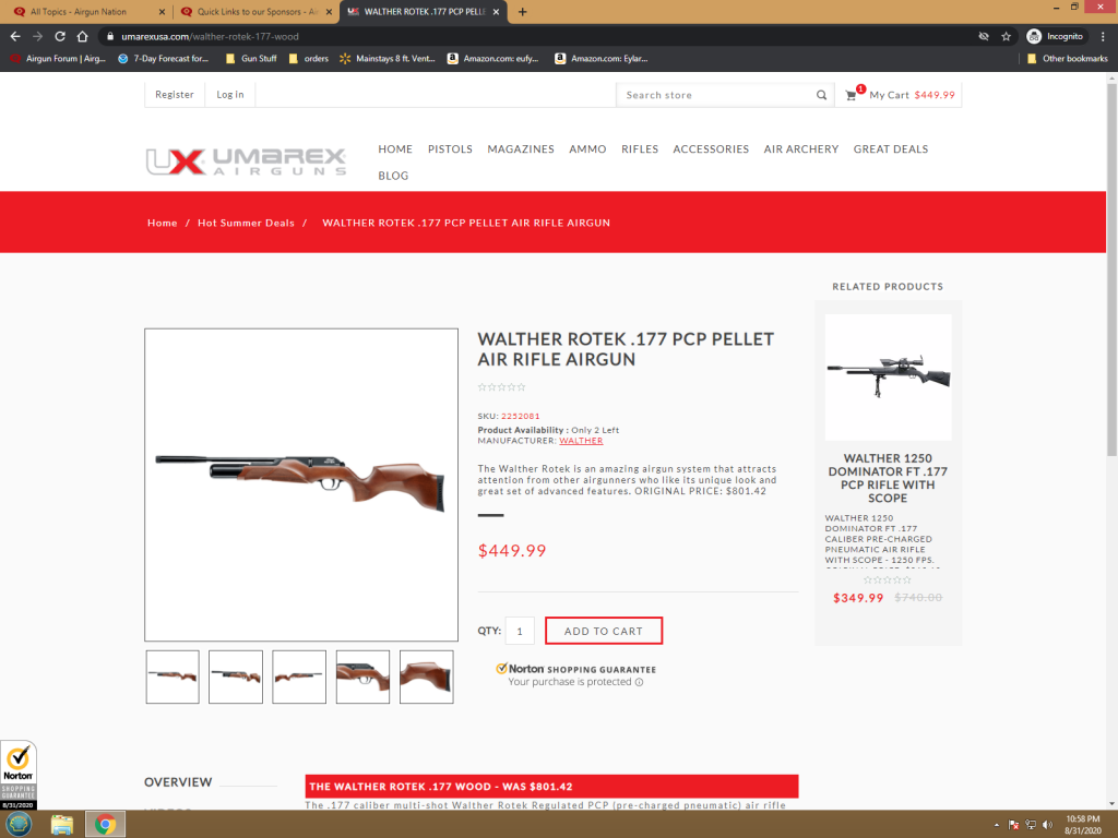

Rotek for 449
Umarex has the Walther Rotek for $449 and free shipping. One heck of a sub $500 deal! Only in .177 though.

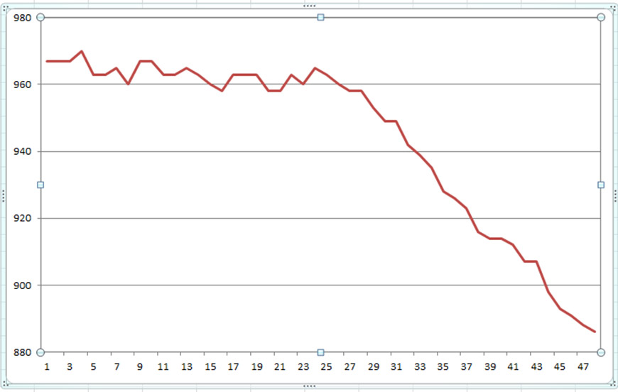

Well, out-of-the-box I have confirmed that my .177 Rotek gets maybe 25-27 consistent shots. I have not made any changes to the gun, like backing off the hammer spring as suggested above. I just wanted to confirm what I thought I had seen in my first shooting session with it yesterday.
Started off with a full bottle per the higher resolution gauge on my compressor. 232 Bar on the compressor gauge was closer to maybe 245 Bar on the gun's gauge, if I had to guesstimate. Bottle values were: 220 Bar after 8 shots, 200 Bar after 16 shots, 180 Bar after 24 shots, 155 Bar after 32 shots, 150 Bar after 40 shots, 140 Bar after 48 shots. Was shooting JSB Exact Diabolo, 8.44 gn pellets, straight from the tin.
Following is the chart of pellet speed in FPS from the string of 48 shots. Waited at least 5 seconds between shots in case the regulator needed to 'recover'.
Maybe not how they all are, but this is how mine is out of the box (purchased directly from Umarex).

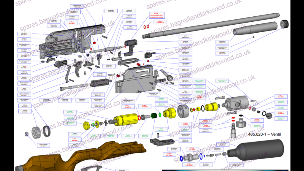

It is the ability to tune (beyond varying pellet weight) which will seemingly be an issue here. Aftermarket regulators (generally for more power) are available - for 2/3 the price I paid for the whole gun. Apparently the OEM regulator is locked out from adjustment. Even replacement parts (for the Walthers) seem to have a very limited availability through Umarex in the U.S. So if I start cutting coils off the hammer spring and screw up...
