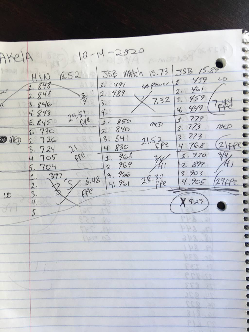

Seriously doubt it will hurt,I’m in the process of testing pellets too.Just DO NOT try those .22 ruger pointed from Walmart.They are crap!
a few numbers from different pellets and power levels.

Yeah in PCP rifles it doesn’t matter if you use light or heavy pellets. And I’m pretty sure those copper pellets are just a thin coating. I don’t think they are like a copper jacketed powder burner bullet. As long as the pellet feeds in the magazine, you’ll be fine. It’s just like with anything else you buy, they recommend you use their products. If you buy a Chevrolet they tell you to use genuine AC Delco products. You must still be doing a lot of testing. I was looking back at your 50 yard targets again and those 25 grain JSB pellets look to be not too bad of a group. Even the one group of the 18 grain looked pretty good.Maybe you just got a find the right velocity for either of those pellets. I’m still learning something every day about these guns. But a good while ago I read on a forum that said if you shoot a bunch of different brands of pellets that it is good to give the barrel a Good cleaning because of the different brands having a different lead composition. But once you find a pellet it likes then you don’t have to clean it for Long time .I don’t really know How true that is, it’s just something that I read.Some people never clean their air guns as long as they are shooting accurate.But whatever you’re up to good luck with it.
