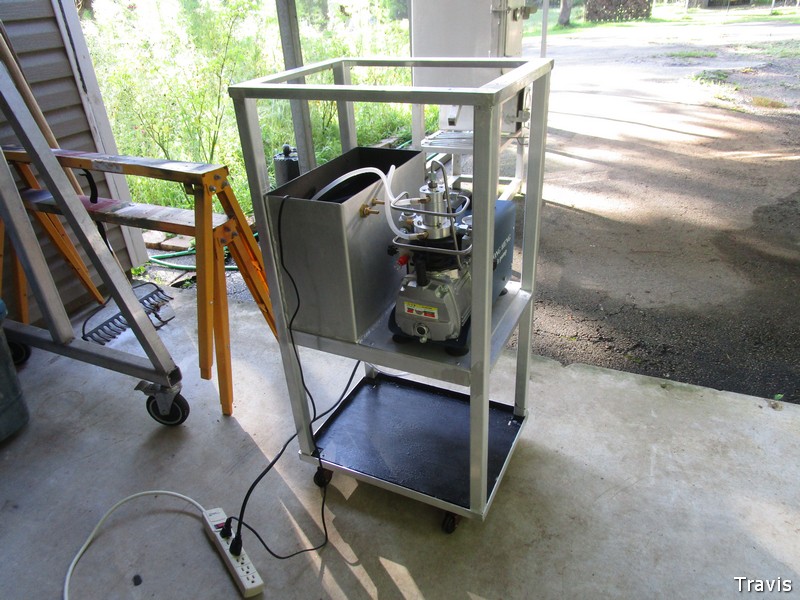

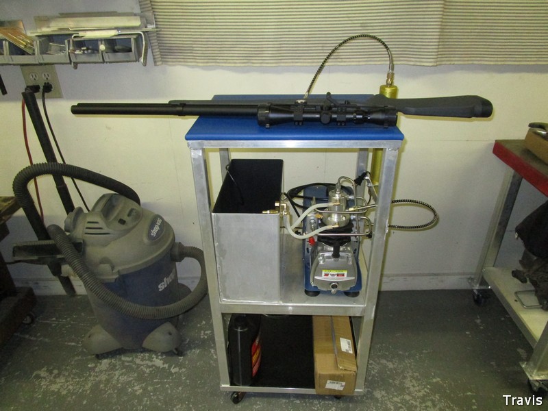

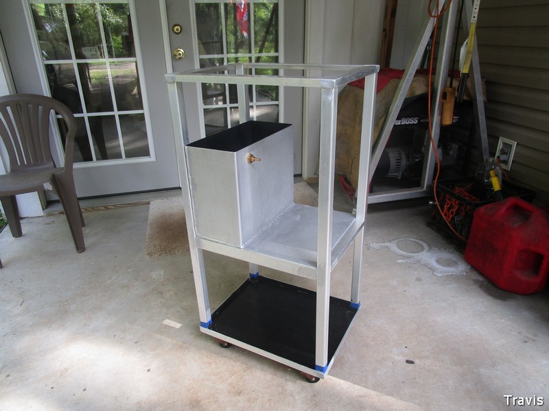

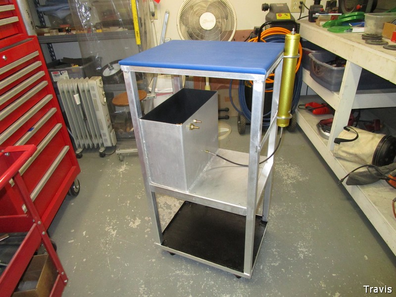

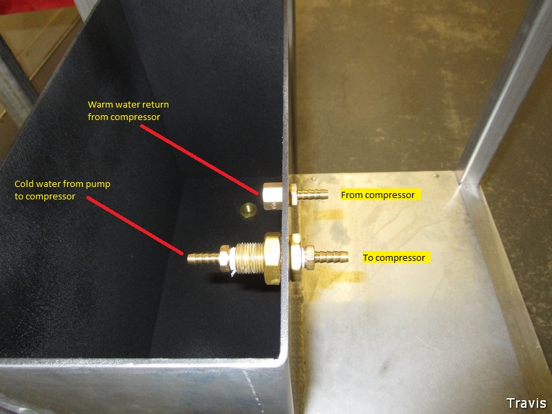

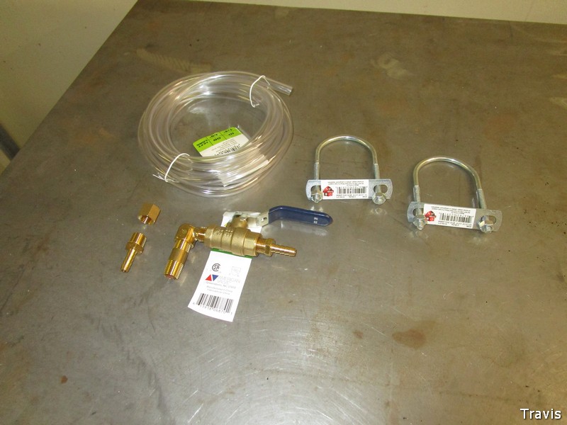

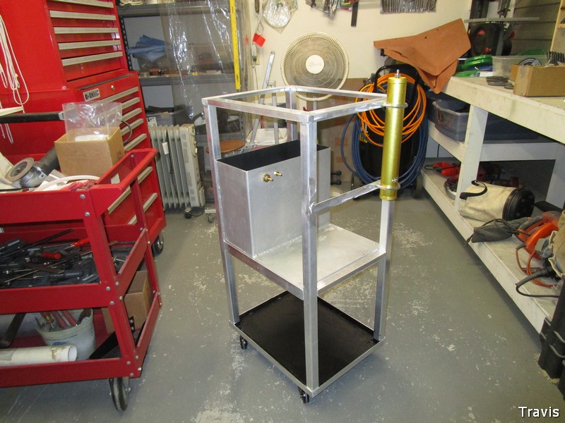

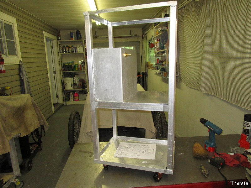

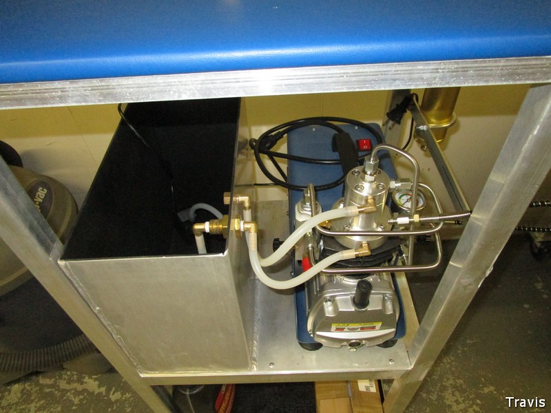

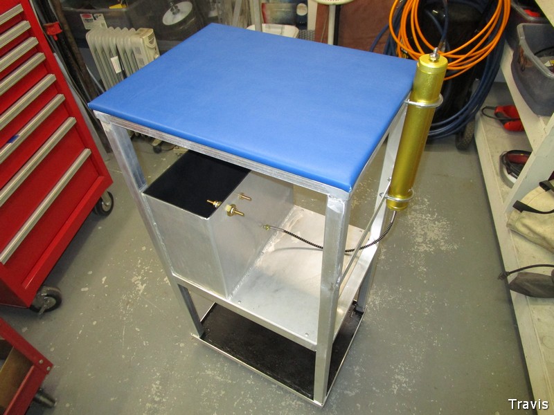

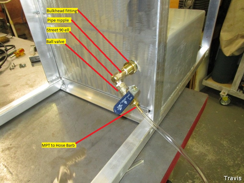

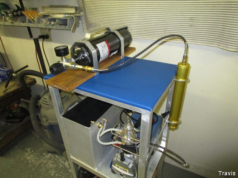

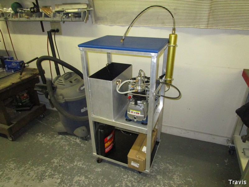

Hello everyone, I have designed and in the process of building a Roll Around Stand for my Yong Heng Air Compressor, the Tuxing Air Filter, a place to set an Air Tank or Gun to be filled and some Storage for supplies. Attached is a concept drawing and several photos showing what I have completed to date. As you can see I installed four swivel casters so that the whole unit can easily be moved. There will be brass fittings on the water tank to supply the cold water to the Compressor and a return line for the hot water. Also installed on the bottom of the water tank will be a valve to drain the water easily. I lined the inside of the water tank with rubberized bed liner paint to make it easier to keep clean, I also used the same paint on the bottom storage shelf. I will add more photos as soon as the unit is completed.
