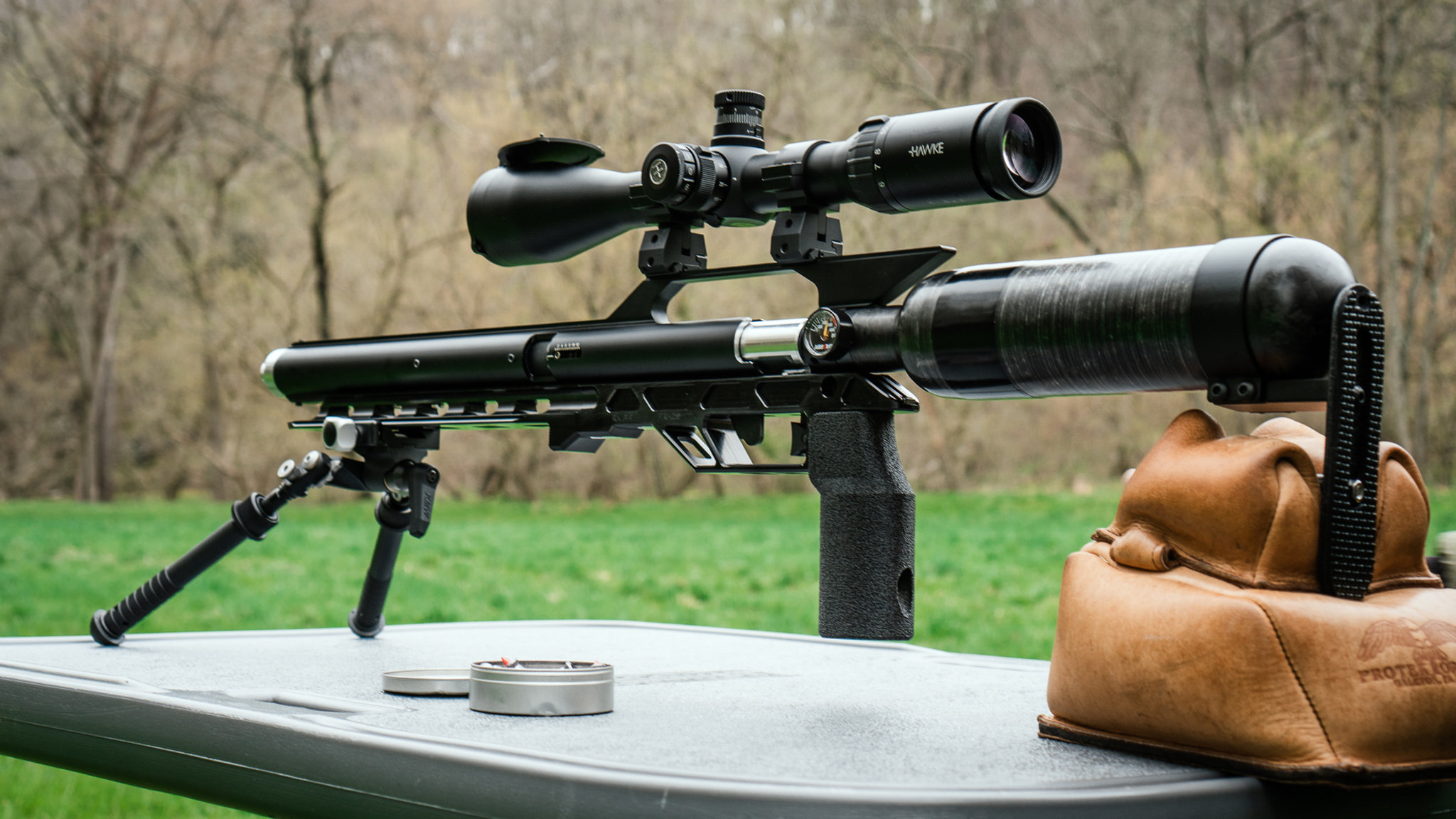

Are there any vendors with RMPA precision triggers in stock? My understanding was the guy behind RMPA was suddenly laid off or something like that and it threw a wrench in his plans to get the company off the ground.
...as I'm writing this I just checked the RMPA website and it is gone. It was live a week or so ago last i checked.
Hopefully the guy isn't in bad shape and had to cancel his webhosting.
He has a precision chassis for the Condor that was due to enter production soon.
