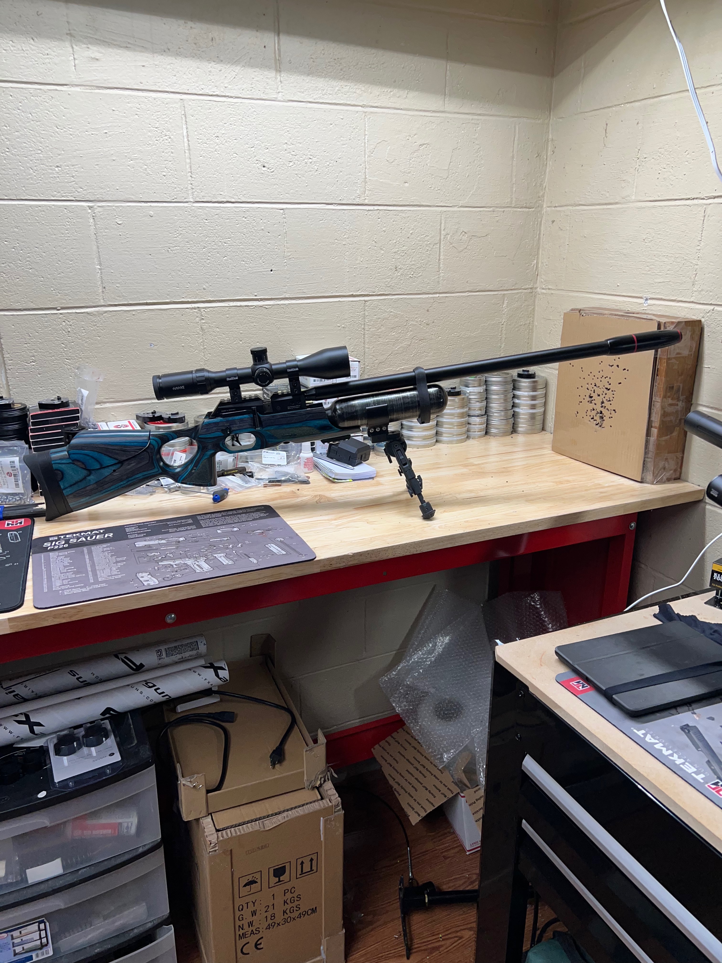

I know a lot of people are scared to bump their barrels in fear of a POI shift. However I did some testing today with my .30 Maverick and even after grabbing the gun by the end of the barrel and shaking it violently in between shots it still held it's POI Grouping. Mods done recently include epoxying the carbon sleeve to the liner, installing a bullet central tensioning kit, and installing a black arts design bottle/barrel band. I think the barrel band definitely has the largest impact. This is a very good quality product and the owner even sent me an extra fastener after I dropped one and lost it. Now I'm not so worried about POI shifts day to day or after I bump into something. Just thought I would share.
I haven't gone to THAT extreme but, I did put on a bottle sleeve that did raise the barrel up about 3.5MOA at 30 yards(600mm barrel, .22), beyond that no noticeable difference after 50ish shots. My CF liner isn't epoxied on. I've never really had an issue with the barrel moving around...EXCEPT then things were loose, if it screws onto the barrel or shroud, make sure it is snug..
Well my original shroud are gone replaced by carbon fiber in the same OD.
Not really for fear or POI shift, but rather i upgraded from 600 to 700 mm barrel length, and doing that with all FX parts would be insanely expensive.
So i got a 100 mm extender for the barrel pipe and 3 CF pipes from China that fit on the barrel pipe and inside each other.
Mind you ! those CF pipes, well it do mean that they have to be in the same place, CUZ clocking them which you can as they are just a light press fit on the barrel pipe, well where you hit will change dramatically.
BUT ! once set up you are good, just something you have to remember if you had the barrel off the gun / out of the CF pipes.
I still feel that the FX barrels feel flimsy, and i suppose others also feel like that, i much prefer the heavy CZ barrel of my Vulcan 3

I just did this with my .25 Avenger. Used 5 carbon fiber tubes that fit inside each other. Put them all together with epoxy.
I just put one of those on my 600mm Crown. Its the first one I have had that I actually like and think works.
