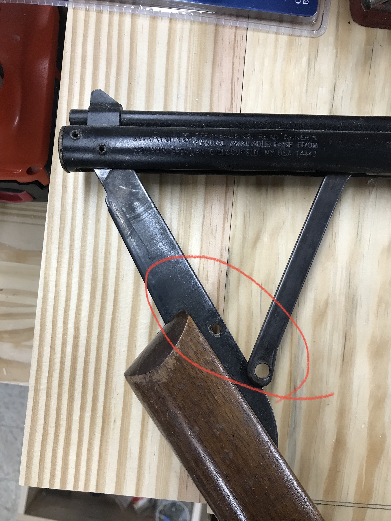

I've got a Benjamin 397PA that's been in the basement for decades that I bought for my now grown son when he was a kid. It seems to be in good shape other than it's missing the rivet for the pivot point on the pump lever. I can't find an actual part# or resource to get one of these. Any suggestions appreciated.

There does not appear to be a part number for it since it is part of the forearm assembly. See attached parts list.
@hawkeye69 has a good suggestion. It should be easy enough to fix with something from your local hardware store.
It’s got sentimental value & I want the grandsons to be able to use it now so I would just buy the whole lever. Not seeing that available either. Probably going to end up spending a day “engineering” it. Finishing up a kitchen remodel now so The Wife wouldn’t be thrilled for me to burn up a weekend on a pellet gun! 😀
You can find 13/64 Chicago screws online that might do the trick. Figure out what you need from McMaster then look around for somewhere that you can buy from. https://www.mcmaster.com/chicago-sc...esistant-316-stainless-steel-binding-barrels/

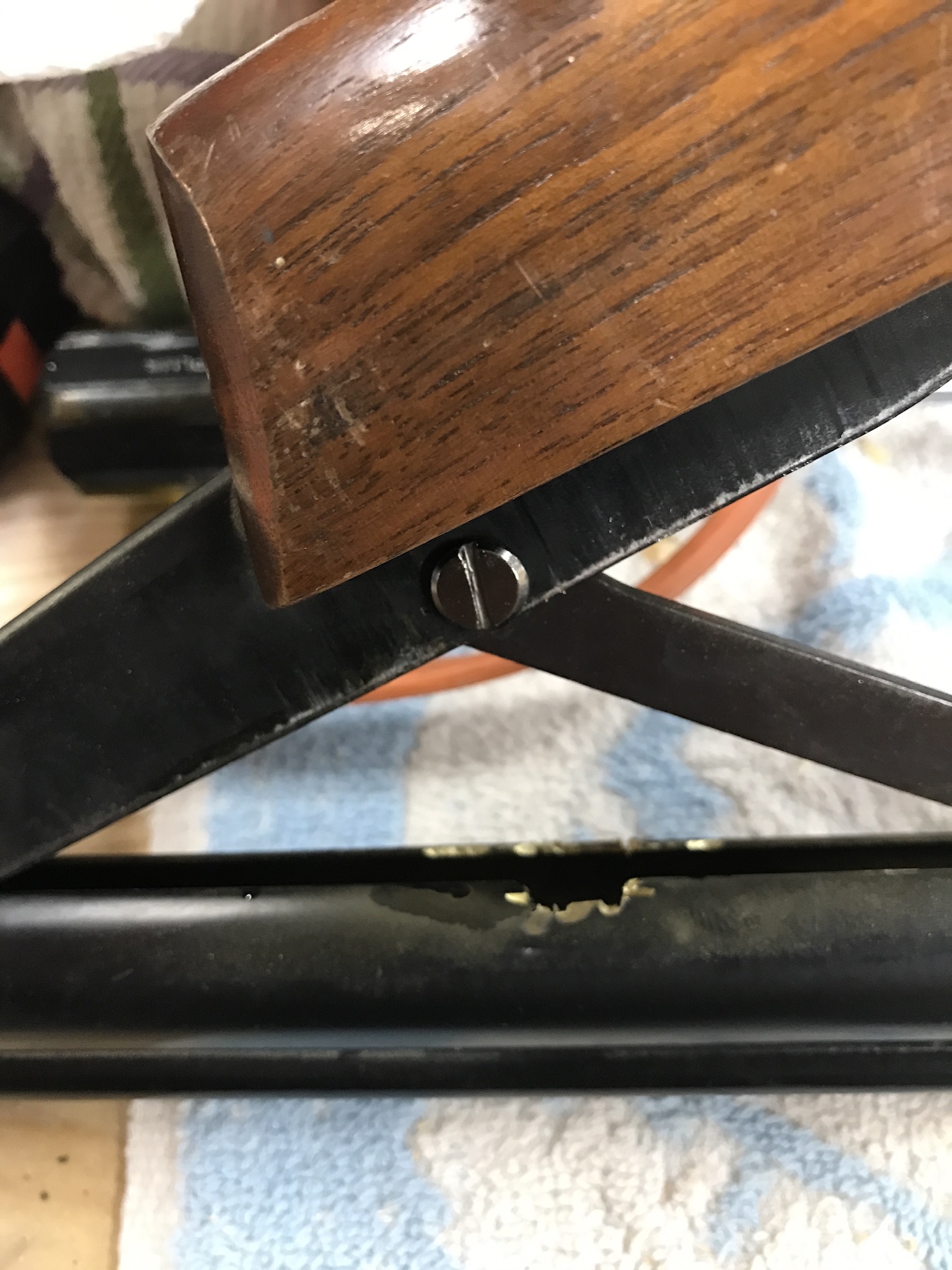

Well, the Chicago screws got here first & I was able to get that to work with a little bit of jury-rigging with the Dremel, since the screw heads came out past the lever where the original rivet was flush. A little ugly if you look, but I’ve now got a working plinker for the grandkids - it wasn’t destined to be a collector‘s edition anyway. Hit within 1/2” of a 1/2” ⭕️ on 1st shot in 20 years! THANKS TO EVERYONE WHO RESPONDED!
