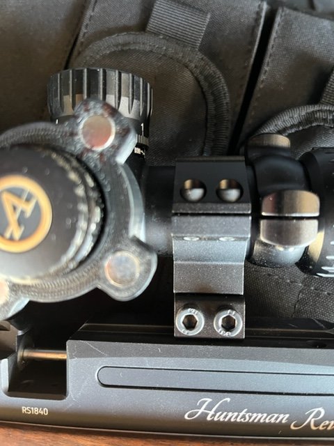

I pulled out the huntsman and I didn't use those rings....I am sorry for the bad info, I used a cheap set of high rings and they work perfect....
There is plenty of room for the magazine and if I remember medium rings were to short. Once the scope was mounted it was easy to get all setup and sighted in. Yes my rifle needs a good wipe down....It was dusty out there at the vineyard.

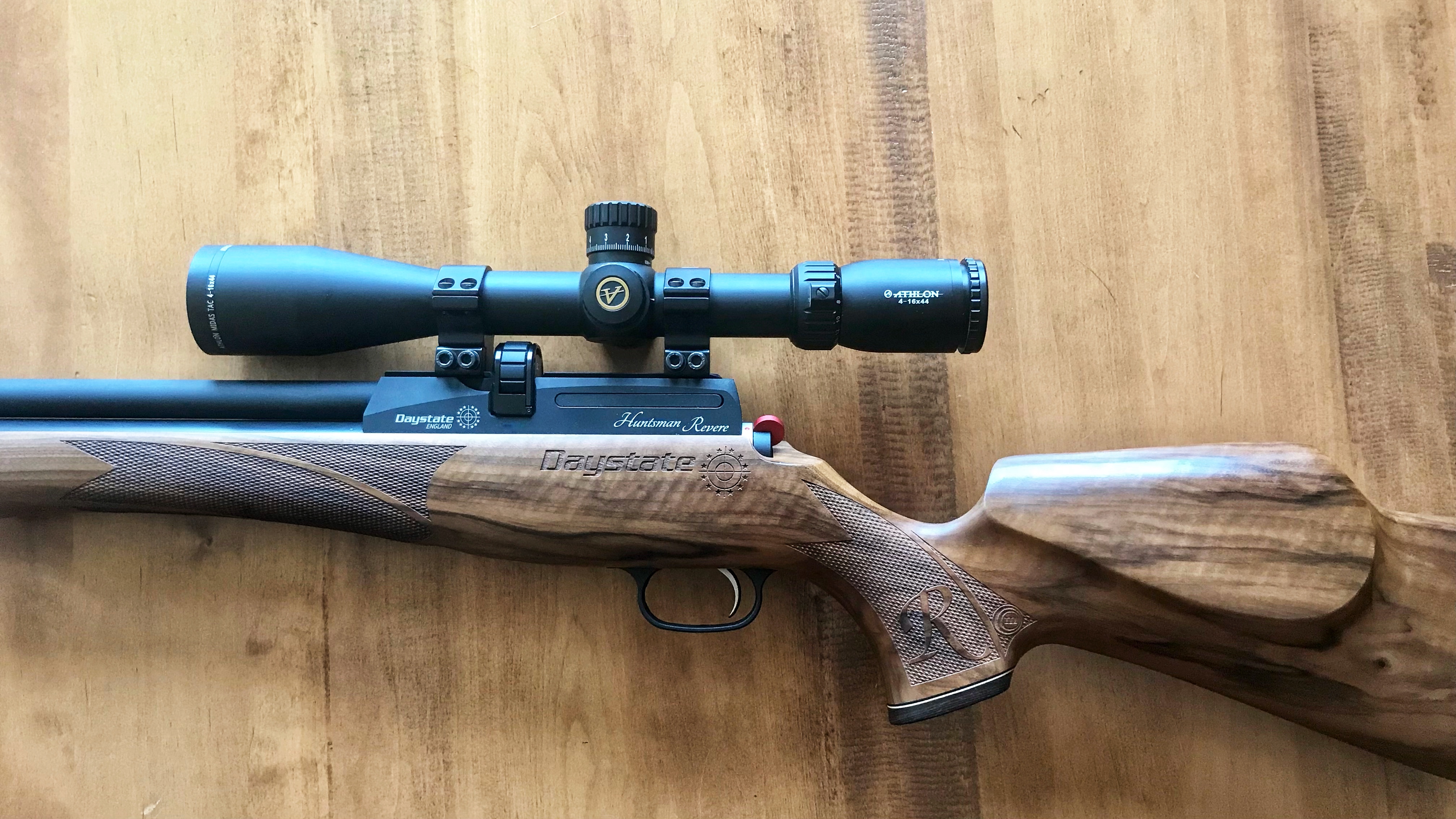

Thank you. I was just interested to see what it would take to clear the newer magazine. I have a set of Sportsmatch high rings (HT036C) about, and will give them a try first. If that does not work I will probably go with the Sportsmatch extra high (ATP61). I see this rifle as being set up for no more than 50 yards, so should not need the extra adjustability.

For anyone interested, the Sportsmatch HT036C rings fit, allowing sufficient clearance for the new magazines. I thought I ordered a 25 caliber version, but a 177 caliber version arrived. I am very pleased, though. I also did good on the walnut stock lottery,...
Sportsmatch website-
You did win the stock lottery!!!!! I shot mine again this past weekend and got 3 squirrels from 45-55 yards with it...hunting was soooo slow Mike (Centercut) and I were shooting at an orange 98 yards away in the wind...Second shot was a hit.....and with the small 0DB moderator it is sooooooooo quiet....You will love the rifle!!!!!!

You did win that lottery! My stock is nice, but that’s a true winner.
