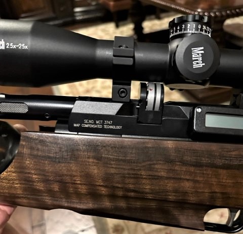

BTW, the attached photo shows the scope and mag clearance on my Air Wolf with a 42mm Objective lense. A 44mm objective may also fit, but probably without the lense covers.

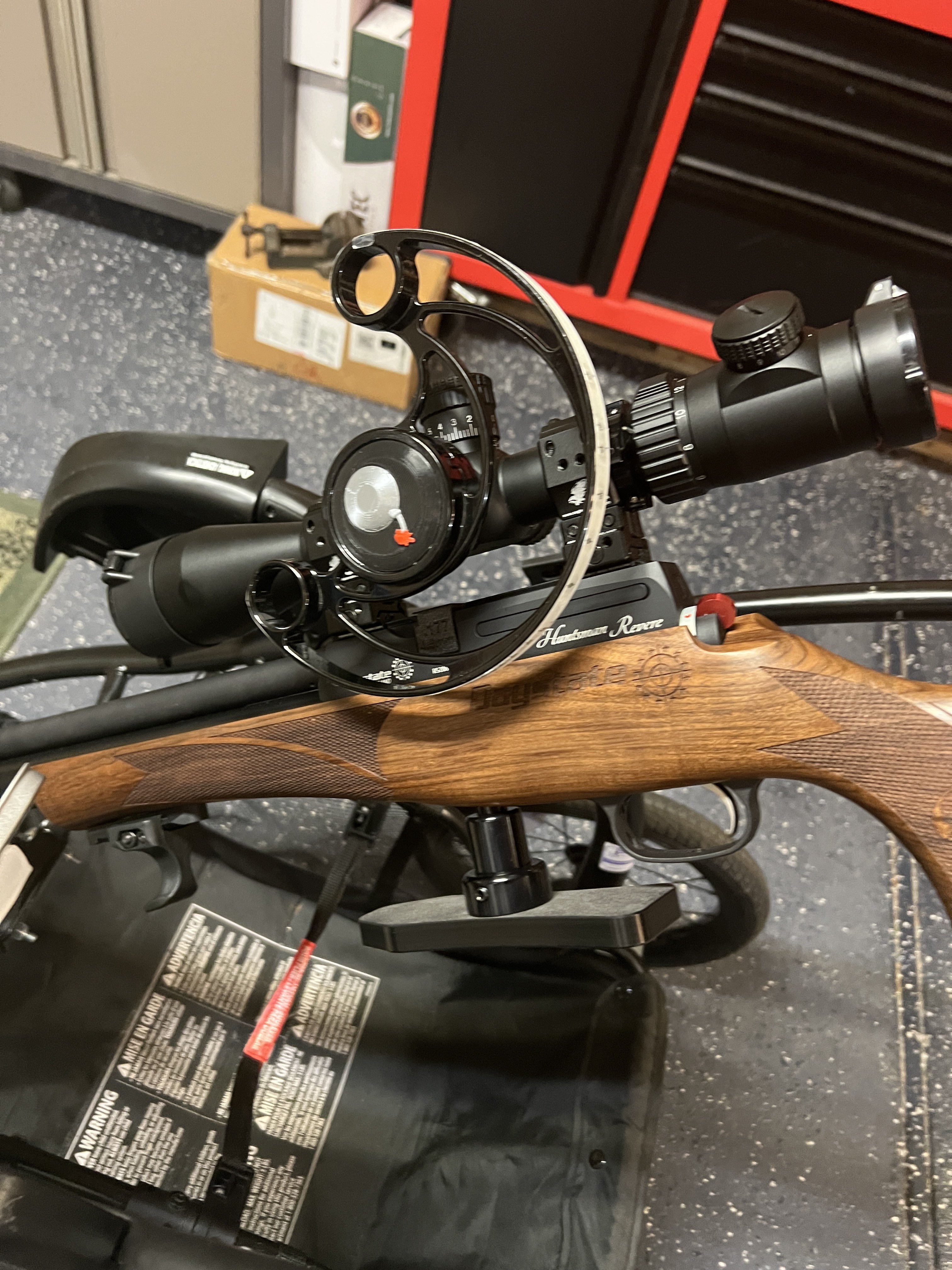

Keep in mind that depending on where you want your scope, the turret housing may also get in the way of the mag since this sits a few mm lower than the tube itself. There’s also a notable difference between using 1” tubes and 30mm tube scopes. The 30mm tubes are less forgiving for clearing the mag. I had to go with the CARM low profile mags for my Revere in order to fit my scope where I wanted it since it’s a 30mm tube and the turret housing was in the way. And that is even with high rings. I could have moved the scope back a bit more to clear the housing but this was not a comfortable location for me. So just be aware that everyone’s setup will be different. You may not know what you need until you’ve tried your setup.
