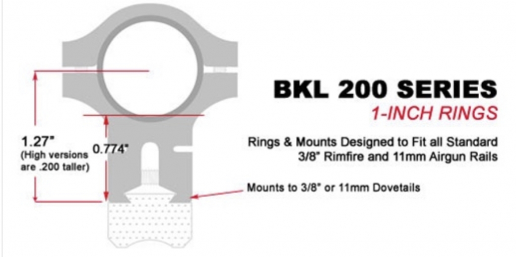

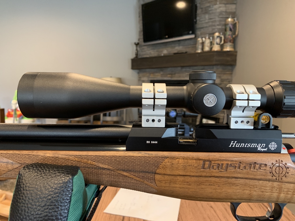

I have BKL 1” double strap rings on my Regal XL and a Hawk Vantage 4-16x44 scope. The combo works very well. Below are the ring dims and pic of my setup. Let know if you have any others questions.
