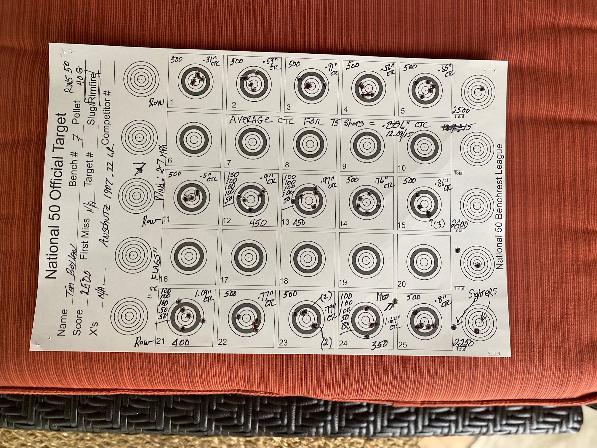

I have two Anschutz .22 LRs; one is what I might consider to be a bit higher than "base class" in the 64 MPR. The other is a 1907 single load match grade bench rest rifle ( Pro Class).
Mike N. had a 100 yard " in the rings slug challenge" he posted about a year or 18 months ago. I think a good "use case" for the Panthera would be to try it out using this challenge ( or something very similar at 100 yards ) to see how it does. I see Rusbear's latest 100 yard groups outside in tough conditions, and I am very curious to see how the Panthera will do this year at RMAC and EBR. Those 25 shot groups are outstanding.
Here is my best "slugs in the rings" card with my Annie 1907. My one and only '2500' - top row. Mike N also posted a 2500 with his Thomas.
As a matter of curiosity, I wanted to calculate my average CTC for my three scoring challenges. I had a total of 75 shots, or the equivalent of 15 5-shots per bull scoring for an average .886" CTC sub MOA for 100 yards. I used the best RWS 50 40G ammo, which is perfect for this gun, so is the RWS 100.
