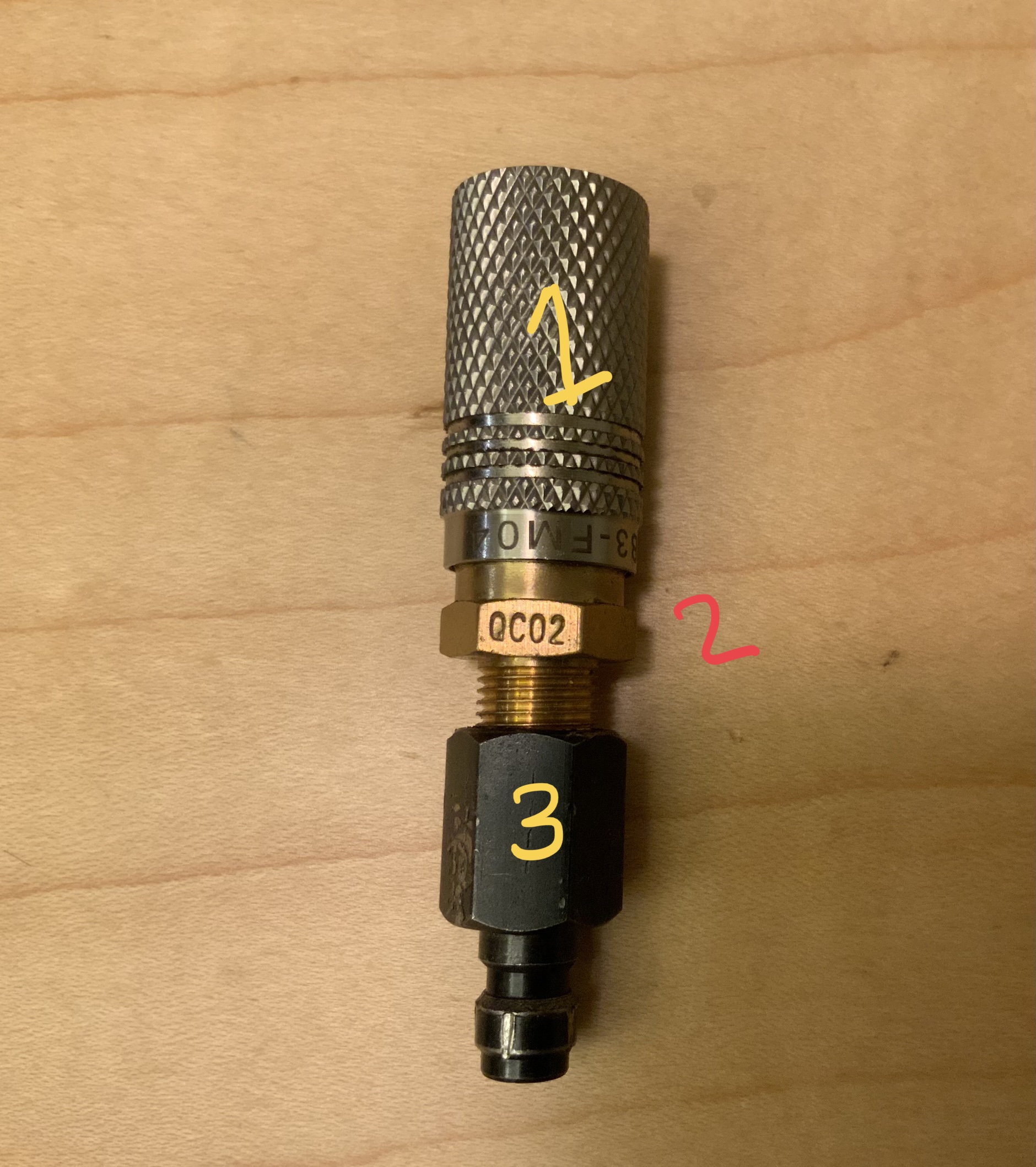

I am only doing it because the extended fitting that comes in the box isn't the same thread as my GX pump for some reason and the foster on the gx pump isnt long enough to get up in the stock where the fitting is. I really want a solution so I can get the longer foster fittinf onto my hose.You have to keep pumping until you hear the check valve release, at that point, subsequent pumps of air go into the bottle. God bless you for pumping up a bottle gun… I couldn’t imagine pumping up my Bantam Sniper HR.
Thank you, I will get one ordered mondayThis is the extended foster fill for my Bantam:
1. The extended female foster
2. the adapter (that won’t screw into your compressor.
3. Adapter with male foster end you can insert into the female foster on your compressor.
I hope this helps… I got that adapter from Airguns of Arizona. Good luck.
I'd just pull the action out of the stock to fill with the GX. Unless you wanted the exerciseI am only doing it because the extended fitting that comes in the box isn't the same thread as my GX pump for some reason and the foster on the gx pump isnt long enough to get up in the stock where the fitting is. I really want a solution so I can get the longer foster fittinf onto my hose.
