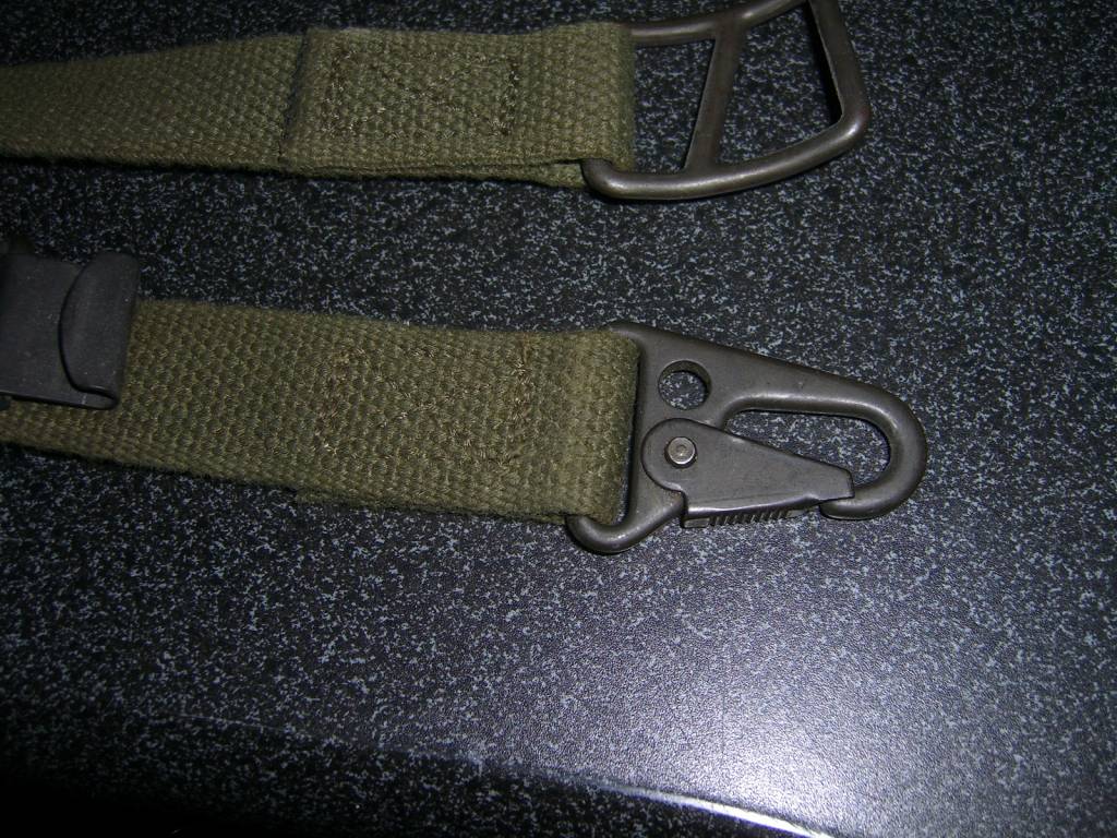

im sure you could put studs in the side .. that wood looks aweful nice though .. also, i have one gun that has an actual small round parkerized eyelet on the side of the forearm grip, thats how it came, with sling, from the factory, and its a higher end firearm wont say what it is, but its not unheard of ... so a safety hook setup attaches the sling to the eyelet ..

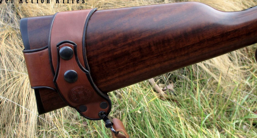

Thanks @dizzums . I just came across these no drill solutions for lever action rifles. Going to give them a call tomorrow to see if they have something that fits or make me one. Lol.
https://brassstacker.com/No-Drill-Harnessed-Rifle-Sling-MOSSBERG.html

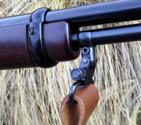

..on one end

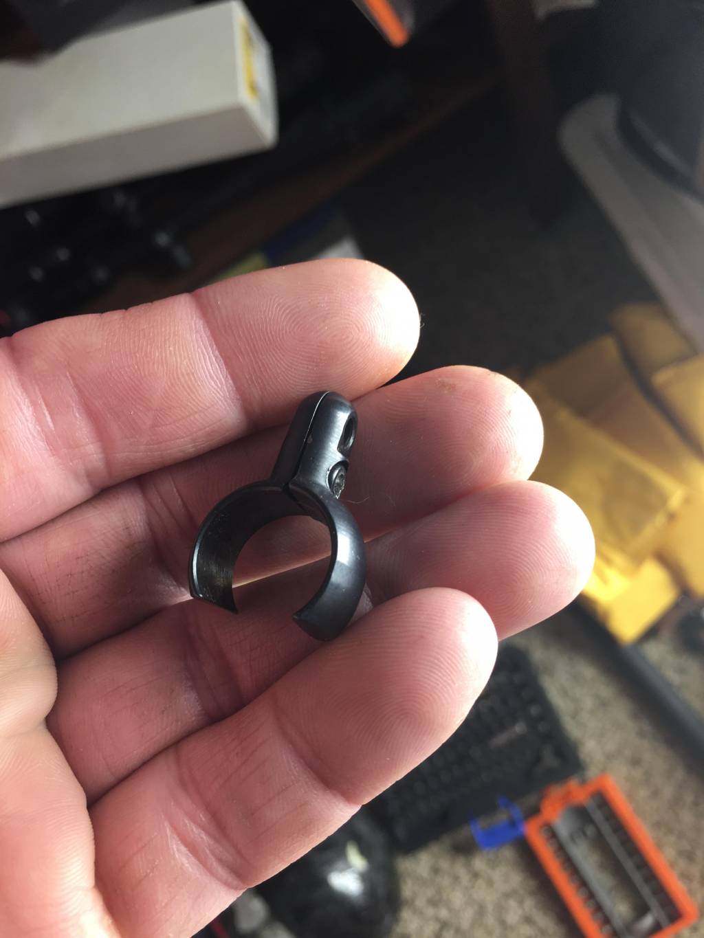

...on other end
Based on where the front is positioned, I think it should be ok/not damage the cocking lever(?).

Yeah they work & that's a fine idea for buttstock; but you better use protective no slip compression tape between your nice laminate HW's lever & these adapters. They're going to move, and if it slides backwards it's going to mess up the pretty stock.
I have no use for these myself.
Edit: and the need for protective grip tape also means potential finish problems under it.

I have a front barrel band mount on the cocking lever of my HW97 and it works great. It won't work on a TX200, the ball detent holding the cocking lever up will not hold the weight.
