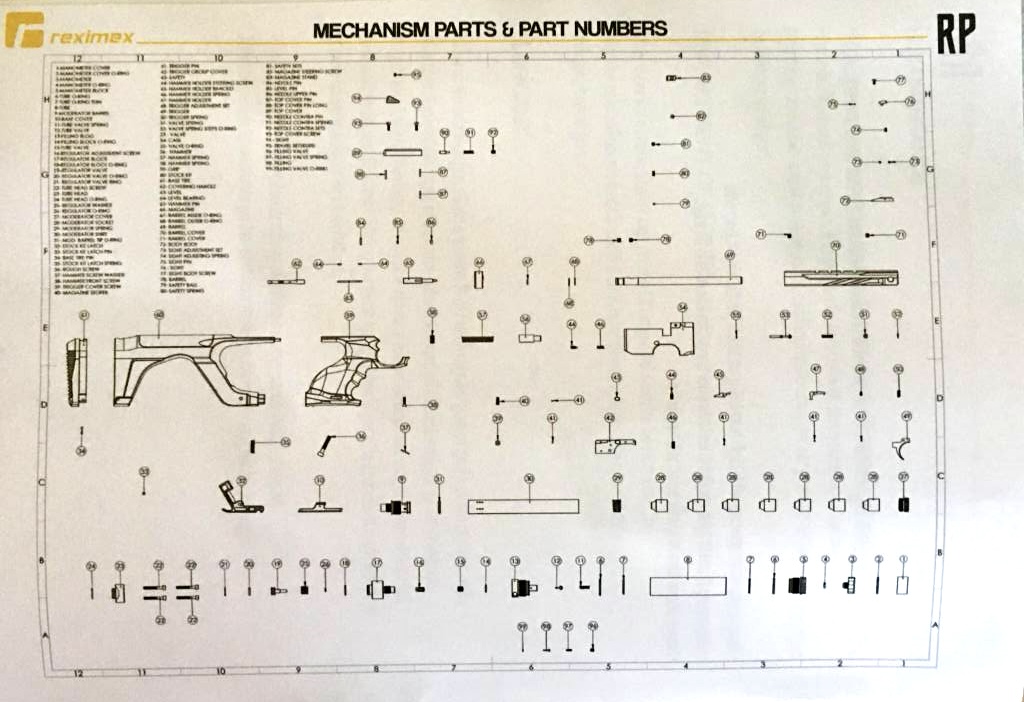

First time I disassemble a rifle i take a picture before I remove each part. Usually don't need them but when you do it is helpful. Hardest part is figuring out which screws hold what parts on the gun. Only real fine detail are trigger assemblies. They can be a pain.

Yup I do this. I also lay everything down in order so it looks like a schematic.
Unfortunately Reximex doesn’t provide them as well as other manufacturers. It’s one good thing Snowpeak has going.

Always takes me a while to mentally convert that 2D printed image into the 3D image in front of me. I like that parts list and wished more did that too.

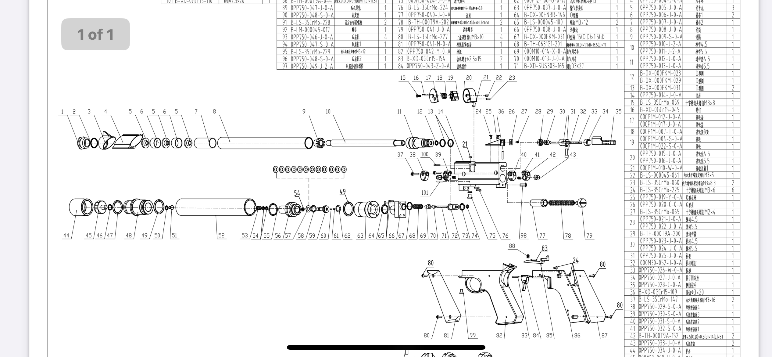

actually I found a parts list and diagram for the reximex rp on pyramid air and it even had prices for the parts..it was really hard to find, don't know if I can find it again.. but apparently pyramid air sells pretty much all the parts, some you have to buy a assembly, like the regulator,or sights..

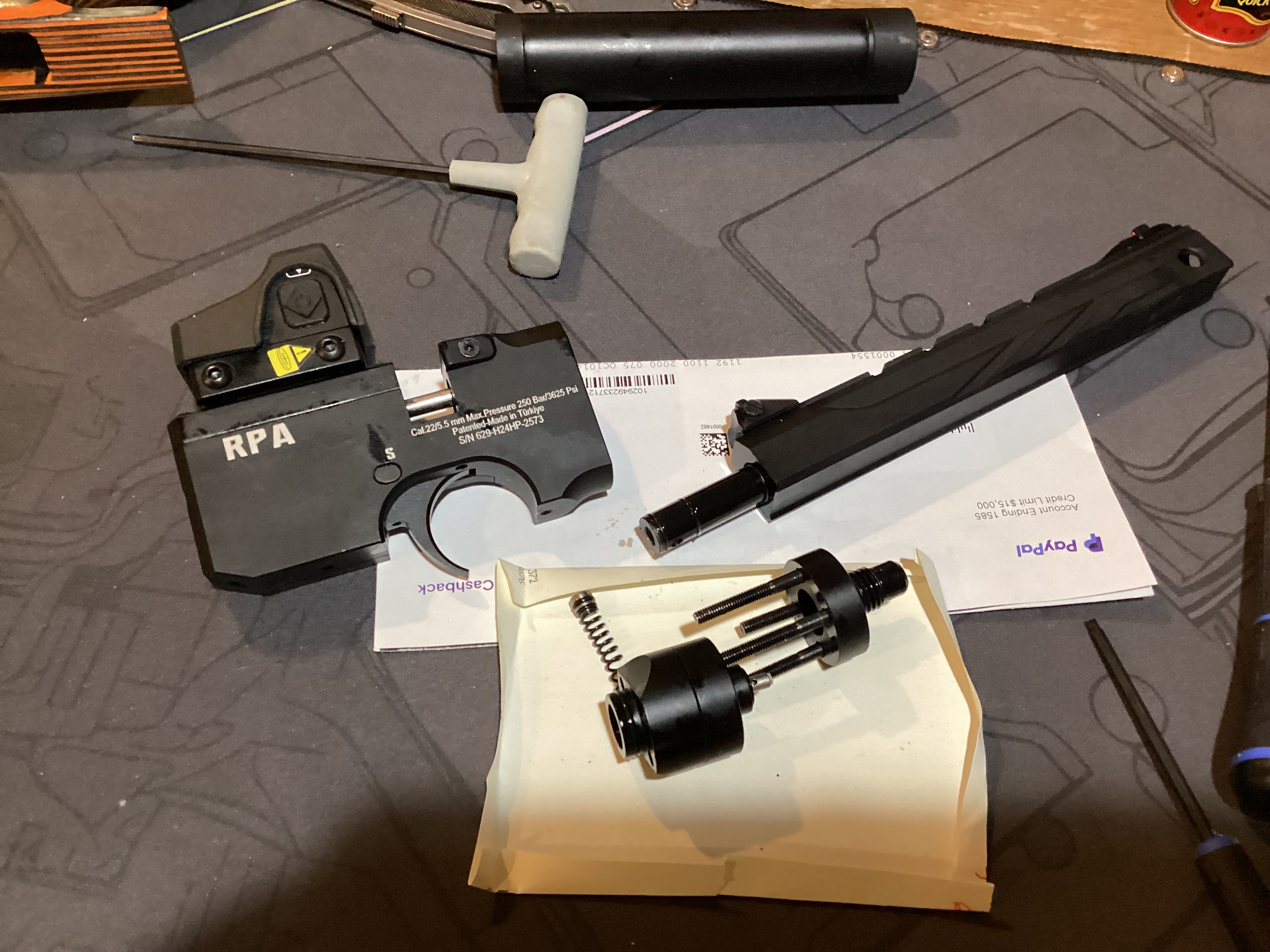

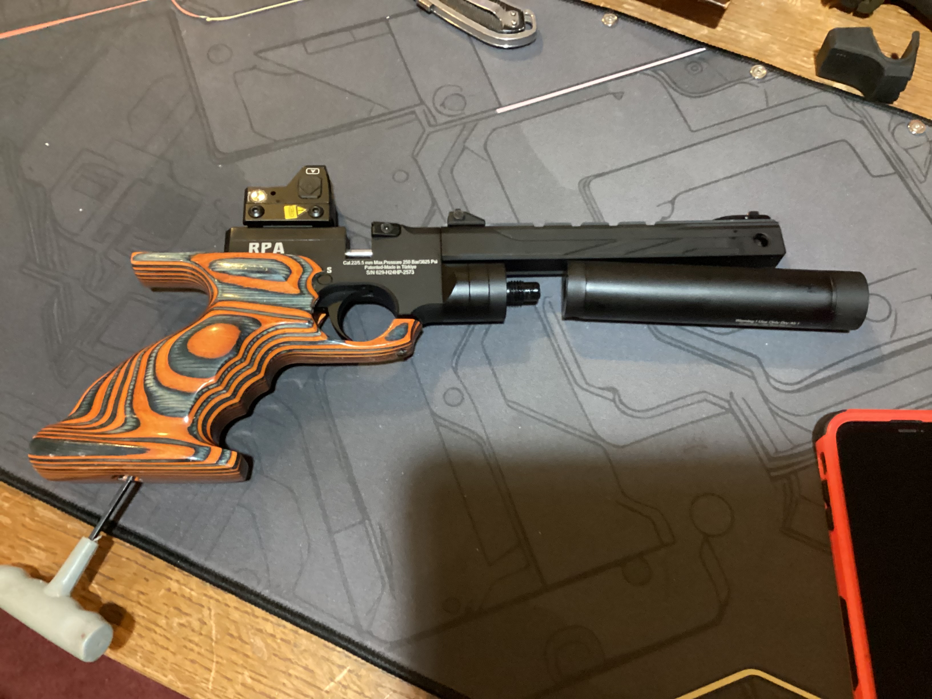

Took my intermittently leaking rpa apart the other night to see what makes it tick.
Nothing noticeable but have to do again , this time replacing o rings.View attachment 547681View attachment 547682
can you spot where exactly does that leak air from ?
because the air-tube connection to regulator has a very very intricate design, and that is the place most prone to damage o-rings.
there must be a vertical hole on the tip of the regulator, where it goes into the air tube.
if that hole has some sharp edges, it might have damaged the internal o-ring, just enough to leak intermittently.
(when we are talking about o-rings in these kind of intricate designs, in such small geometries, carrying those kind of pressures; even tiny micro-scratches might matter.)
