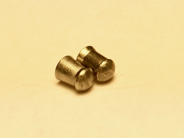

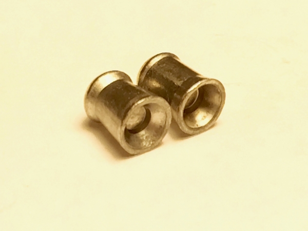

The change of pellet shape from old to new is obvious, but the skirt of the redesigned Monster looks identical to the original. The redesigned tin of pellets I sorted seemed a bit dirtier than the original design tin I sorted, as my fingers were dark gray by then end of handling 400 pellets one by one.

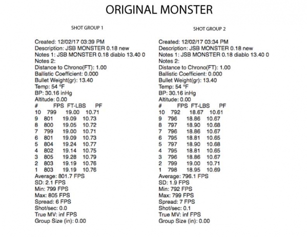

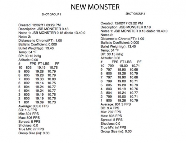

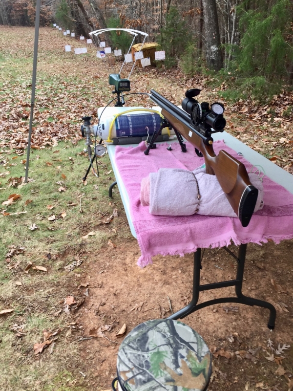

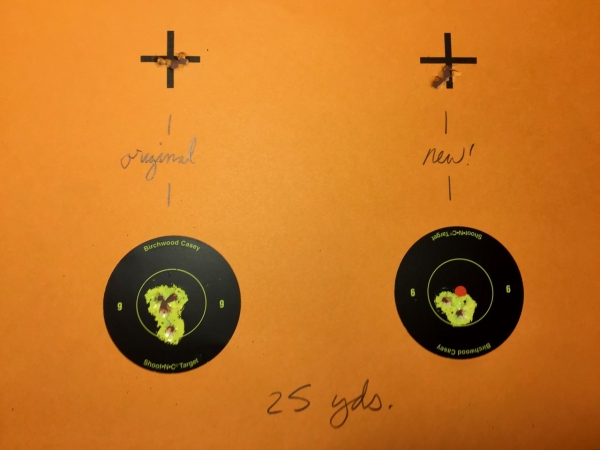

Off to the sight in range! Weather was overcast with practically no wind and temperature around 54°. I'm testing these pellets with a non-regulated Gen 1 Marauder with a LW barrel, from a table with a bipod attached. My scope is a UTG 12x, and I did not adjust or click my scope in any way during this test. My Marauder is tuned for Hunter Field Target 20FPE. I recorded the velocity of each shot of my groups shot at 55 yds. Before shooting each group of pellets I filled the gun to 2700 lbs. First I shot a small group at my 25 yd. zero with each type of pellet. As you can see, the original Monsters were on zero, and the new designed Monsters shot a bit lower- about 1/4" lower. I noticed the new design pellet fits a bit tighter in the breach than the original.
At 55 yds I filled the rifle back up to 2700 lbs. for each group. I shot two, 10 round groups of each pellet design at 55 yds. As you can see, my best group from the original design pellet was slightly better at 7/8", but I had a couple of fliers that I can not explain. The redesigned Monster group was 1".
The velocity from each group was similar and I didn't see a big difference there.

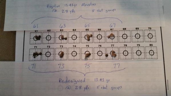

It was really too windy for testing today and I shot these from the bench , with bipod and rear bag. I just don't have "Dead Eye's" skills ;-)

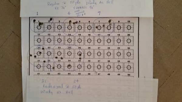

I couldn't tell much difference at 28 yds? But when I took it out to 50 yds the redesigned groups were so bad I stopped after the second group.
KZ is 1/4" and the squares are 5/8". I've shot much better on a calm day.
1541181456_13049753845bdc9010f021b8.97491410_45347944_2243843378960629_3263024420142186496_n.jpg
Like I said, when I took it out to fifty, the wind was just too much to deal with. Top three groups are the regular and bottom two groups fell apart with the redesigned? Don't know if resizing them to fit had anything to do with it or not? Oh well, I tried?

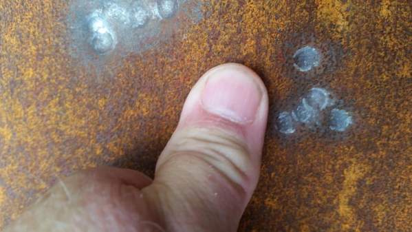

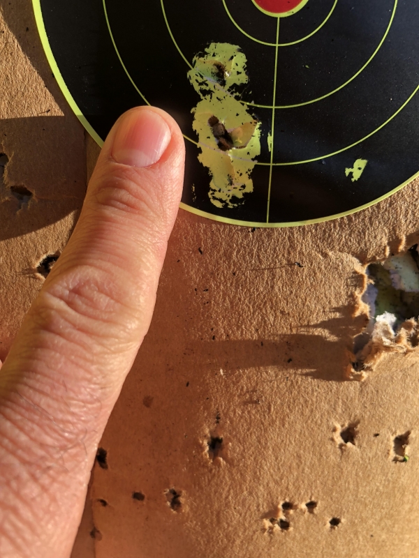

On a good note earlier this morning in dead calm I tried three 5 shot groups at 50 yds with my .22 Cricket Bullpup. First two groups on either side of my thumb were ok, but I wasn't impressed. It's shooting the 18 gr JSB's at roughly 930 fps.
1541182000_19256156715bdc9230cbe456.97247534_45267299_2243656508979316_5311969599837700096_n.jpg

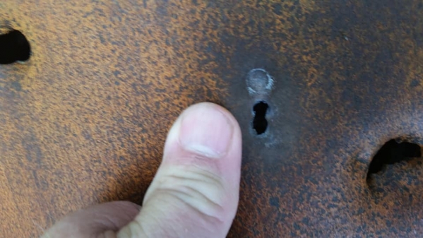

Then the next pic (3rd group) doesn't look like much, but there's actually 4 pellets stacked in that little hole with the 5th shot flying just above. When the pellets stack like that they always punch through the metal drum at 30+ foot pounds. That would be my best ever 5 shot group at 50 yds with .22 Cal Kalibrgun Cricket pup.
1541182096_12529876715bdc9290cf17f2.38791693_45288600_2243656598979307_6540207096896421888_n.jpg
So sometimes the stars align here at Camp Fussell and it actually looks like I can shoot???? LOL
