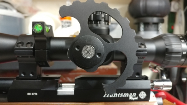

I wanted to do the same thing and was having the same problems. So...I cut the focus wheel in front of the minimum setting and after the maximum setting...worked great. Plenty of wheel to focus and room to install the magazine throughout the focus range.
