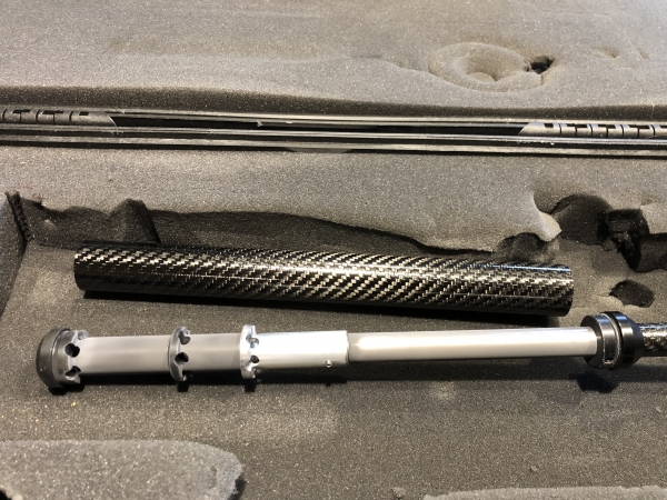

    RAW 50 ft-lb, .25 cal LW Rifled shroud:
    1544823148_19856889215c14216c8ec903.09063299_5390C0BE-8CE9-4E5C-9BAE-2F74FA51F8A8.jpeg
    60 ft-lb version looks identical to the photo above, though the lengths are different. The OAL of the 60 is about 1” longer than the 50 fpe version. Both of mine are ‘centered’ like your 50 fpe version. I think the difference is the CFOS design-which is a larger diameter than the centered version.
    I would say they are just ‘different’ designs. I don’t own a CFOS but my buddy does-they don’t sound notably different from what I recall from hearing his gun's muzzle report.
    Hope that helps? Per "what is supposed to come from the factory", everything looks like its correct to me.
    Yes, there likely are more efficient designs on the market...
    Sean
    Hi ,
    My CFOS Moderator from RAW is also empty and it’s designed as such. It has a low pressure and high pressure chamber and that’s it (same as pictures above). Believe me this does quiet down the gun as if you shot without it it’s very very loud. Remember Martin is not in the silencer business he is in the rifle fabrication business . DonnyFl is a silencer affectionado and his products show it.
    Hope this helps but you Moderator is not missing anything it’s how it was designed.
