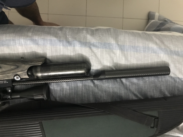

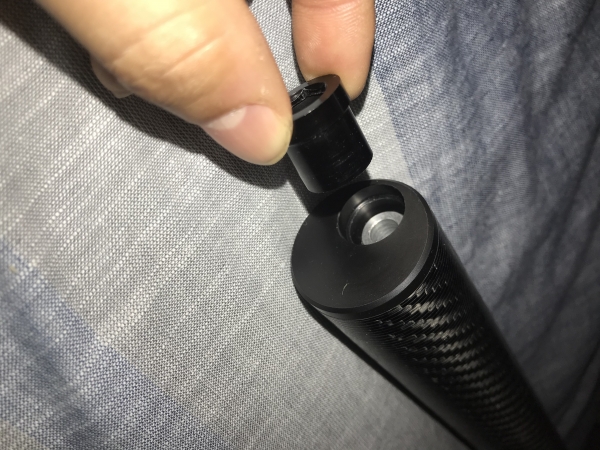

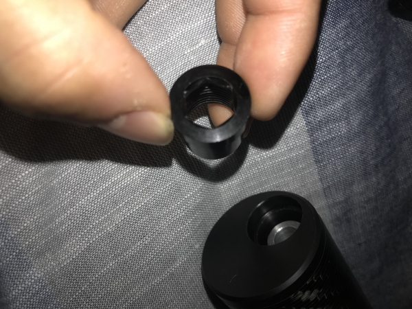

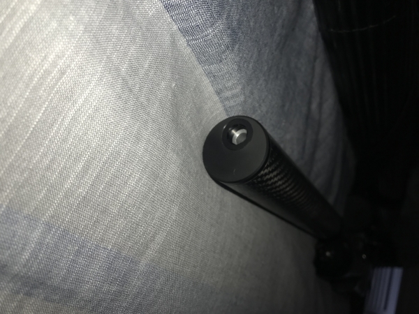

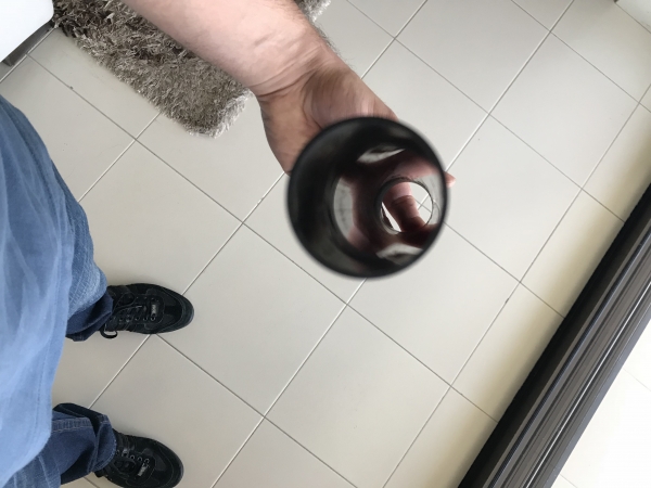

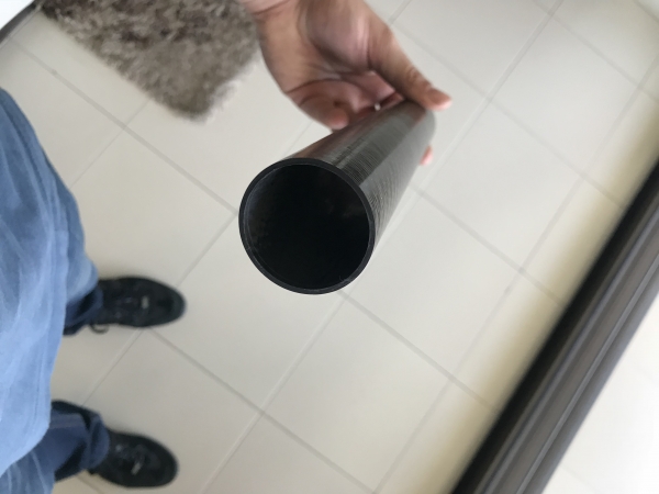

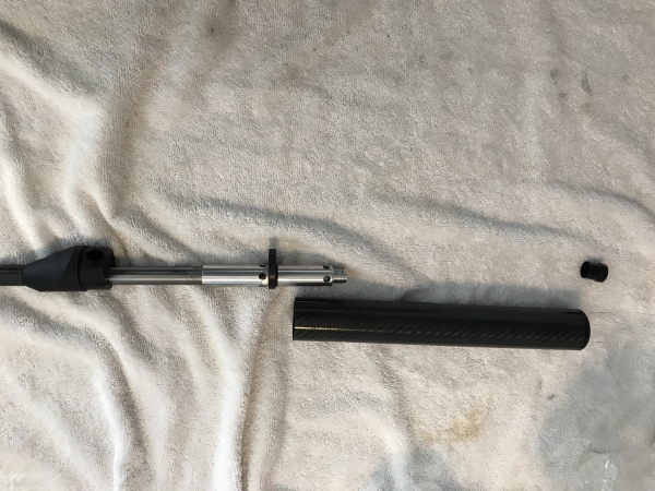

Me niether my friend, i am a RAW fan but this time i dont know what happened!!! it is incredible that a 60fpe rifle came to me with an empty suppressor.... i will search some pictures and will post them here.

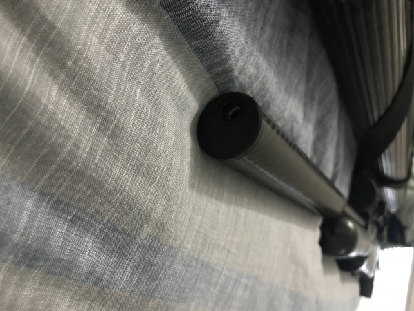

This is what i recieved.....if you check, therer are no baffles....If you have the minimum knowledge of airguns, we all know that there is no way to silence a 60fpe rifle with a "suppressor" like this.......
Raw is a good company, but I understand that you purchased and pay for a new polygonal LW barrel with suppressor, but RAW delivered and you received the barrel but the suppressor is only an empty tube/pipe, that's not a suppressor is a fake. I think Raw must attend several cases about the same problem, I'm sure they will solve the problem because this compromise they good will.
The internals of that suppressor look like the other photos of all suppressors I've seen on RAW guns-nothing out of the ordinary from your photos. They do not come lined with felt, etc and do not have many internal baffles, etc. I believe it is a 'tuned' design. I'm trying to be honest about what I see from your photos-so please don't get upset with me about that-just being honest.
Now, having said all that, I don't think many would claim that the RAW suppressors are overly efficient in their ability to quiet down the muzzle report. That is why, paging through the 'RAW Report' thread, you will find MUCH enthusiam for people looking to have a DonnyFL fitted to their RAW (which can be done, BTW).
Moderators made by AZ, on the other hand are VERY efficient, as are the DonnyFL units.
I'm just trying to help clear up that you were not delivered a 'defective' product from RAW or SPAWeapons-these are how they come. The one aspect of RAW's that most of us don't 'rave' about is the efficiency of moderation. Sorry to break that news to you-I'm sure you expected better from a very expensive gun, so I understand your disappointment in that regard.
I'm going to go through the RAW Report thread and find the photos Pat posted of his disassembled RAW moderator and post a link here for you to view those photos as well. Stay tuned...

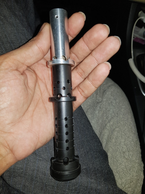

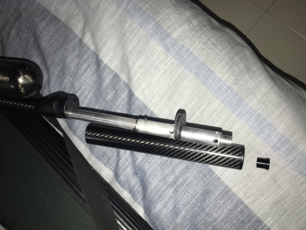

This is the picture of my original LW .25 barrel suppressor..... this one have baffles.... now you can compare this suppressor to my new "suppressor" on my polygon barel!!

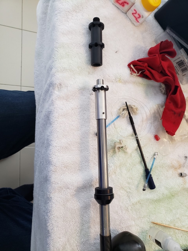

Interesting-thank you for sharing the photos. I also have both barrels (.25 cal LW ‘rifled’ and .25 cal polygon). Do the end caps just pull straight off the end? Maybe I will pull mine apart to see the differences also? I would like to follow Umair’s lead on improving the design. Or perhaps follow your lead by swapping parts...
