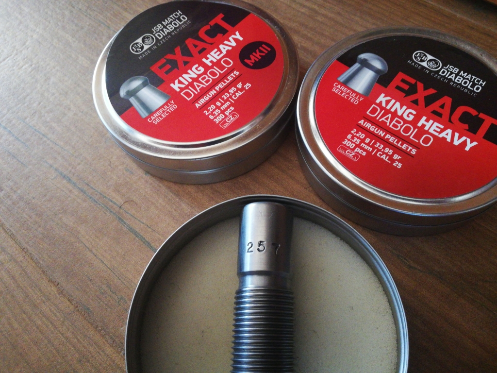

I started a post years ago with the tinbum pellet sizer from krale that I bought to resize the JSB King Heavy mkI. Now there are some accuracy results at 50m (5shots each) done with my good old FX Bobcat mkII .25. if the weather calms down I’ll do some test at 92m.

Very good precision with recalibrations. What size do you use? I use a LEE 257 But I'm thinking that a 258 would give me better results

yes absolutely, didn’t expect that out of such a cheap resizer.
in .25 they where only available at 6,35 when I bought it. don’t know if they have stocked up there sizer in .25.
ive measured with a cheap caliper, the originals are 6,66 and the resized ones are 6,35 now.
do u have a press for your sizer? Looks really professional.

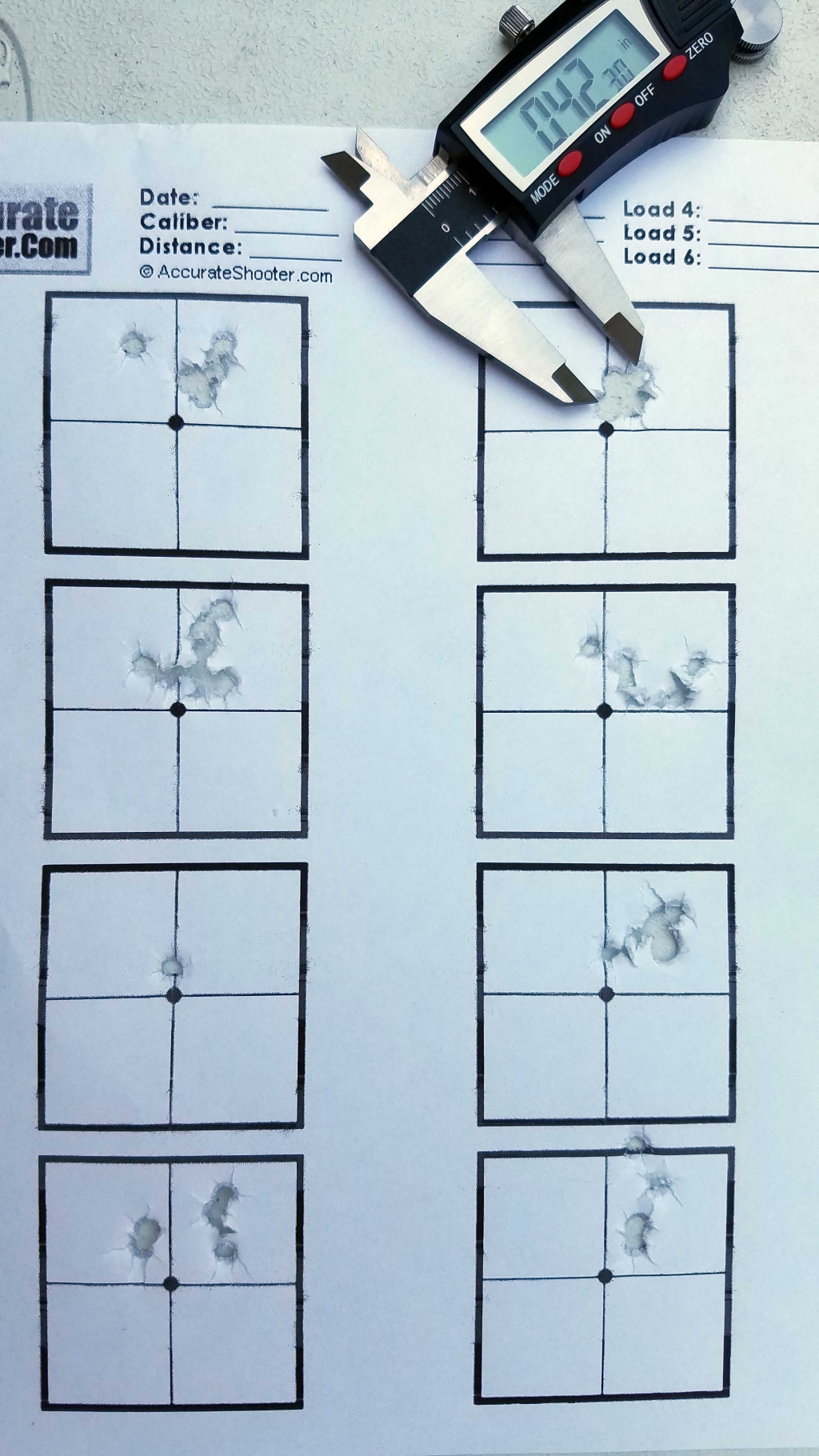

The left row is all un-sized and the right is sized to 6.35mm. Nothing conclusive just yet. I had a hard time seeing the little black dot at 52 yards with the sun glaring right into my lens without a sun shade Plus, I got off target I see with my counts. I'll try again in better conditions. The winds were 6 MPH. I do like that I was able to drill one hole with sized MKIIs. That was when a cloud came over and gave me a break from the glare so I could see better, but still want to see more testing first. By the way, this is with a 600mm Impact stock barrel. The tune is above. Also may need to slow it down some or speed it up.
Doesn’t look that bad at that conditions. Maybe give it a try at a really calm day where everything is perfect. The mkII are really working good out of ur rifle as I can see! 👍🏻
speedwise u can do it just with the power wheel from min to max to see what works best. With my Bobcat it works at 835. Impact may be different.

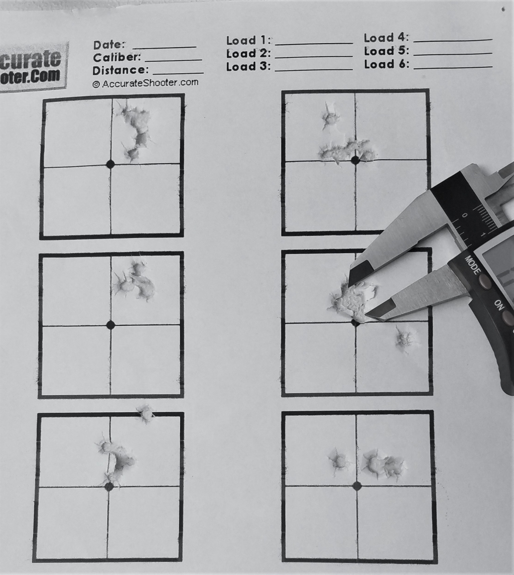

Looks like I am going to need a bit of luck with the MKIIs. These are three more groups each to finish off the tin with half un-sized on the left and half sized to 6.35mm on the right. 5-shots each this time, Lol with no sun glare on the scope at the same 52 yards. The individual quad squares are 1" for reference. I didn't change the tune. I just left it as it was from the first groups. I'll slow down now and focus more on the tune and the harmonic balance for these. I think these are the first of groups I have shot officially with the MKIIs out of this new-to-me gun of two weeks now. The 25.39's are shooting so well I didn't want to touch it, but those that know me know I can't leave my guns alone for long, and the reason I wanted an Impact. I'll post back once I get these MKIIs sorted out. The groups aren't horrible, but I believe I can get them a little better than this. I am also questioning this HC magazine. The pellets are clearly not lining up with the exit hole. I am gonna have to do Glem's mag mod he recently posted to fix this....I'll also let the barrel lead up a bit. I did just clean it before testing...Thanks!

Well that could be really the right size for yours, cause I’m shooting them out of s Bobcat with a Standard ST Barrel. Spare orings are always great to have, if something’s feels weird change them and you’re ready to go again. 👌
