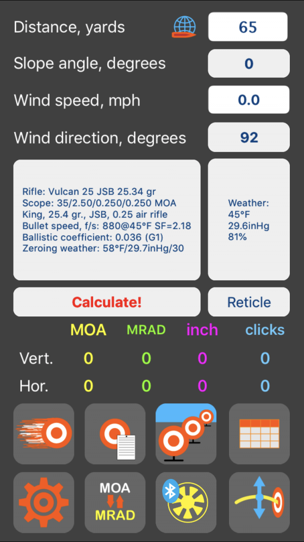

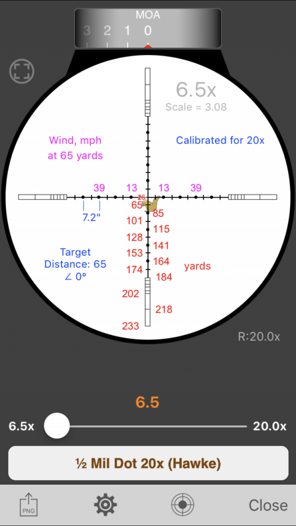

Thanks for be response. So if using strelok to determine hold over will it be accurate when changing the magnifications in the app. Or do you think where it says calibrates for 20x means I need to sight at 20x?
1524521267_11985164125ade5933163327.12479617_0DE74D36-6BA6-433A-BCC6-C6CD17BEE040.png
I am using strelok pro and there isn't anywhere to put the magnification you used when sighting in, it asked for lowest mag,highest mag and the power the reticle was calibrated at and that would be 20x for the OP.
