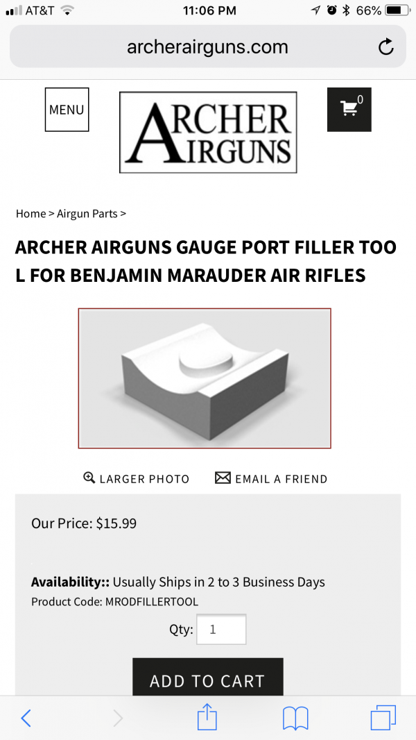

Buy this tool. It will save you orings and make your job a lot easier.
http://www.archerairguns.com/Gauge-Port-Filler-Tool-for-Benjamin-Marauder-p/mrodfillertool.htm

JMan, I have seen this tool posted on treads in the past. That link you posted up is no good. I would like to get this tool. Where else can I source this tool? Tried eBay, and nada. That’s as far as I got. Nothing pops up with Archer at all.
I just tried link and it worked fine. 15.99 for this tool.
