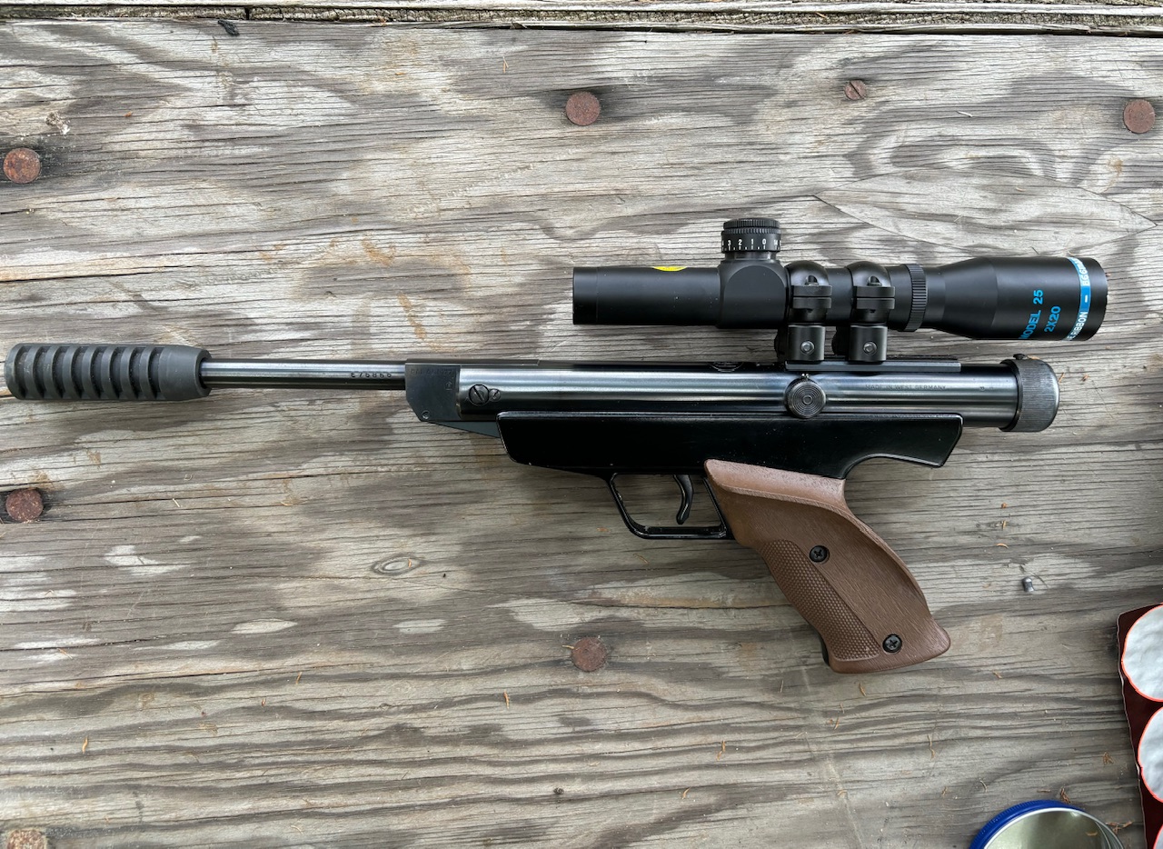

Diana Resealed my first springer!

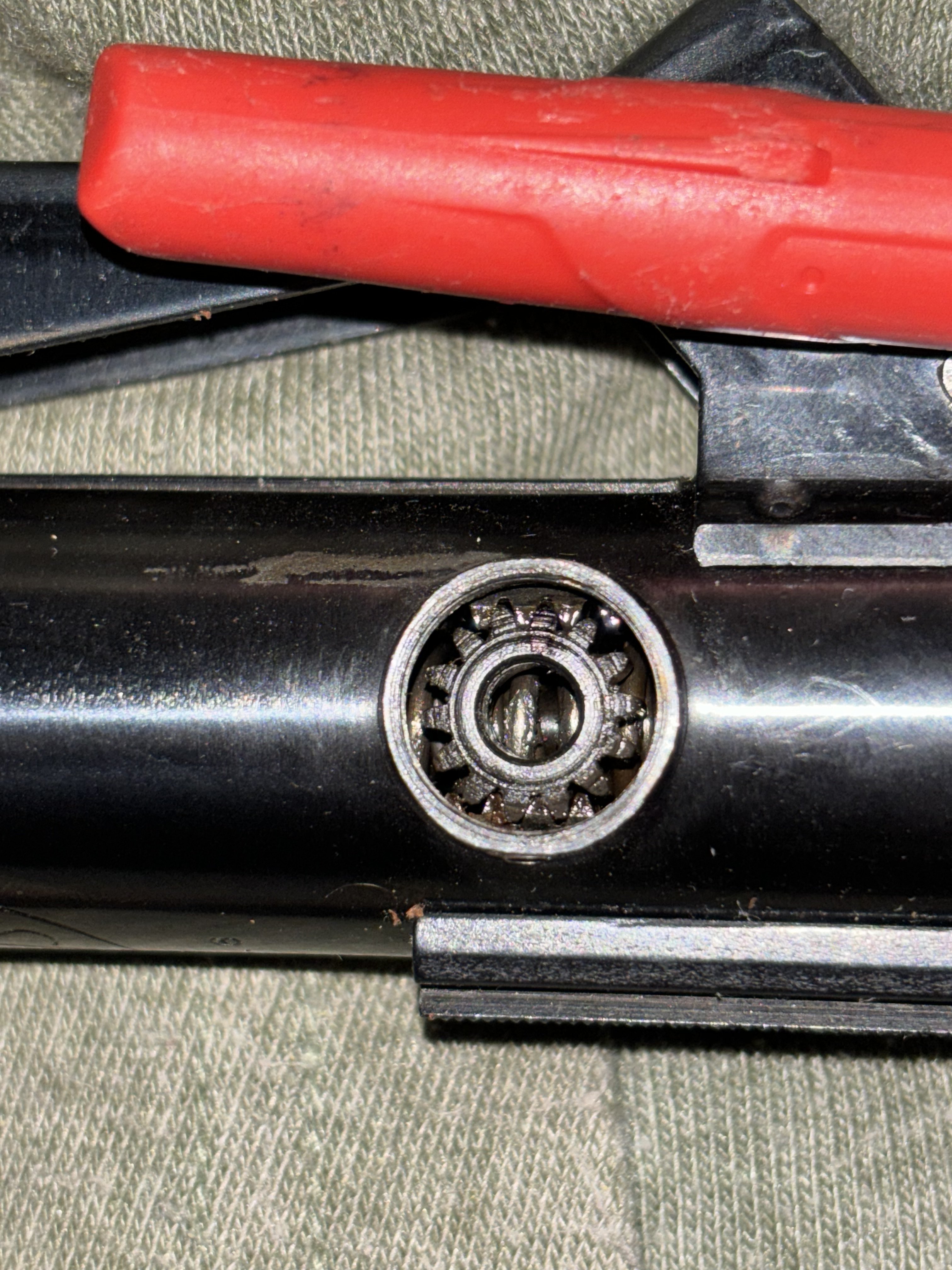

A while back I saw a post saying there was a Diana Model 6 for sale on eBay. Not many people were bidding on it, probably because it needed new seals. I ended up winning the auction for a great price. I bought new seals and researched how to disassemble this old gem. New seals came in and I started the disassembly. Came to a halt when I couldn’t remove the cog caps. Seemed like they were epoxied on there. Put it away for a few weeks as I contemplated sending it off to David Slade or trying to remove them with some leather and channies. Said to hell with it and was able to remove the caps without marring them. Luckily the cogs were in excellent condition.

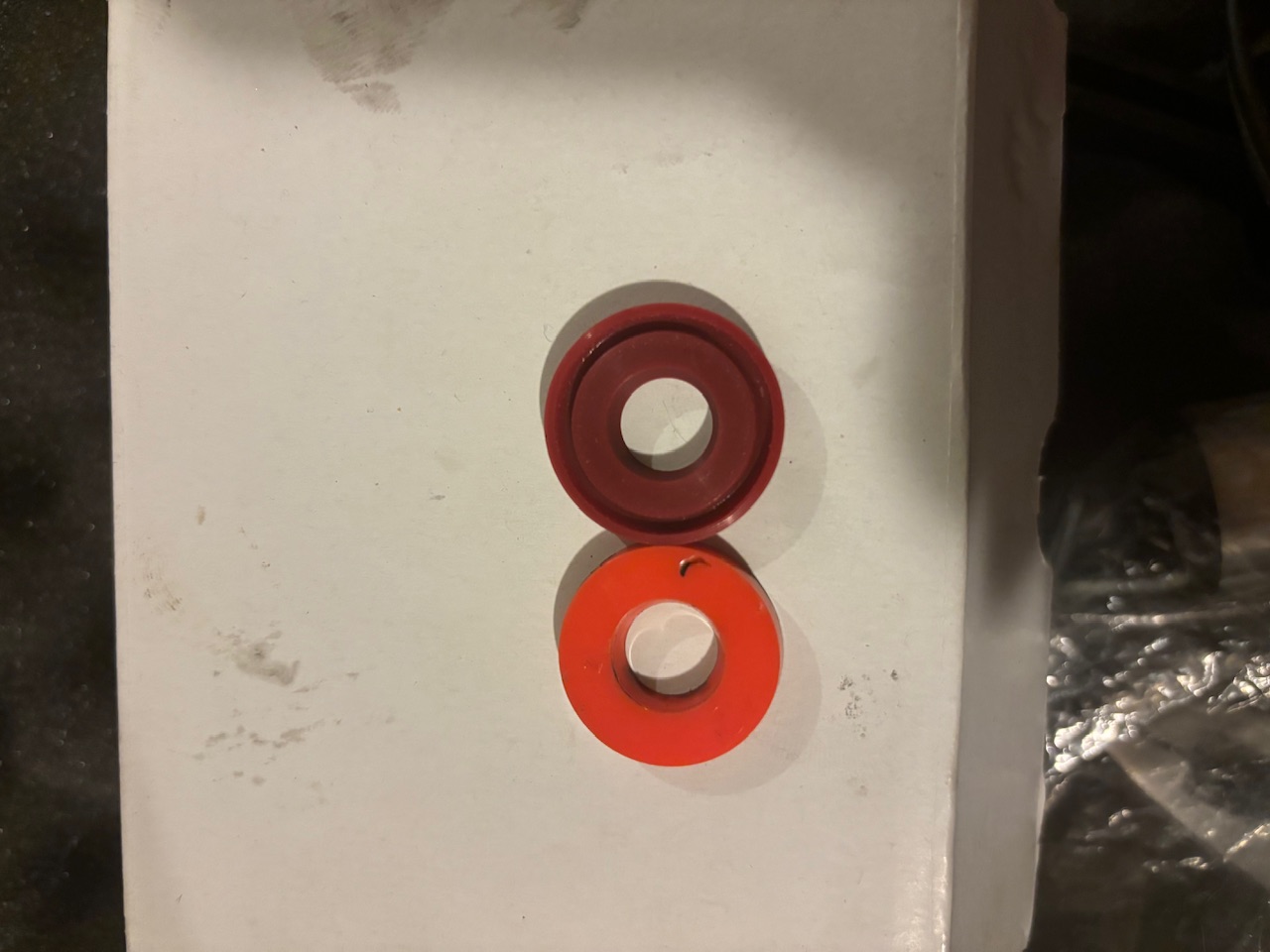

Next, I Jerry rigged an old dewalt clamp to be my compressor as mentioned in one of the tutorials. Removing the spring revealed a decrepit front seal that was stuck to the front of the tube. I let it soak in acetone then used a sharpened plastic cleaning rod to scrape it out. Smoothed out any sharp edges in the tube, replaced the seals, applied a little krytox and buttoned everything back up. The rear seal didn’t look too bad but I replaced it anyway. I noticed it doesn’t have a parachute like the new seal.

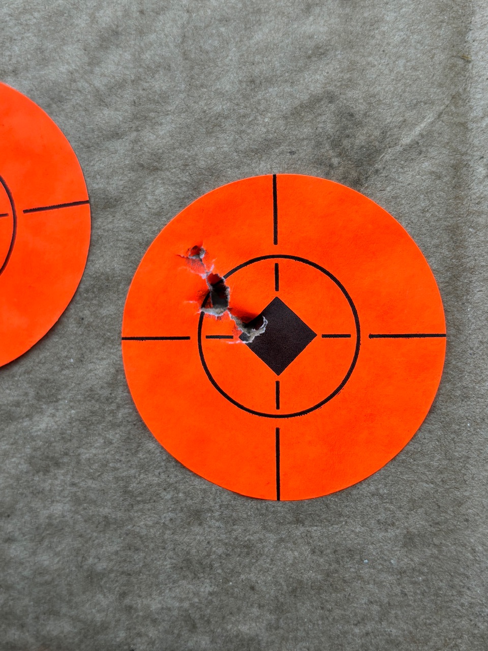

I dont have many .177 pellets on hand but it’s showing some good accuracy. I bet it could get even better with the right pellet. Here’s 5 shots at 15 yards with 10.3 JSBs. Shot off a split log.

the gear cap are easier to take off when you put pressure on the rear piston
that takes the pressure off the cap pin but they can be a problem

I was applying pressure to the spring but the cog caps were very hard to remove. Could not remove them by hand. The rear cap was easy to put back on I did it without the compressor. There was a shim there that was labeled 0.8 mm thickness. I used Motorheads advice on adjusting the rear cap. Worked like a charm. Thanks for not bidding on it. The price was right.

Your pistol is beautiful as configured.

Without the info you posted I would’ve been a lost. I like the iron sights on your pistol. For the range I’ll be shooting it is more appropriate on the pistol. Although, I have no complaints about the beeman scope that came with the pistol. It’s got some good glass.
