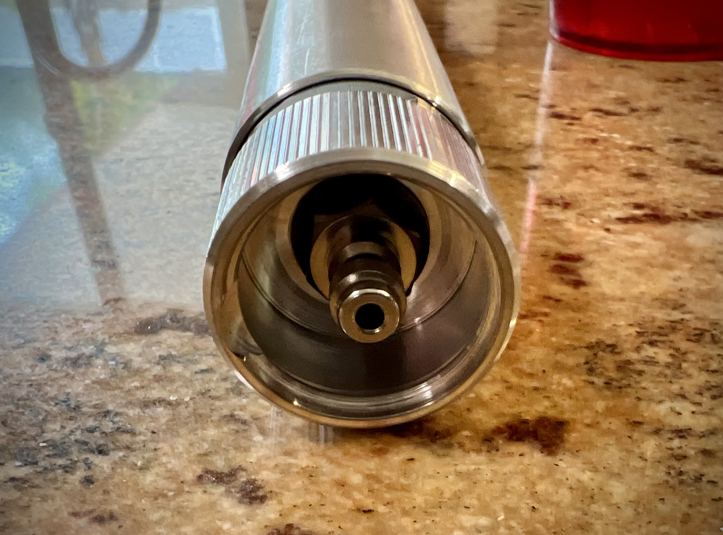

I have a p70 with a new cylinder but am curious about replacing the gauge at the end with a foster quick fill like the one in the attached link.
I have an old AirArms S400 mpr that was the same style where the cylinder had to be removed from the gun to fill. I took it to MAC1 back years ago and he removed the gauge and replaced it with a foster.
I don’t care about a gauge and refilling on the rifle is so much more convenient.

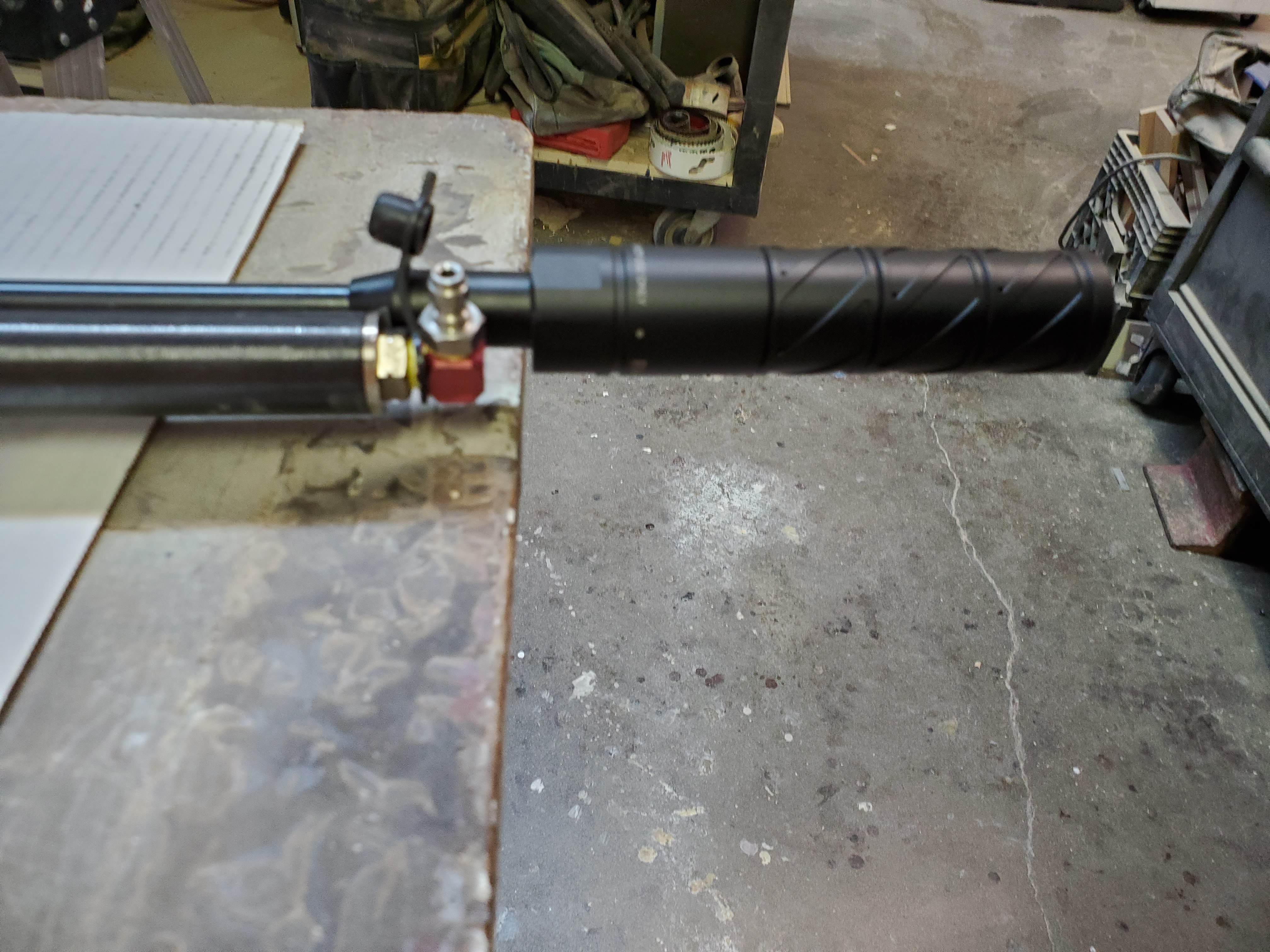

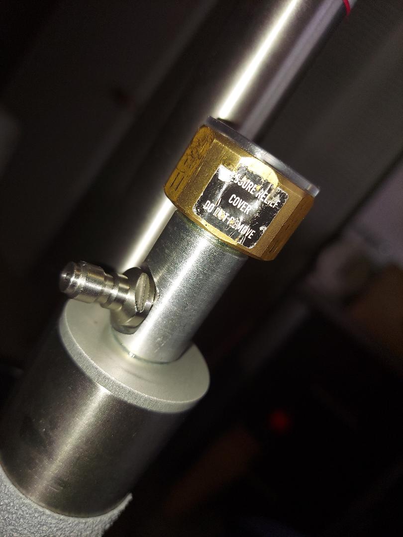

no different than ADDING a gauge and keeping a fill foster .... Just be creative with fittings while making sure threading & type match, engagement of threads & use of HP fittings.

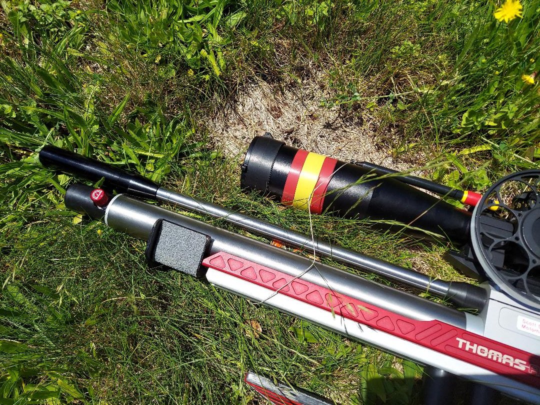

My THOMAS from a few years ago.
Beautiful setup with Custom Tee. Allows 3 different threads to exactly match available fititngs/threads. This is actually what I was thinking when I suggested a Tee. Just took for granted that I can identify the threads and machine parts.

The "T" in this case was a custom I fabricated using 7075 aluminum rod. ( Have a small machine shop at home )

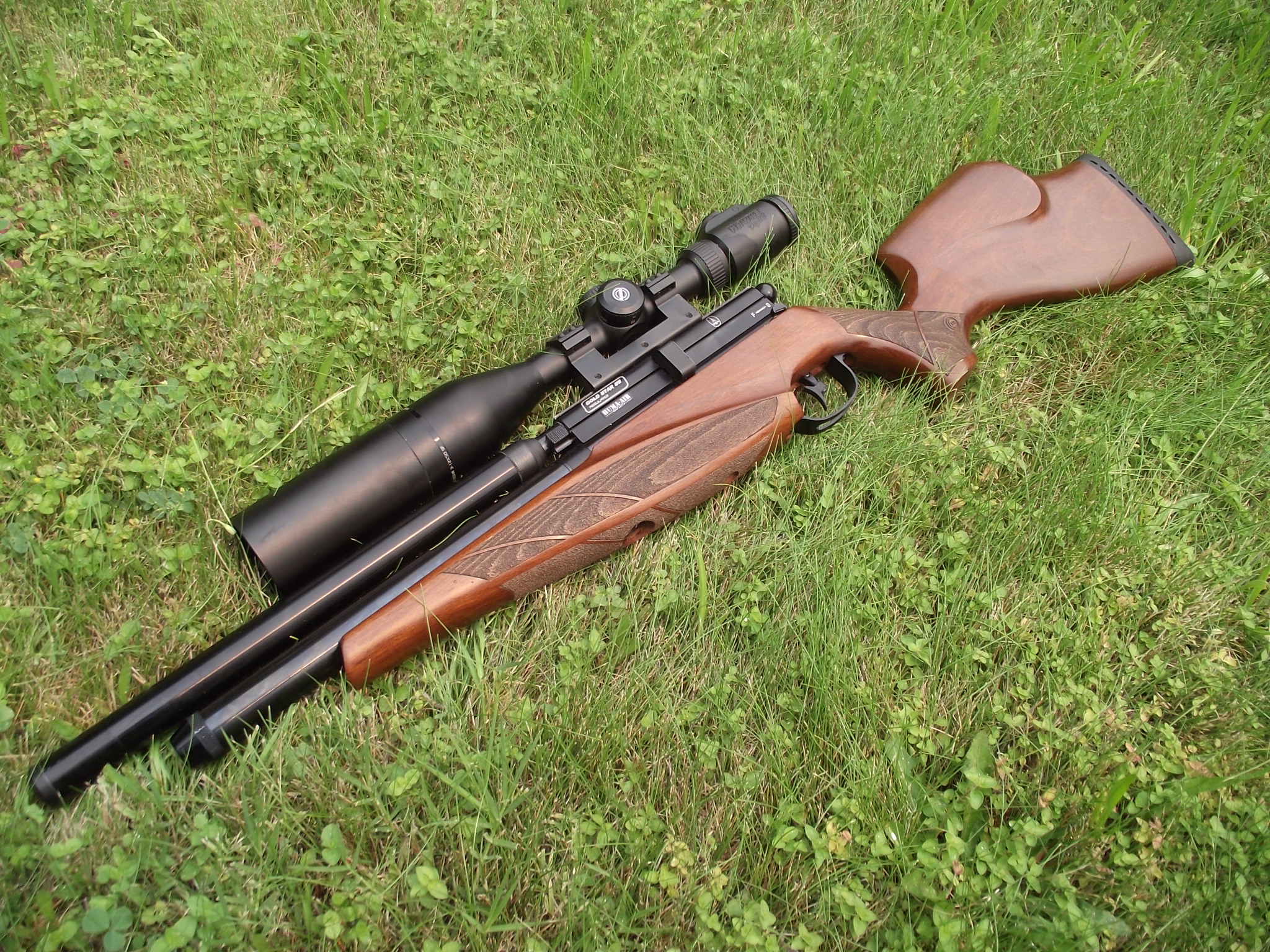

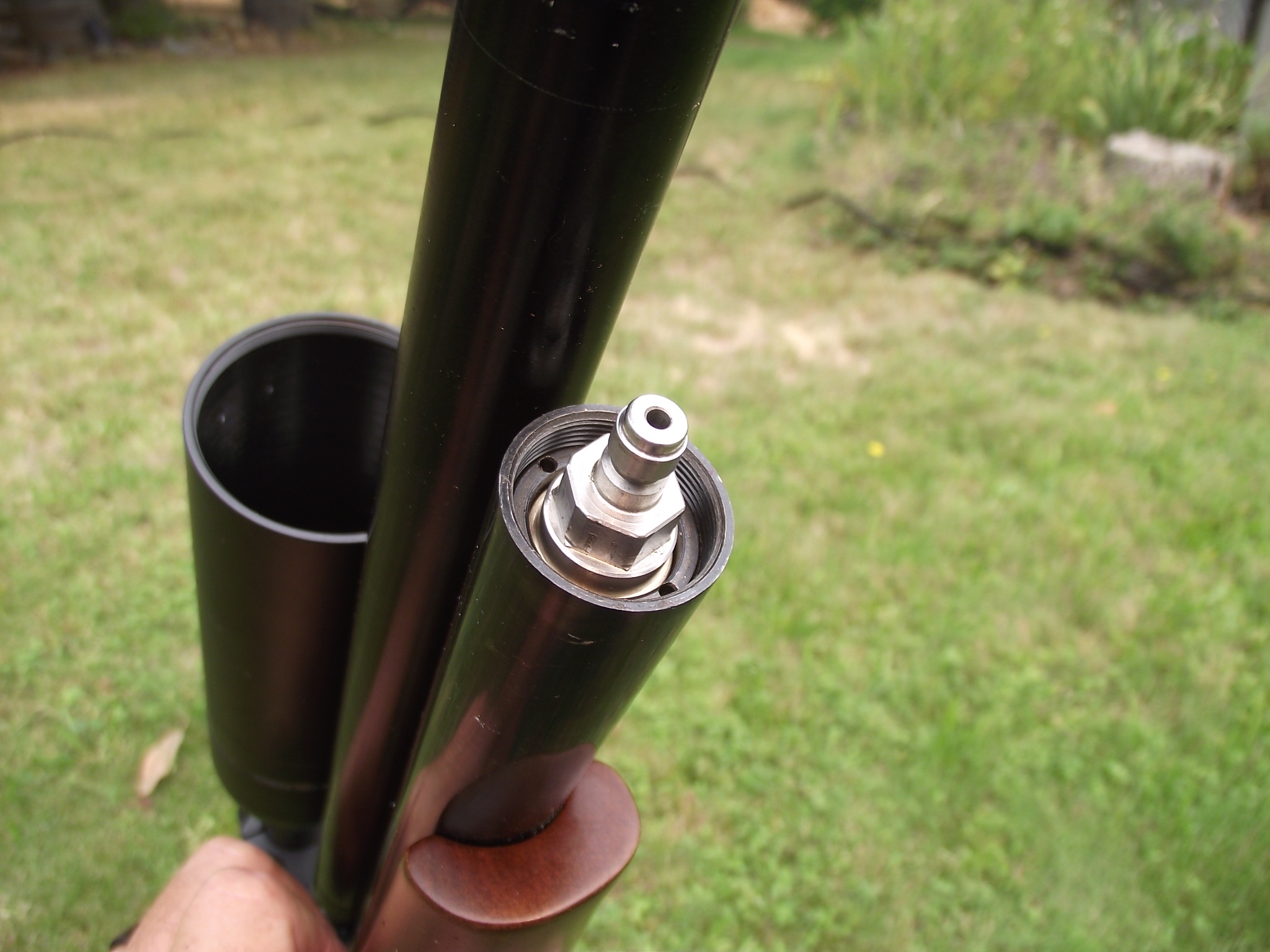

One can also ( In this case the probe portion of end cap on a BSA Scorpion ) machined it off then drill & tap for a foster.
In this modification it was solely to get away from a probe, but had rifle not had a gauge elsewhere, it too could have been T'ed as previous.
* BTW, the factory cover cap still fit.

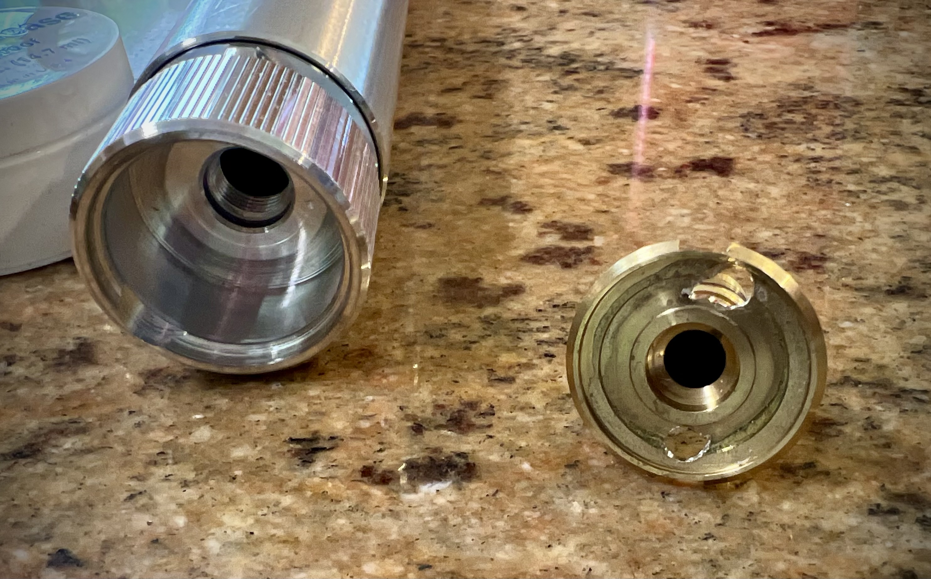

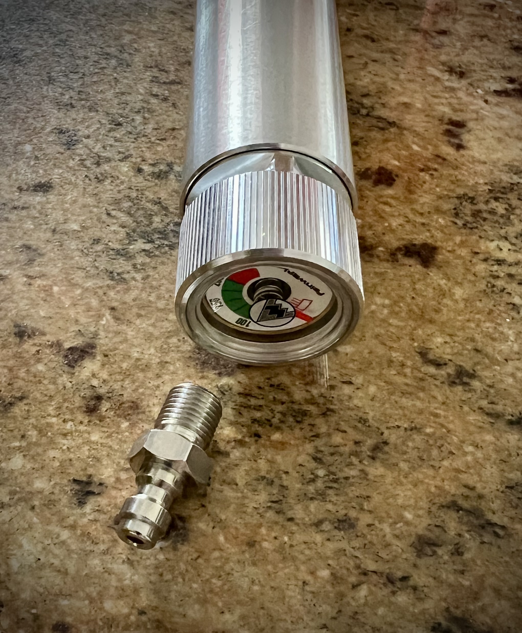

The issue with this is the end plugs on FWB cylinders are basically made to never come apart and if the do they are destroyed.

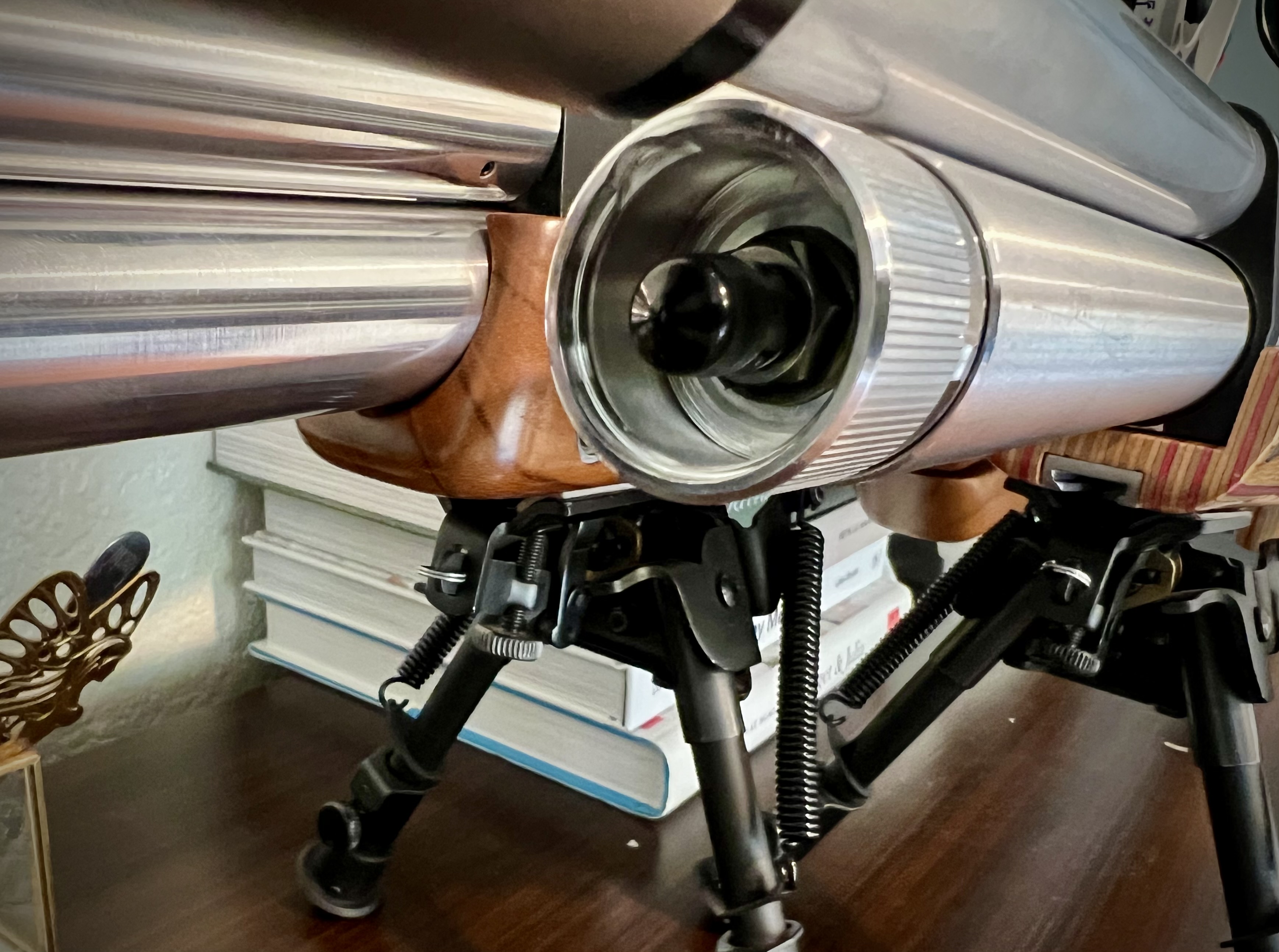

Went shotgun style and ordered three different fosters since I wasn’t sure on what thread it was.
The metric one threaded in and came with a dowty(sp?) seal.
Taking the FWB gauge out pretty much destroyed it. I was seriously sweating screwing up this brand new expensive cylinder.
Filled it up with 2k and seems to be good to go.🤞
