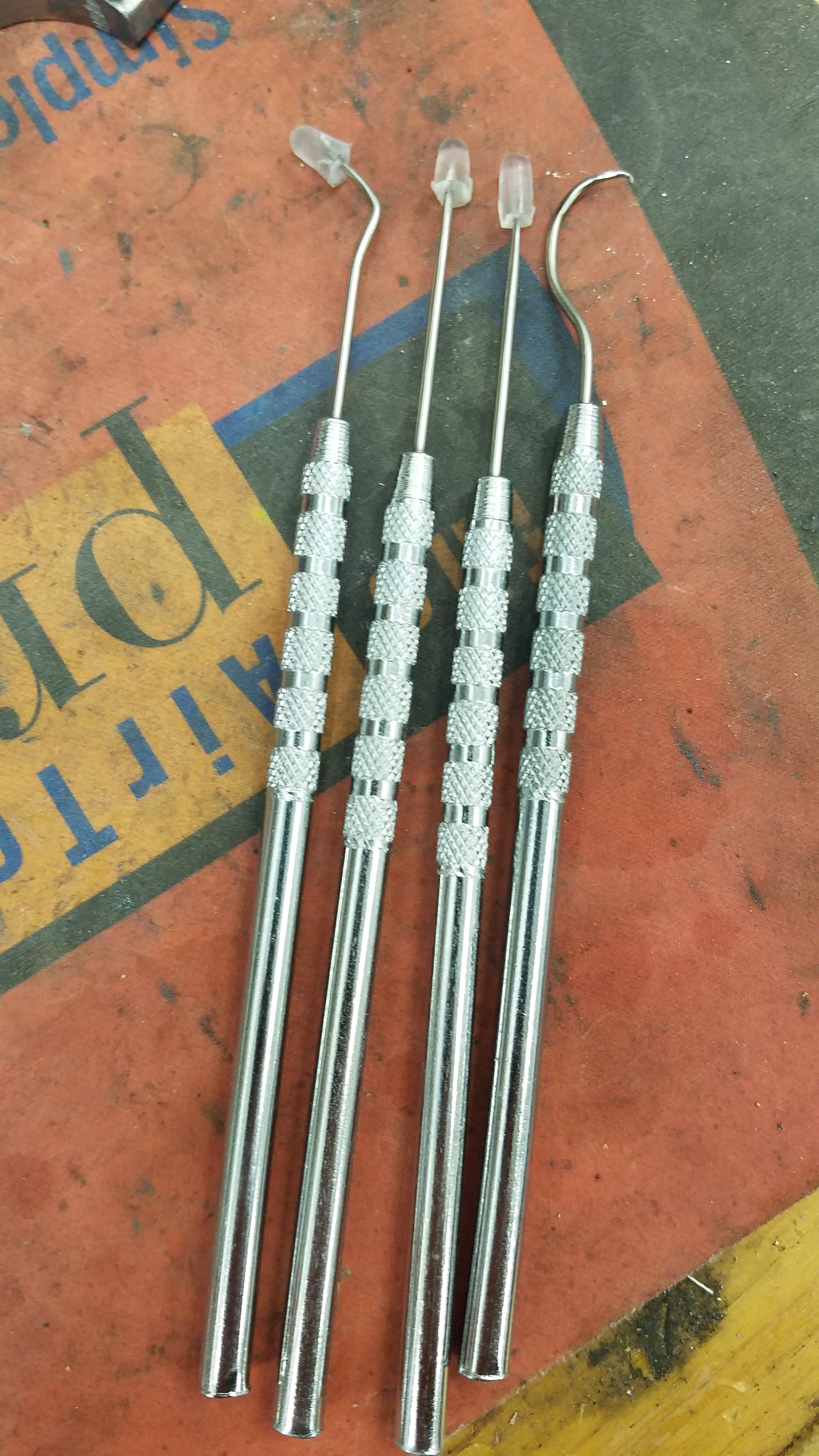

Harbor Freight sells this set of dental picks for about $3 that are very thin and soft. You can bend the tip in a slightly offset little U shape to reach in and rotate under the oring and pull it out without damage (after some practice). You might dull the tip slightly . I use a small Allen wrench to re-insert it. Much easier out of the rifle.rifle. Alternately, you can just stab it and pull it out. Have replacements on hand in either case. Bob
