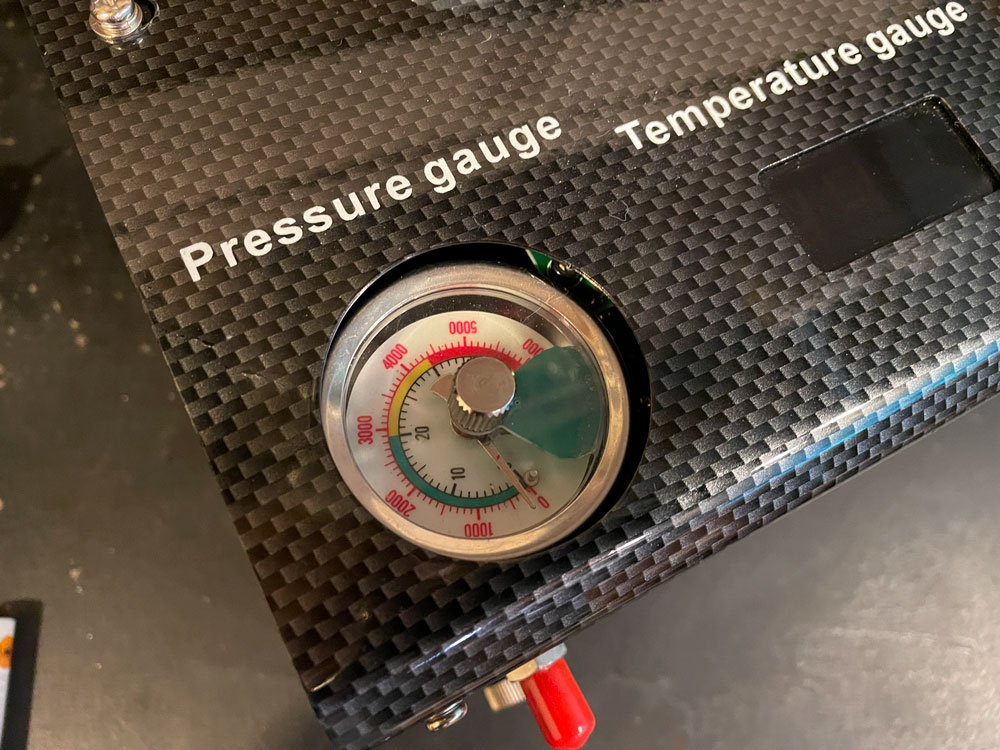

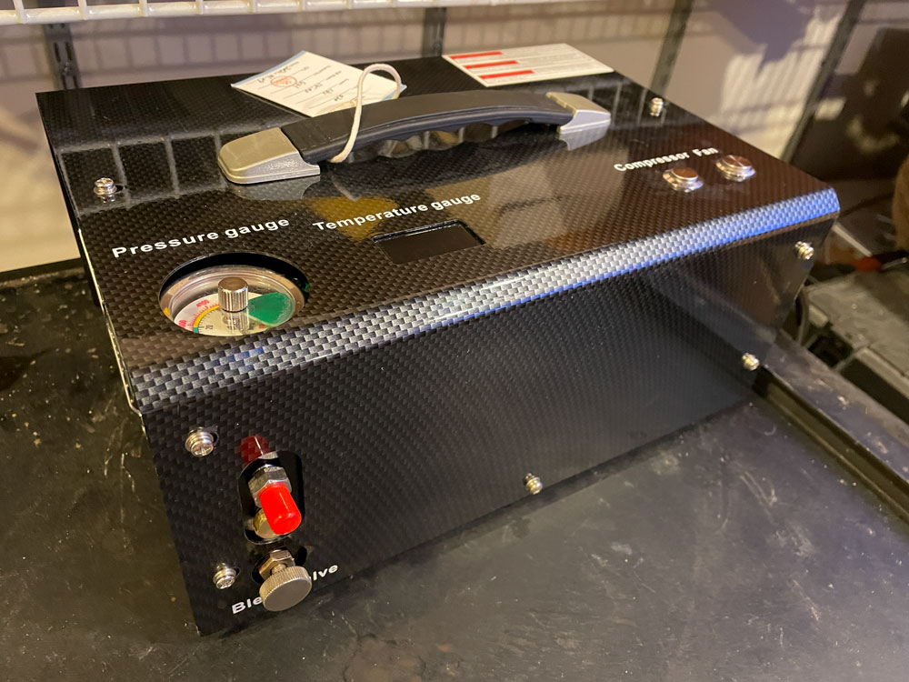

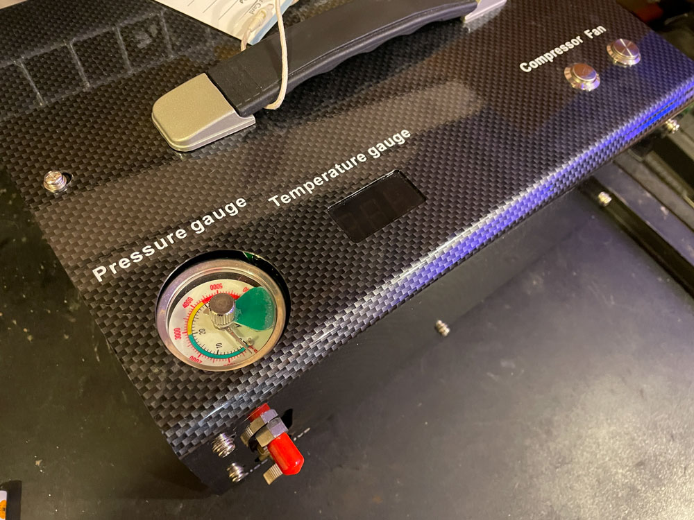

Hey there everyone, I'm hoping someone here knows what gauge I can use as a replacement for my PCP compressor see images below.
I'm not sure of the thread size. Is it M10*1 or M12*1.25. Any recommendations are appreciated.

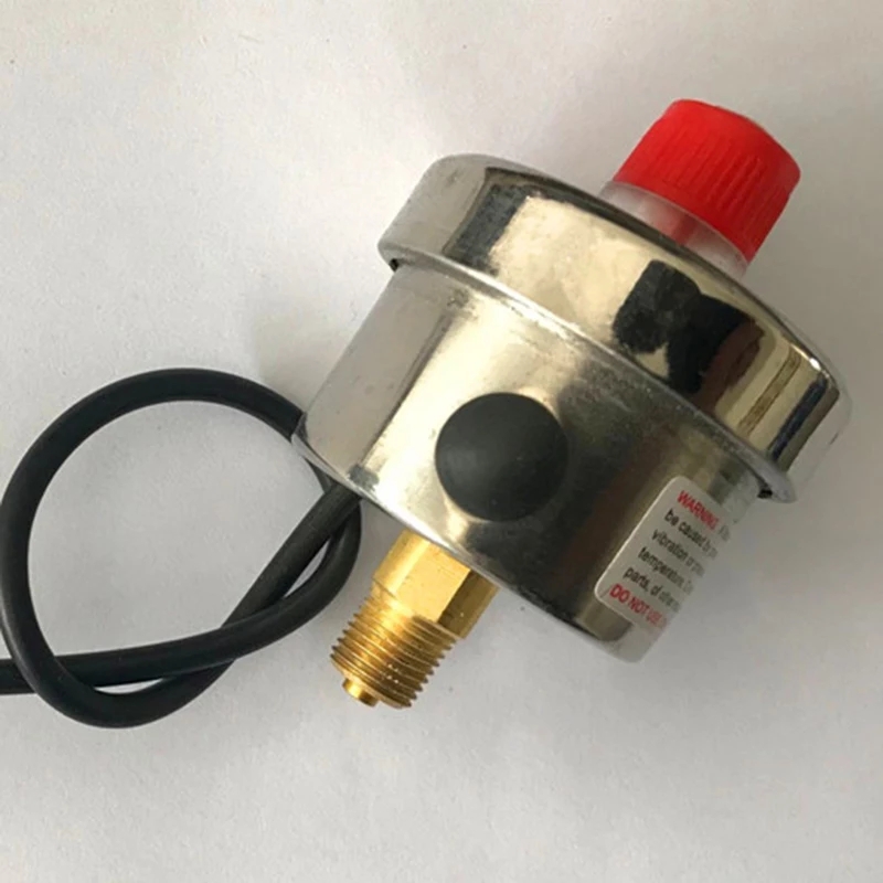

Should be easy to find once gauge is removed and inspected. Metric fittings on gauges are normal to find on the majority of the products found on Chinese made products including airguns. AliExpress shows several to choose from.
US $24.99 | Yong Heng Compressor Spare Part Set pressure Gauge for YongHeng PCP PUMP
https://a.aliexpress.com/_m0mbF5c
