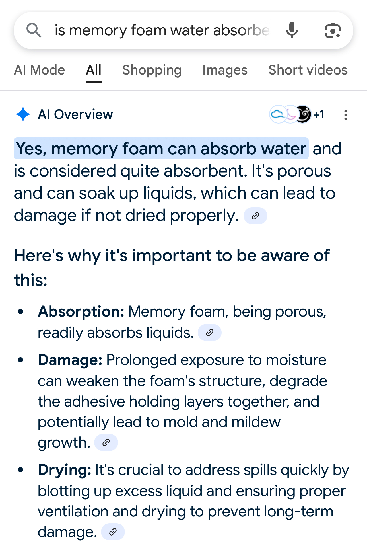

I’ve done the sandwiching guns between foam pads before. It can work depending upon the quality of your case and its sealing mechanisms and your environment. A thing or two to be mindful of when doing this:
1) look for gaps around the rubber gasket and/or hinges of the case.
2) be sure that you’re using foam that doesn’t absorb and hold moistur from the air.
Edit: After entering the question “Is memory foam water absorbent?,” here’s the first answer that populated.
I live in the humid south and learned quickly about squishing guns between sponge-like material in an enclosed case. i suggest looking into closed cell foam. If there‘s a memory foam like it, that would probably work. I imagine that it exists for bedwetters.
