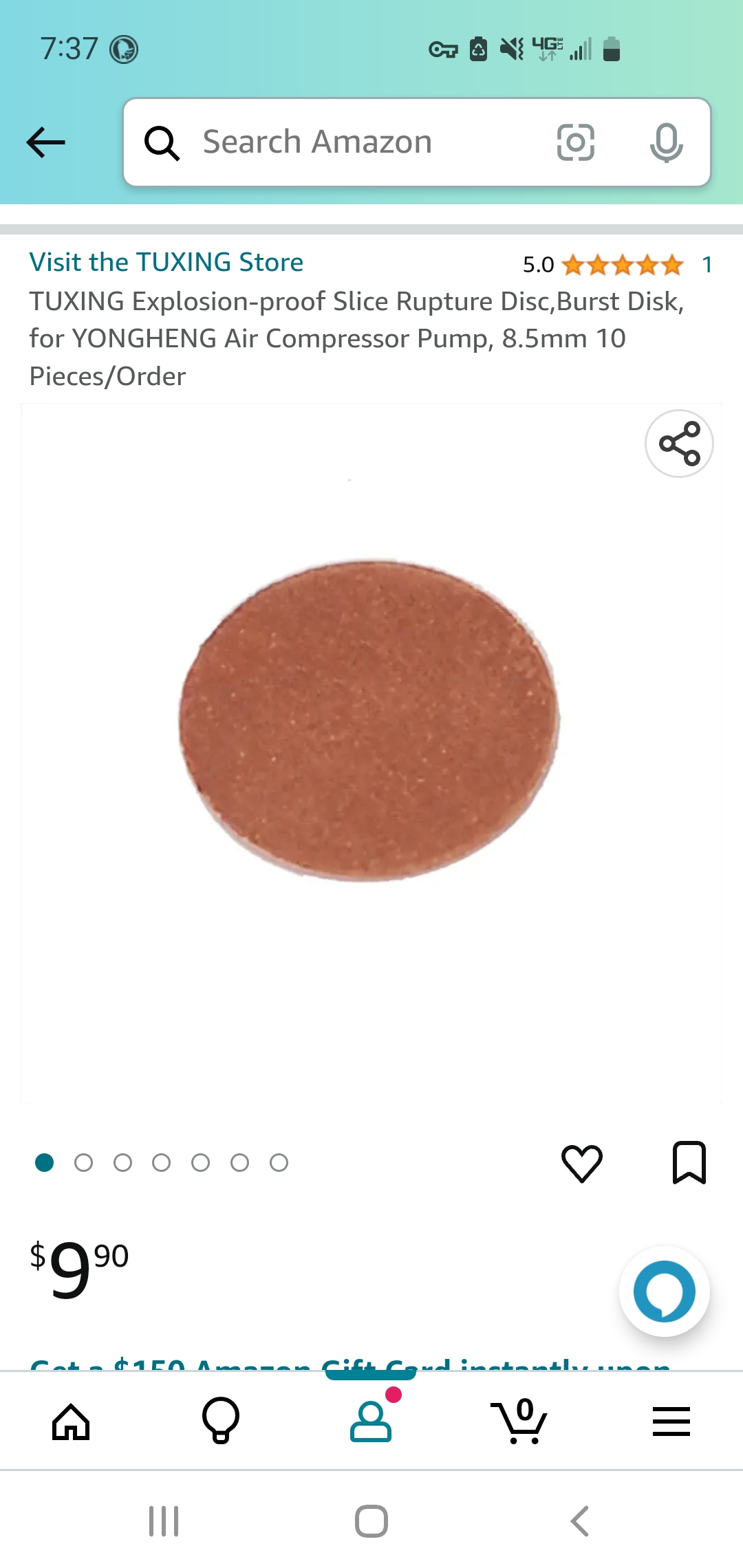

To anyone looking for cheaper burst disk for air filter or air venturi 4500psi compressor check these out. Worked perfect and got 20 on the package. Two weeks to get but worth it. 8.5mm fit in yong heng as well. Most of the others listed are not large enough only 7 mm.

From a hardness perspective, are these somewhat standard? I have a Benjamin ReCharge compressor and a large air/oil filter with burst disks. I realize the diameter might be an issue but otherwise can these Tuxing disks be used?
I would say yes they are rated for 4500psi 7k burst. I used my air venturi 4500psi compressor yesterday and it worked perfectly.
