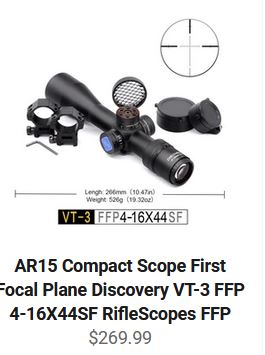

I have found the Discovery VT3 and Vector Optics Veyron 3x12x44 scopes to be just OK in this arena although you probly need to spend more, like double, to do better. Still even with these I still still use holdover most of the time as, for the price, I really don't expect them to be that durable in the arena.
I like the Veyron best but it has a very thin reticle only good at 6 or 8+ magnification. Any less and it is difficult to see. So not great for pesting up close in low light areas.
I also like the second focal plane units in each of these scopes best. So, the Discovery ends up at a 4x16x44.
https://store.discovery-optics.com/products/discovery-vt-3-4-16x44-sf-sfp-optical-compact-hunting-riflescope-second-focal-plane-sight-sniper-tactical-rifle-scope
https://store.discovery-optics.com/products/discovery-vt-3-3-12x44-ffp
https://www.opticsplanet.com/vector-optics-veyron-3-12x44mm-rifle-scope.html
https://discovery-optics.com/collections/vt-3/products/ar15-compact-scope-first-focal-plane-discovery-vt-3-ffp-4-16x44sf-short-and-light-riflescopes-ffp-for-quick-hunting
