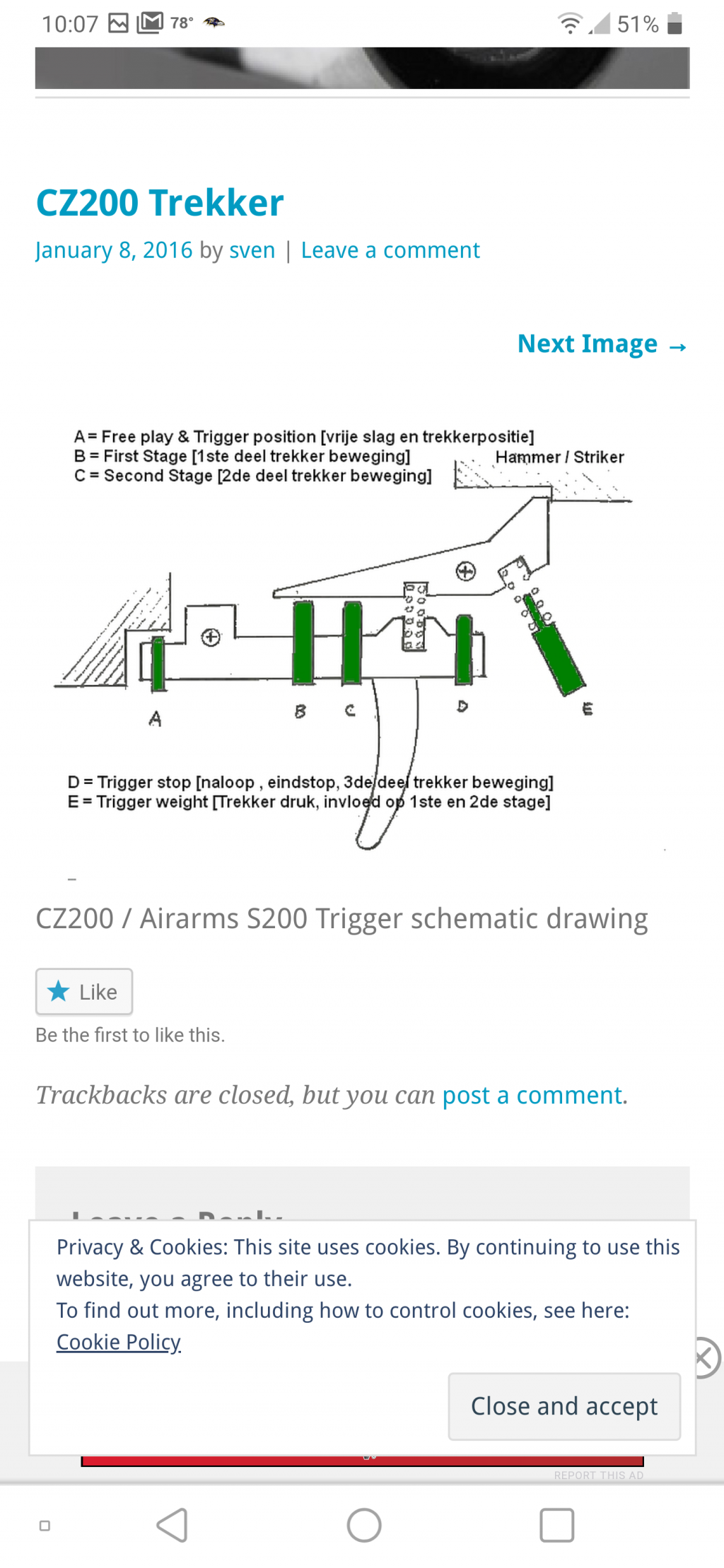

Take a look at this. Sound like sear screw need adjusting. Use this illustration and give it a try.
...all those screws...I hope something didn't fall out...I bet screw "A" fell out...
...I will be glad if that fixes it and feel like an idiot...

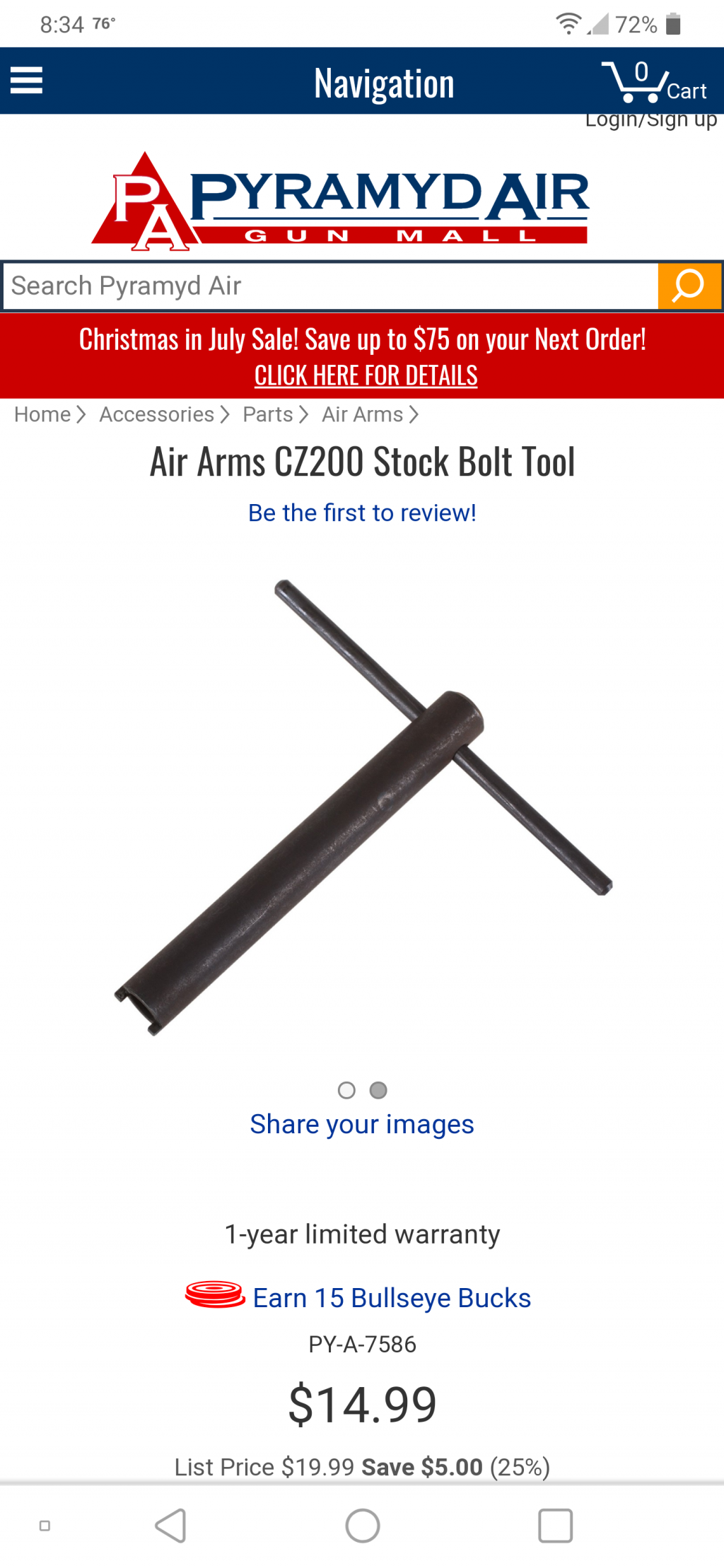

Hapo, you need to remove stock for better access to screws. You need this tool to remove stock or you can fabricate one.
