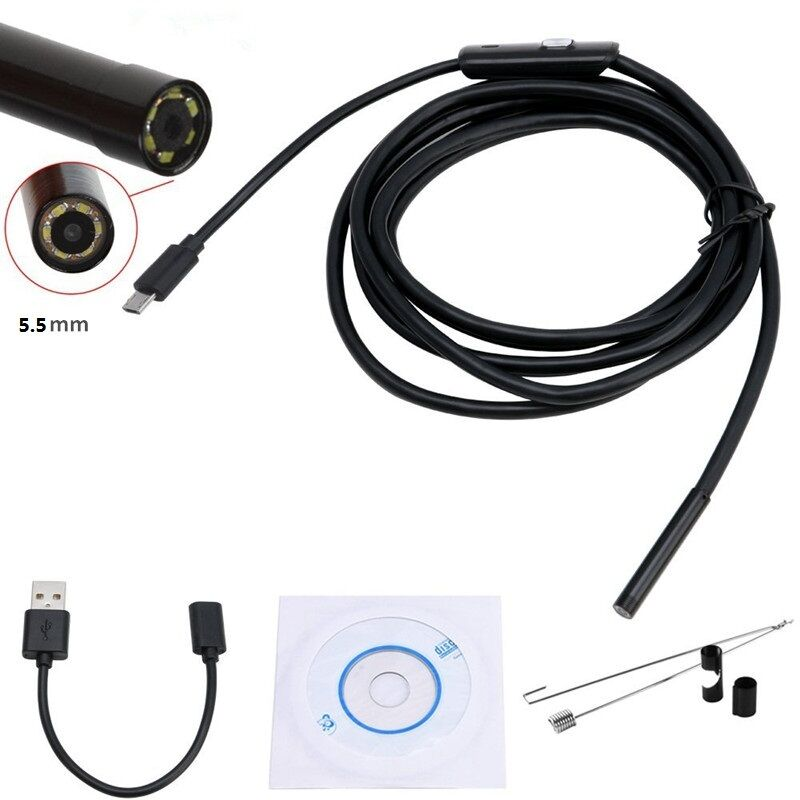

A $10 to $40 endoscope / bore inspection camera inserted from the muzzle, displaying a live video of an empty chamber on a digital display (free to $15 old Android phone) sitting next to the gun. The inspection camera would also prevent the cylinder from rotating to the next chamber. It would have to be 22 cal or larger for the cheap solution since I don't think there are any .177 bore inspection cameras available in that price range.
You can get 5.5mm endoscopes like this for $12 on Ebay.

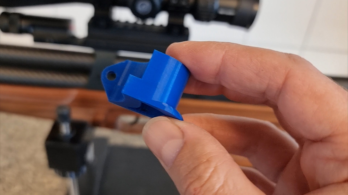

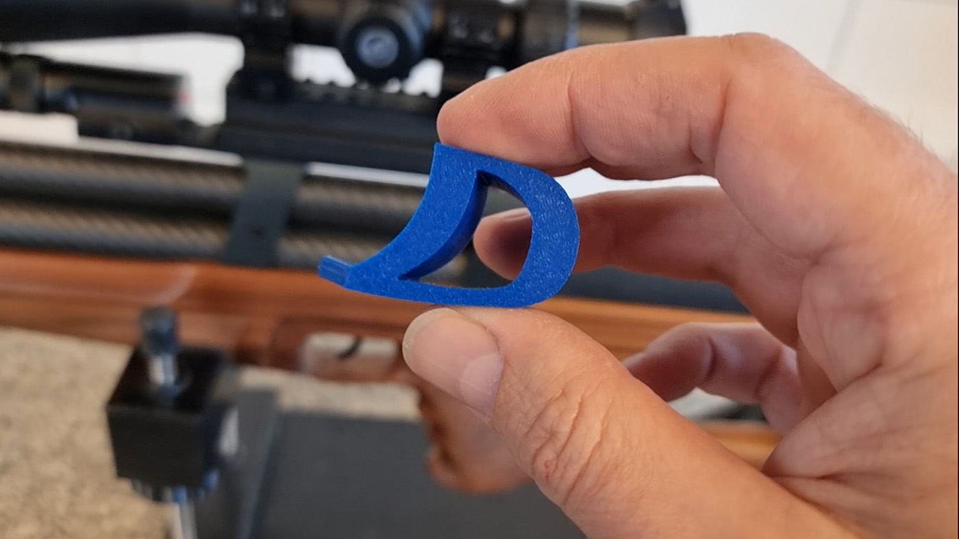

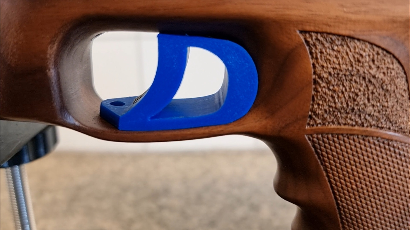

I received an e-mail from Jan Jacobsen, owner of Custom Patrs in Norway, he's developing a new part for the Huben K1, that may be just what you need. Per his e-mail:
"The cool thing about this piece is that it slips easily behind the trigger and will not allow anyone to pull it when the gun is otherwise ready to fire.
The little loop lines up with the the adjustment hole for the trigger so a little padlock can secure it even further. When you are ready to fire, you simply pop it out with your index finger.
I will be making this out of TPU, a very tough semi-soft rubber like material that is virtually indestructible that will not scratch the stock. Blue, red or fluorescent green colors are possible.
I am finalizing the design now to fit nicely to all stock versions."
It should be listed on his website soon: https://customparts.work/
