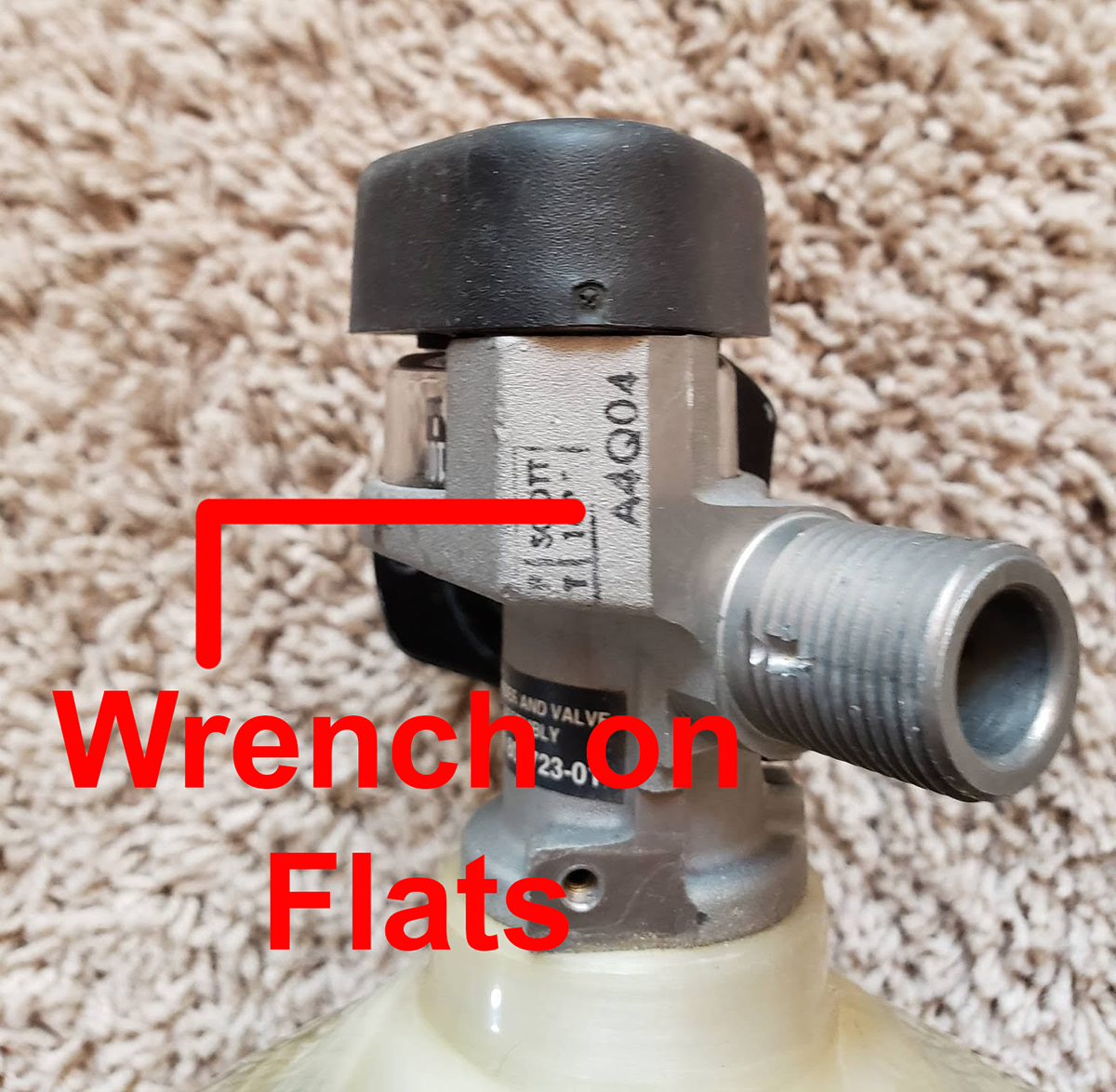

EDIT: Using a wrench on the flats indicated in the photo below and striking the end of the wrench with a dead blow hammer as suggested by others in the thread below worked very well and is what I would recommend. Remove the hanging bracket first to make the flats accessible. Obviously, make sure the tank is completely depressurized before removing the valve by slowly opening the valve until nothing more comes out.

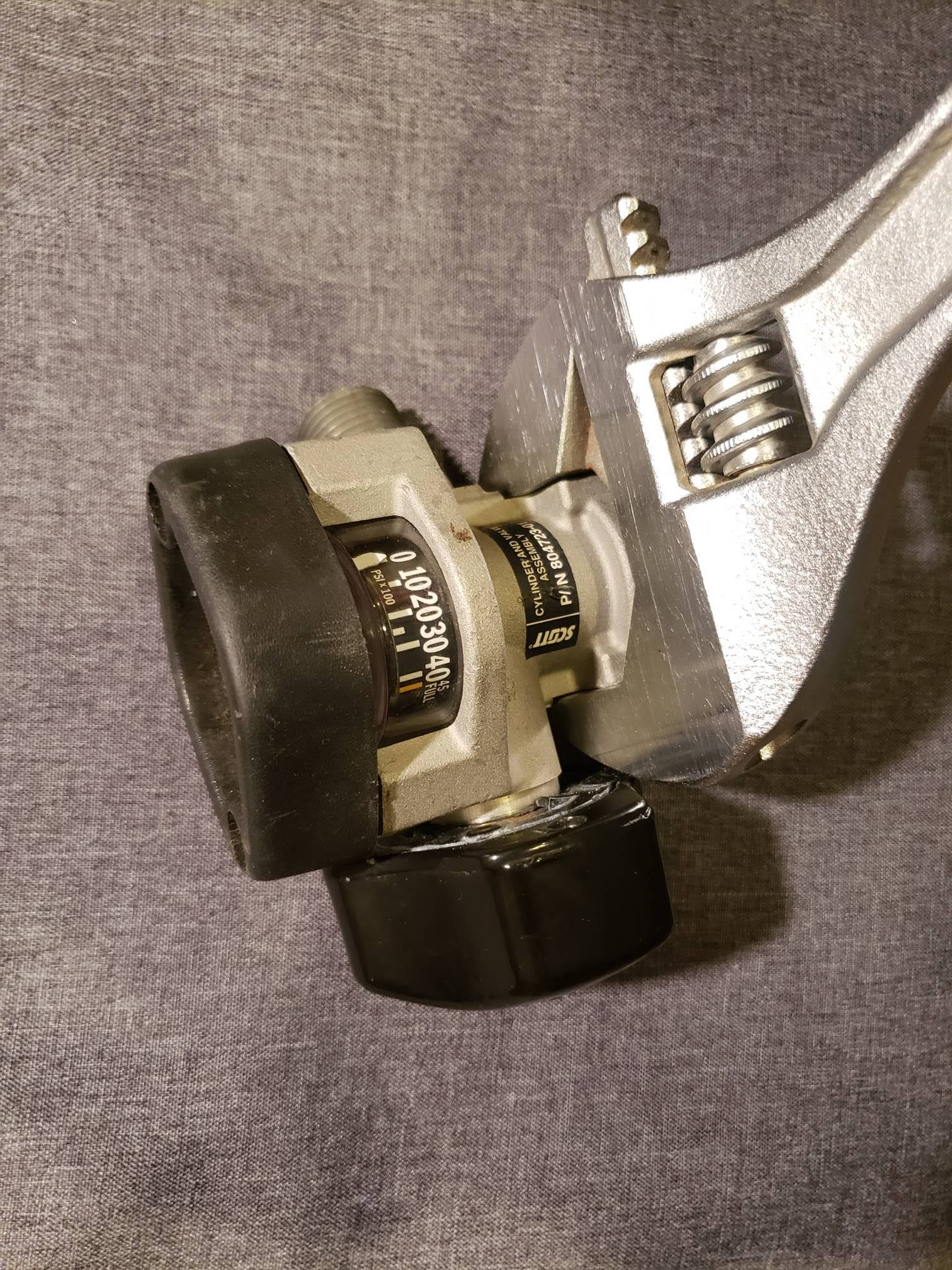

Before I fill it, I would like to inspect the inside of the tank with my USB inspection camera, but the valve assembly doesn't have what looks like wrench flats intended for removal. The best place I can see to place a big wrench is on the two flat bars on either side of the gauge. They are solid metal with just a tiny hole drilled in each one to hold the plastic protective cap in place. If my wide reach Monkey Wrench won't fit the flats, I might put the valve in my vise and turn the tank with a big strap wrench.
For holding the tank and moving the wrench, some suggestions I have found are to wrap a rubber floor mat around it and secure it with ratchet straps to a solid object like a picnic table bench, 2x6 in a vise or a Workmate table. Please chime in if you have any suggestions that might help. (Edit: As noted above, I ended up just putting my knee on the tank and hitting the wrench with a plastic mallet.)
Alternative place to put a large wrench - Note: I used the location at the top of this post, not this one.

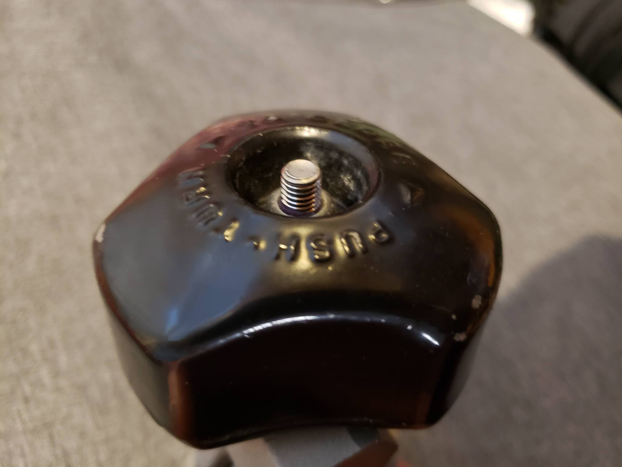

The knob has notches on it and a spring that pushes the notches against some tabs on the valve body, that prevent it from accidentally being turned off unless it is pressed in before turning. I see no need for that feature and it in fact seems like it makes adjusting the valve more difficult for PCP filling use. Some have suggested removing the spring to disable that, but on this valve I found that if I just tightened the nut holding the knob in place, the lockout would eventually be disabled with no need to take it apart and no increase in the amount of force needed to turn the knob.
Once that was done, adjustment seems very smooth and easy to control, but I won't be able to test it with air in the tank until next week when my fill station arrives.

I ended up putting a large crescent wrench on the smaller flats where the hanging bracket attaches. No need to remove the knob to get the wrench on there. The flats are 1 1/2" apart. 2 Smacks with a dead blow hammer in my right hand, holding the tank with my correct hand, and it was free. No damage to the valve body. The inside of the tank is pristine. Clean and shiny with no pitting, corrosion, scratches, cracks or any sign of water ever having been in there. Whoever owned it previously took good care of it.
I couldn't tell any difference between removing the spring under the knob or tightening down the nut until the knob turns freely in either direction, so I left the spring in there.

I pulled the spring from the valve on mine and I am very happy with how it works for filling my guns. Very easy to control. I see no down side.
After playing with the knob a bit both ways, I think there is slightly less resistance to turning with the spring removed..... I may take it out.
