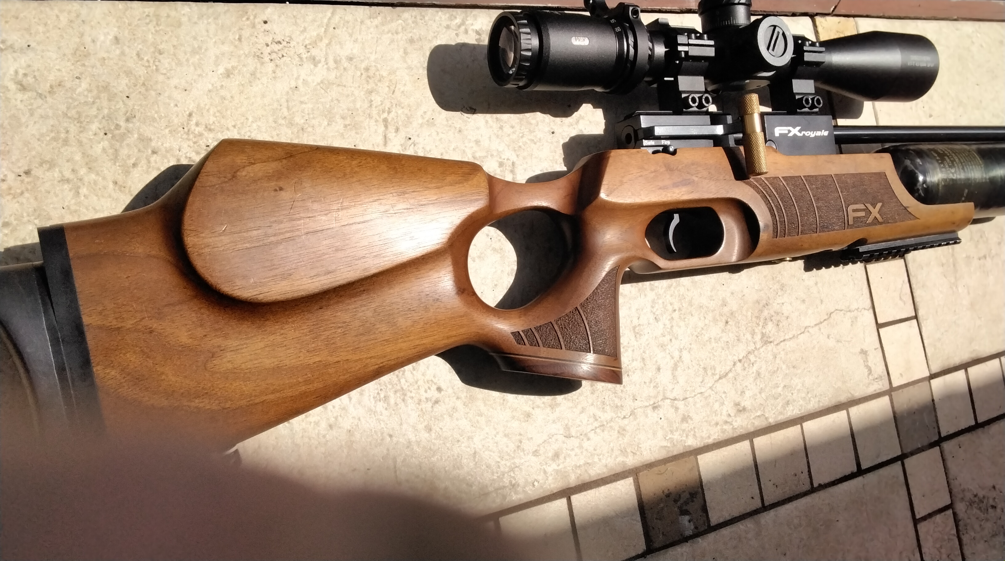

Here's a pic. This is after 6 years of hunting & tramping through the brush & hills. Probably looks fine to anyone but me.
They're only noticeable to me. If you hold it just right in the light you can see the 5 or 6 dings. That's how anal I am 🤪.

If it is just a rubbed oil finish, which many FX and other European models often use on the higher grade guns, and not a satin urethane or similar hard finishes, you can steam without problem, as long as you head the advise of just short duration iron contact. Approx 10 seconds is my typical max, and repeat.
I think you might be able to make the small marks disappear, and reduce the larger ones by 50% or so.

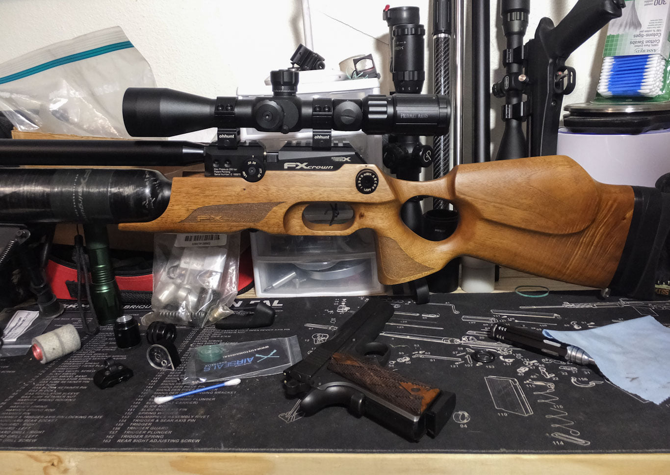

Thanks! The 1st picture is my Royale 500 (.25). 2nd picture is someone else's gun (FX Crown). My stock has a bit more intricate design around the stippling & prefer it more than the Crown's stock. The Royale, for me, is beautiful in form and, especially, FUNCTION. It's Smoothness, accuracy & feel always make it a pleasure to shoot. I'm a classic rifle styling kinda guy. I just love gun "furniture" & tactical style guns have no warmth or character to me. Had it for 7 years now & it's capabilities STILL blow me away. I think FX is making a mistake by not still actively marketing this platform. They are a dream! Nary a bad word to be said about them.
