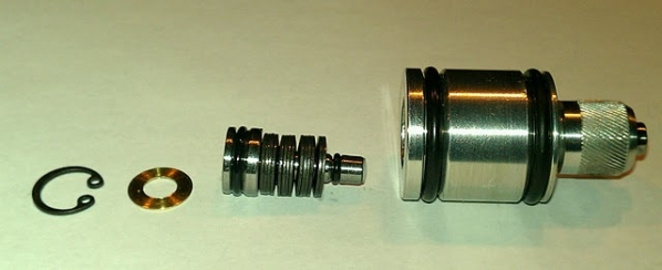

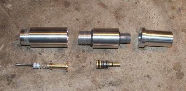

I vote disable. Unfortunately ( as I like trying all airguns) I've not seen that model but almost all regs can just be gutted and run, might be able to over shim it and leave the guts?
Now naturally ( without ever seeing rig eh) I would "think" - but it is your life- it IS engineered to take fill non-regulated psi w/out issue.
Either of these you could simply pull all the guts out of reinstall and tune away.
John
I may be misunderstanding what you mean by gutting it but if it means removing the Belleville washers, that will not work. The piston would have nothing to hold it off the valve seat, therefore it would cycle closed with a very low output pressure.
The one scenario I can think of where gutting the regulator would apply is for one with no vent hole, in which case you could remove the regulator’s internal O-rings and let input flow directly to output. Although in that case, the option to simply remove the regulator altogether is probably on the table.
The OP indicated this one has a vent so he needs the O-rings to separate the atmosphere from both the high and low sides.

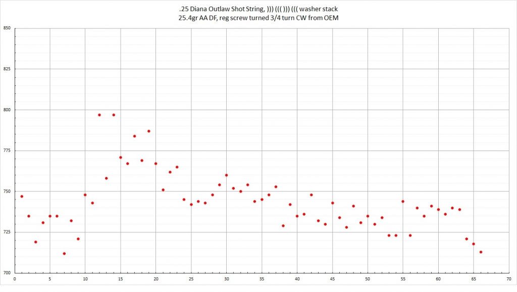

@Ray- Wondering if you've gotten your Outlaw reg figured out. I recently bought a used Outlaw and am having the same issue with inconsistency in velocities. I've rebuilt the reg several times and also explored lots of combinations of reg settings and hst settings. I also played with the washer orientations. When I got the gun, it came with the following stack: )) (((( )))) ((. This didn't make alot of sense to me, so I switched it around to be like this: ))) ((( ))) (((. Still getting way too much variability shot-to-shot. I'm about to buy a Huma and toss this reg - I really like this gun and how simple it is to work on, just not sure what's going on with the reg. Wondering if you've had any luck figuring out the issues.
