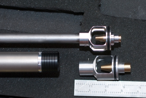

Assuming the pellet skirt is even and the barrel crown is even, and flow at exit is laminar (smooth), no upsetting forces at muzzle. But just in past the muzzle, the air can over-run the pellet (343>300) and is no longer laminar. This can cause turbulence in front of the pellet. This points out the virtues of an air stripper or something that acts as such, like an ldc.

How about I call it " muzzle flip" , see it a lot in FT rifles with very short barrel shooting full power ( 20fpe in the U.S.).
The barrel does "flip" up when fired. Now I've heard different ideas of exactly why but........ . A good quality muzzle break - with air stripping qualities also- might be exactly what your looking for.
From a Vanquish that has "blast" - air over running pellet- inside shroud pushing the pellet around after it left the barrel, this fixed it.
I think rowen sells some strippers/breals in the ULK?
