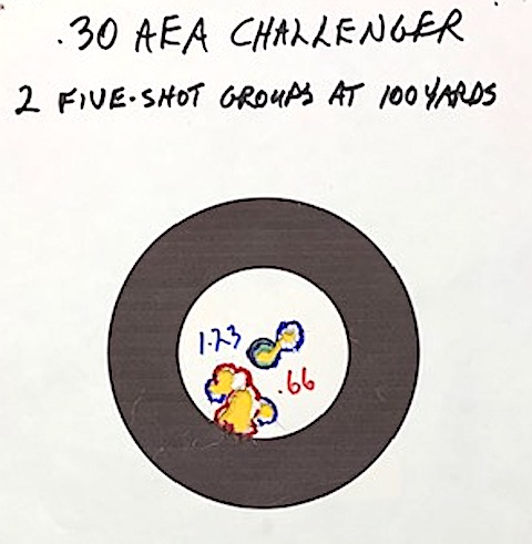

Having purchased an inexpensive unregulated .30 caliber PCP maxi-blaster about three months ago with the express purpose of turning it into a viable long-range airgun competition(s) rifle if it showed enough promise (accuracy), once it did, I set about DE-tuning the 150 foot-pound BEAST to the 80 foot-pound(ish) power level limit of one of two kinds of long-range (to 100 yards) airgun competitions I shoot (and host). Not being a machinist, rather a shade-tree "gunsmith" employing hack-saws, grinders, files, drills, and weak-mindedly obstinate resolve, each step in the three-month detuning and testing process yielded 'promising' result after promising result.
By the time I found the exact charge-pressure (120 BAR) required to return a bell-curve power-band of just six competition-worthy shots (with an extreme spread of no more than 25 FPS), The Beast was shooting as accurately at 100 yards as any airgun at any price (regulated or not). At that point, and with only six competition-worthy shots per charge being a huge handicap in competitions against the best shooters using the finest airguns on Earth, I ordered what I'd come to consider the best regulator on the market, a Huma. Huma had to custom build it for The Beast (after return of their prototype specialist from his two-week annual holiday).
That Derrick, aka- ZX10wall on this forum held my hand through the nuances of installing it in a few phone conversations is the reason the installation went completely trouble-free, and was utterly successful! The beautiful beast now not only returns 24 impressively-regulated shots per 280 BAR fill, but combined with my variation on the "B-Staley tune" (o-ring between the hammer and valve) does so at 24 FPS faster velocity than pre-regulation. As taken from my testing notes-
44.75 grain JSB, Huma regged, HDD o-ring, 280 BAR fill, 24 shot powerband- Low= 914, Hi= 934, ES= 20, SD= 4, Average= 920 FPS/84.1 FP
Oh, and another thing. The (now-regulated) Beast averages 1.06" center-to-center five-shot groups at 100 yards... outdoors. Derrick will understand the significance and inferences of the last word in that last sentence better than any other reader.
